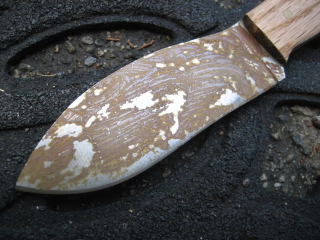

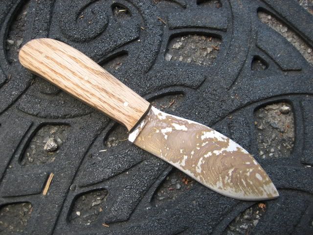

It came out like crap. When I rinsed it off this morning it was flaking off in sections. There is still a thick rough feeling to it.
bearthedog, there should be nothing flaky about a patina. I suspect you may actually be experiencing caked-on mustard. Try washing vigourously with warm water to remove any remaining paste. Then let it sit for a while, rough it up a bit (with steel wool or scotch brite), and apply another coat.

Oooh what kind a mustard was that Bear?

Looking good. I would give the surface a few gentle passes with steel wool, clean and dry it, and then reapply your mustard. The areas that appear to be the lightest or least affected are actually those where the first coat was the thickest, so you might want to apply your second coat in such a way that they receive a thin layer.
Again, looking very nice. I love the look of a decent patina on a traditional-style knife.

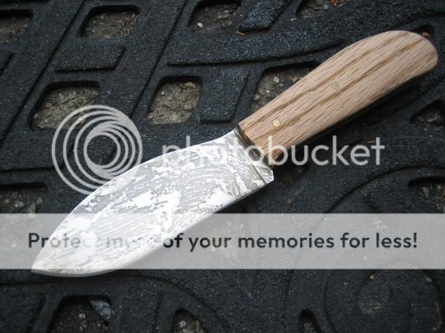

Or you could make sure it's good and clean and degreased and cut some veggies with it to fill in spaces? mangoes do a good job, I'm finding out

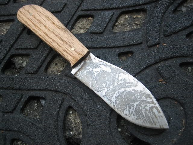

Good advice I think I will add a thin coat of mustard.
I am not much of a veggie eater, but when I am playing with knives, I must. I will be cutting up lemons later. I was planning on using much thinner knives but I guess one couldn't hurt.
Damn it now it looks great, I guess you want to keep it ha.
Looks that way Tony but you never know, you could always borrow it!
That came out nice. Mustard definitely leaves a distinct pattern, looks almost like damascus.
