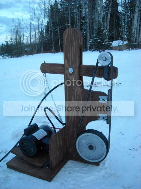

Opps, I posted the first pic before I was ready.

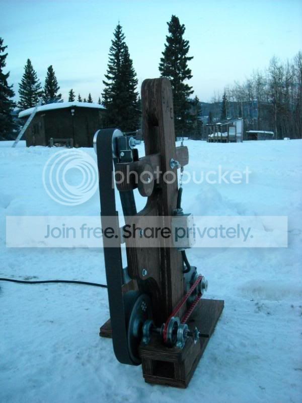

I built a two wheel 2x72 to replace the 1/3hp Craftsman 2x42. Now I can use those legendary Blaze belts:)

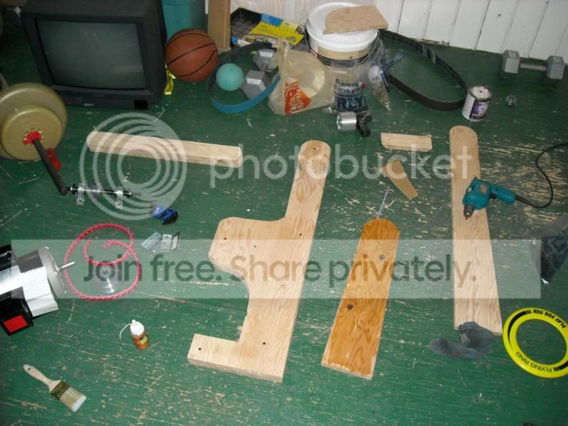

The frame is 3/4" Douglas fir plywood, laminated together with Gorilla glue and wood screws. The 10" contact wheel is from Grizzly, most of the other parts are from Knifemaker USA. The 1hp, 1725rpm motor is from Pricess Auto. I have 3-stack pulleys but will only run it two speeds - 2250fmp, and 4500fpm, the fastest speed of 9000fpm might be a bit scarey and hard on bearings.

Bruce what is the link chain with spring for ? and how does this set up allow for hollow grind ? by holding blade against lower wheel ?
roland
I like it bruce. only pay attention to the sparks. if you will grind a lot the wood can burn. you could consider put a piece of tin as a wood shield.
anyway the wooden belt grinder can become a fantastic, easy-to-build and cheap choise.
damn good job! :thumbup:
roland
I think that's for tensioning the idler wheel at the top -- note that the arm is pivoted in the center. The spring and chain pull down, the other end with the wheel pushes up on the belt.
-- Dwight
Roland - the spring is for the belt tension (as zerogee said). For hollow grinding I'll just tilt the whole unit back 15-20 degress and grind the bevels on the bottom wheel.
loneronin - good point a tin shield on the wood between the conact wheel and the motor should work.
