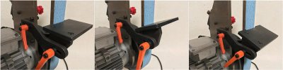

The SJ-1 belt grinder is a compact, flexible and powerful belt grinder, it’s been popular among knifemaking society in China for years, known for stability and precision.
Build with strength
The main frame is EDM cut from solid steel sheet, all bolt construction ensures sustainability, accuracy and easy maintenance.
Small but powerful
The SJ-1 belt grinder is mounted with a 1.5hp (1.1Kw) motor, the speed of the belt can go as fast as 111 feet per second (34m/s), providing enough strength for aggressive grinding.
Flexible with multiple angle
The SJ-1 belt grinder found another way to offer different grinding appliance without changing attachments. With simple rotation, you can convert between flat grind, convex grind and hollow grind. This compositive design also prevents the grinder from using too many parts that may weaken its stability.
Adjustable work rest
The vertical work rest is mounted with lever and can be adjusted with another lever.
The horizontal work rest is notched out for the wheels, can be mounted on the assistant contact wheel position and flat grind position.
Small wheel
The assistant contact wheel can be changed to alternative small wheels (0.79” and 1.18”), the angle of the belt here is lower than 33°, providing easy access to finger groove grinds.
Vertical & horizontal all in one
The SJ-1 belt grinder can be flipped by 90°, provides both vertical and horizontal features all in one.

Looks like a versatile machine, Why did you make it with a 2 x 48" belt? The bests that are the best buy per square inch here in the USA are the 2 x 72" belts and they run a little cooler as well, Just curious why you went with the 2" X 72" unless that's a miss print?
Hank,
Hi Rhino, it's not a miss print. The grinder was originally designed for Chinese market as a compact one. I understand that 2*72 would be more accepted in US and I'm thinking of developing this version, but first I'd like to see how you guys would like to say about the present one after you have some experience with it, as you know, I'm only starting this business.
OK,
2 x 48" will work but most makers that invest that much want the full variety of ceramic & and other belts that are available in 2 x 72.
I think the others on this thread will agree that a 2 x 72" is preferred on a professional knife grinder.
Darrin Sanders in a good man. I know from this and another forum and have spoken with him on the phone. I'm interested in hearing what he has to say about your machine.
Thanks for all the votes of confidence. From what I can see, 48" belts may be the only drawback to this grinder. I don't think it would be too hard for the manufacturer to increase the necessary dimension to allow it to accept 72" belts.
Go to Tru Grit and they have belts for it.
