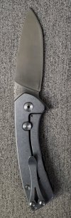

got one...not bad....not worth the 179/189 price point though. Buck really needs to reduce the map price.....
the good.....no blade play in any direction. smooth flipping action. locks up tight. good size, ergos are good.
the not so good.....see lock picture..interesting design all the way engaged and ground to have a stop edge to not allow travel to frame. not sure how that will hold up over time, but we shall see. the stop pin setup....ehhh. not liking it. the pin is in the blade. so steel frame stops on one side. g10 stops on the other. it works and is strong enough due to the one steel side....but I'd prefer a nested steel liner on the other side.
edge was ground a bit wonky..seems lately Buck has a wonky edge trend going on.
so I like it......but if it was 120 bucks I expect traction would take off harder. maybe even 135 range...at the 179 plus it's just too high for what's out there.
