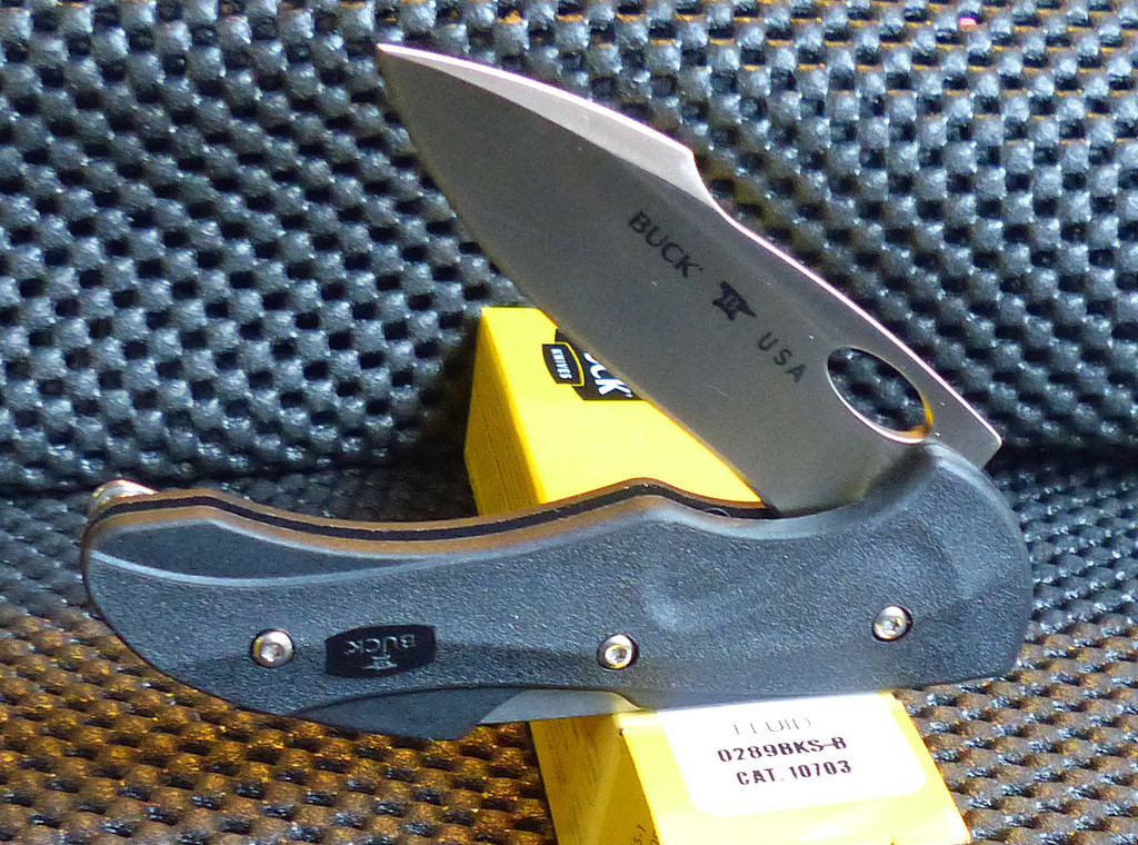

There is a tiny recurve to the blade on the Fluid that I try to show here. It gives a trap, two bellies for push and pull cuts, so more cutting ability but grates the eye appeal IMHO of this traditionalist, however, I will learn to like it.

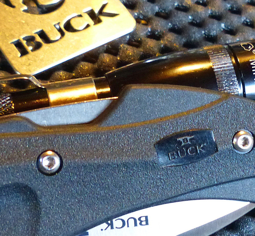

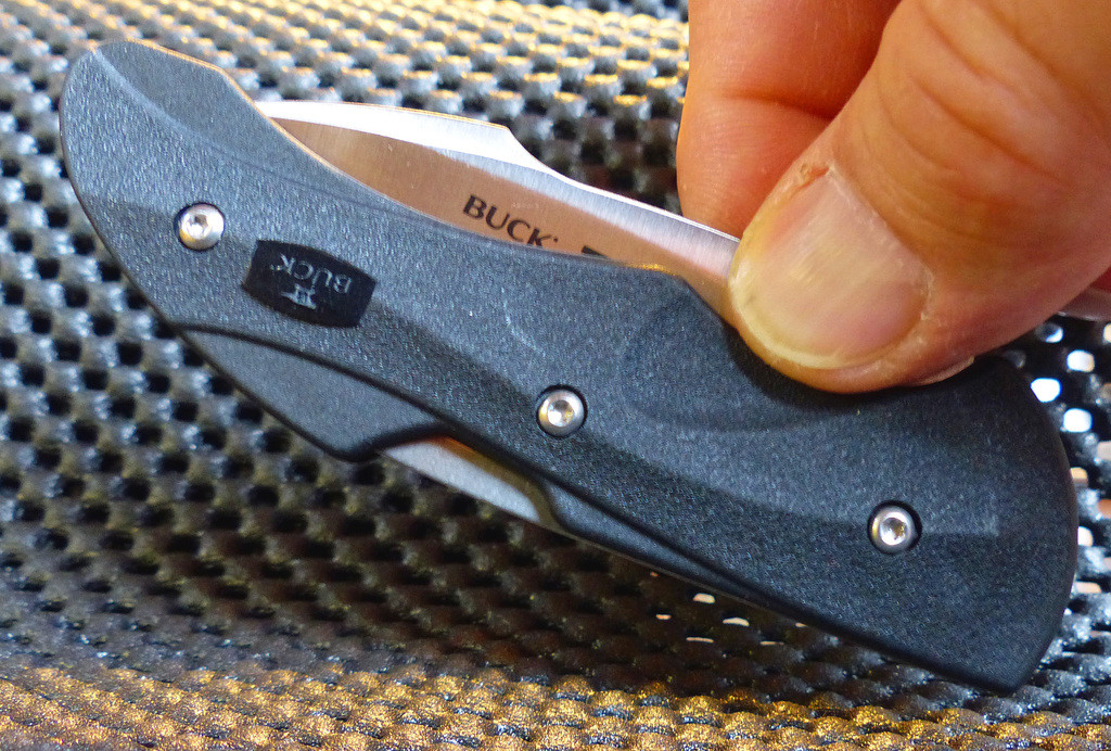

The "BUCK" badge is fairly high relief as my fingernail has no problem hanging up on it and it is just more resin. The surface of the handle gives good purchase kind of like that on the Gerber/Emerson Alliance but not as severe (the Alliance will remove skin) so I like the grippyness :thumbup::

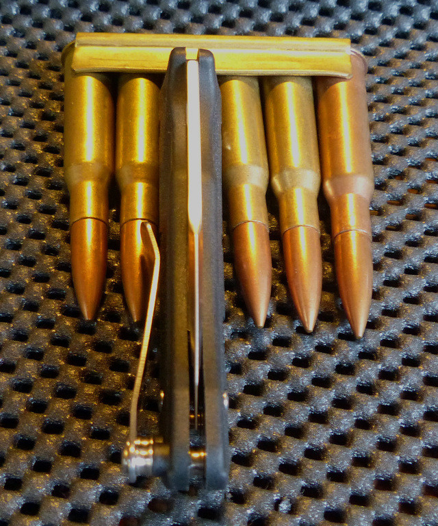

The closed blade cannot flop to the side so it looks symmetrical when closed. My sore eyes like that. Uh huh.

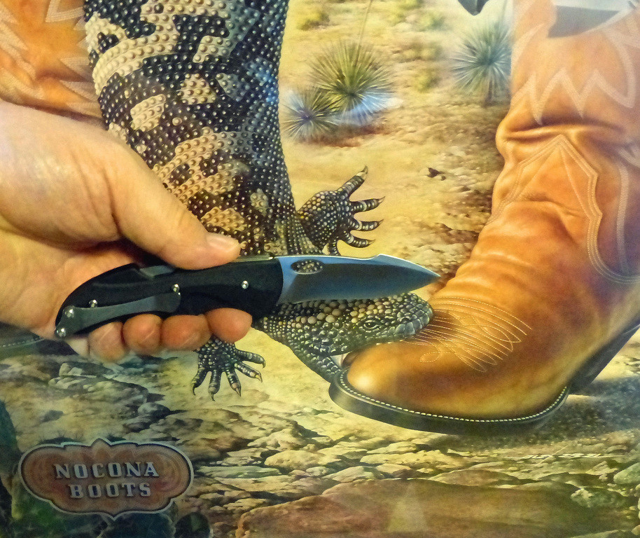

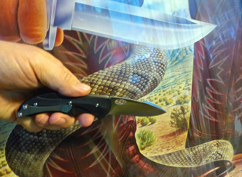

Some photos in hand (I wear XL gloves) and this knife fits my hand in the forward and reverse grips:

In the forward grip all fingers close on the handle with my thumb on the back of the blade for me (I wear XL gloves). In a death grip my palm hates the pocket clip right away.
In the reverse grip all fingers close on the handle with my thumb on the butt of the handle. In the death grip the pocket clip aids purchase and my fingers don't hate it.

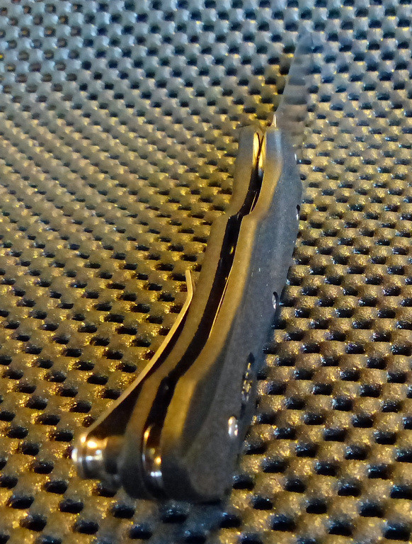

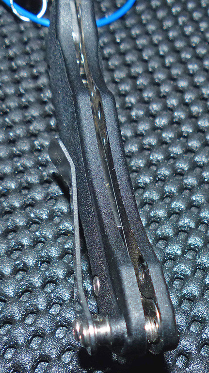

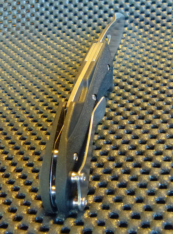

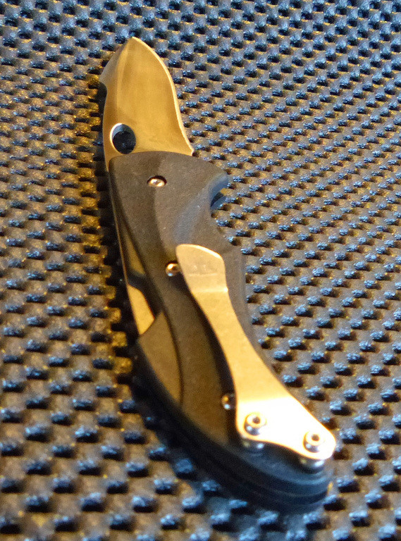

The liner is stainless steel and it is nested (imbedded, flush in the FRN handle). So it is difficult to see, mostly hidden, in such a small folder. Like the Ecolites, which you cold see because they were larger knives, nested liners. It makes them stiffer, tougher, able to take screws, and be dropped by folk who like to open their knives with two fingers for some flashy reason. You can kind of see it in a couple of photos. I take of my tri-focals, get my loupe and flashlight and peer into the open knife without cutting my nose off and I think I can see something shiny.... I have an axe so I can split this one open and take photos of the inside if you like.
Thank you for the kind words. They are very much appreciated. So often in this life. Harsh words fall like heavy Oregon rain. Big FAT drops. Well, you already know. Many thanks. You are all right. My pleasure.

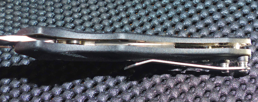

A few photos in order to show the abbreviated nested stainless steel liners, mostly hidden, inside the handle of this folding knife. Notice on the outside of the handle where the screws pierce the handle and continue thru the knife and thru the offsets. The liners are here built cleverly into the interior of the handles so that they fit flush with the FRN on both sides and run from blade end to pocket clip end. The liners are most easily visible where they almost surface very near the handle's edge on the pocket clip end of the knife:
