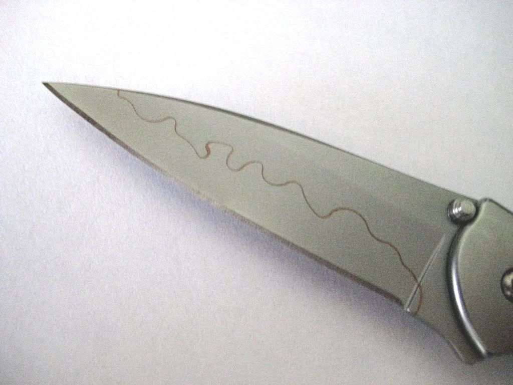

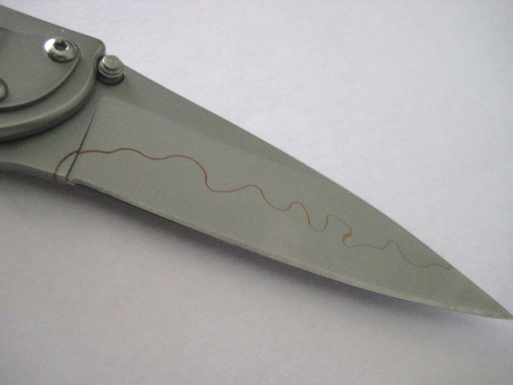

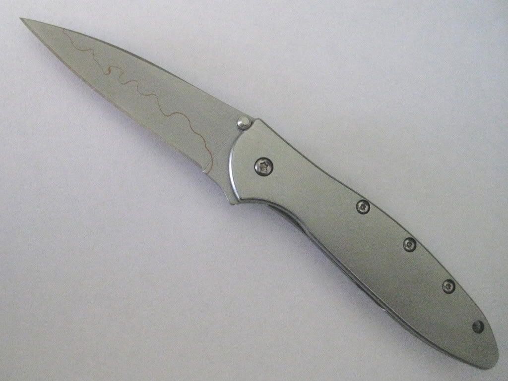

OK, here are the images of a CPM-154/13C26 combo. Thoughts compared to the CPM-D2 contrast variation?
Thomas, this is matter of how line itself looks. Try to draw simple ornaments. I think you need to talk to professional designer-artist. I think Ken Onion is the best person to talk.
Thanks, Vassili.

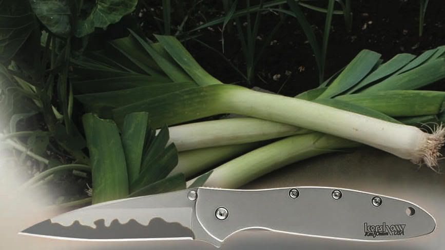

I like the very bottom pic. The others almost look, well, unfinished I guess is what I'd call it. I really like the contrast. I also noted with the Tyrade how stunning it is and the Wow factor it brings out in folks. Its all due to that contrast I think. Without the contrast I believe the reaction would likely be more like my wife's was looking at this Leek in the above pictures with no contrast, "what is that line there? Is the blade cracked?" I think a distinct pattern showing its meant to be there at the joining mark of the two steels would help distinquish it from looking 'cracked' Thomas.

You're right, Thomas, that 154/13C26 looks boring. Actually, it looks like an ordinary Leek that someone took a gold Sharpie to! The composite Leek looks great, can't wait until February to get from Jay (Jilbert). Makes me kick myself even harder for not getting the Tyrade when I was down there( at the warehouse sale) :mad:, especially since Jay doesn't have it up here @ W&W.

On my opinion this line is boring just because it was drawn this way (it looks like a crack - exactly). If you try bit harder, I think it may turn out better even copper line will only be different.
My point - I see great potential in using it as a main decoration, but it should be good artist to make it right. I can only imagine what pro can do with this.

:cool:...Vassili your examples are very nice. I do, however, agree with STR on this one. I also prefer the CPM D2/13C26 version in that bottom photo. The contrast is quite nice while not becoming garish to the point of becoming a "novelty" knife. I'll eagerly snatch one or two of these CPM D2/13C26's up when they are available. The counter-points and illustrations are great though Vassili...:thumbup:
