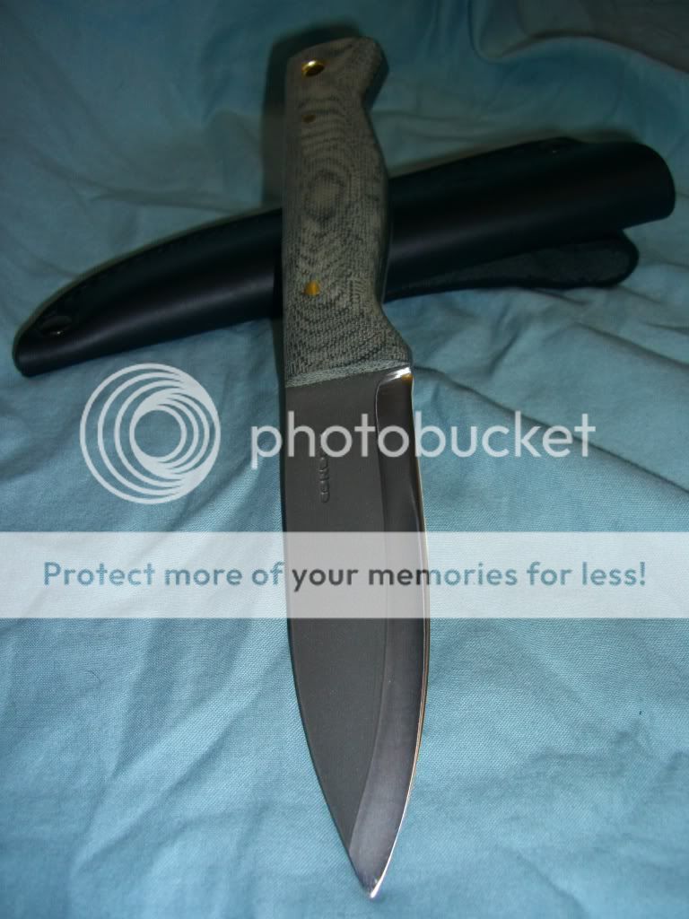

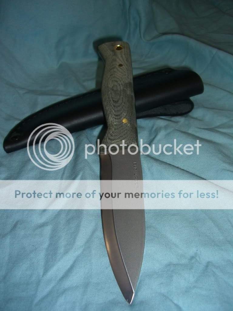

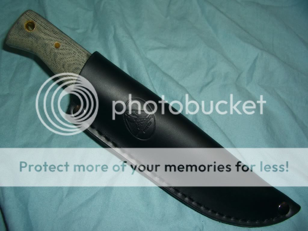

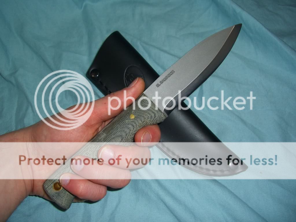

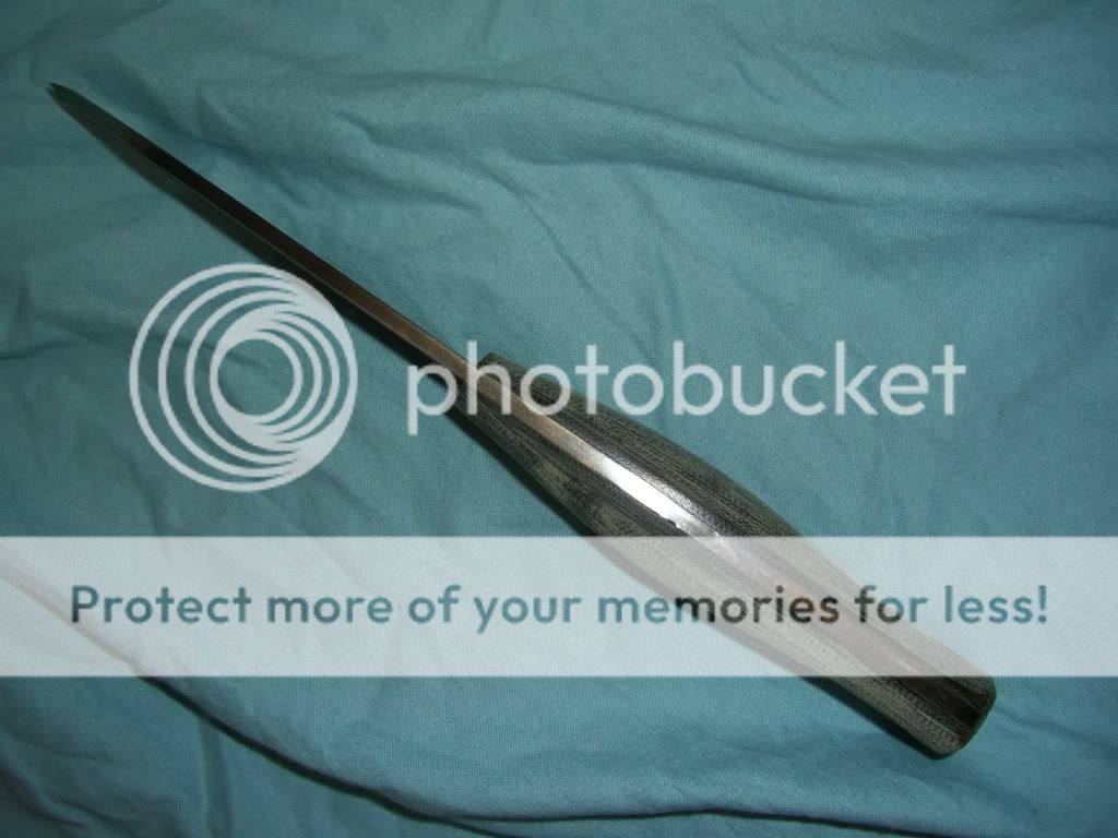

I've got some photos of that micarta Bushlore but they'll take a while to upload. Expect them tomorrow! :)
I got a reply by email back today from someone at Condor, to a question about the sheaths and they say it's the same sheath.
Pics as promised! :D:thumbup:
Thanks man, looks good and I'm liking scandis lately. I like that it is 1075, it's a good tough steel, do you know what the RC is?
RC should be in the 56-58 range, and sharpens to a screaming edge super easily.
Contrary to Joe's original intent the pieces I have a very small microbevel to them, so they aren't quite a true scandi out of the box, but it shouldn't take much elbow grease to get them there if you so desire. I'd leave it though--I've found that the thin convex on my Rodan cuts wood almost as well as a freshly-sharpened Mora and doesn't chip or roll when I beat the s*** out of it. :p:thumbup:
Doesn't it though? Feels great too. I haven't come across a knife that made me really want it in a while. I think this is one of those.
