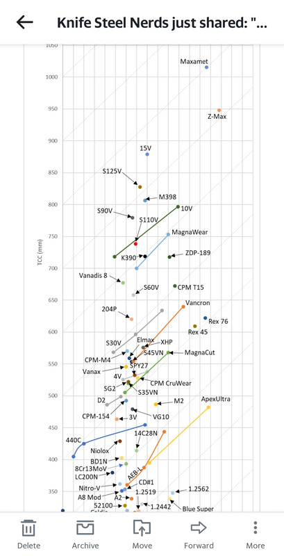

Found the hint. Larrin posted this chart with "MagnaWear" on his Patreon in January:
He also said during a Q&A that the next step with MagnaCut would be to increase or decrease the amount of vanadium. You just gotta connect the dots, man.
If that's true at all, this is going to be very exciting. I can't see the bottom of the chart but it looks like it's possibly 65 hrc capable and around k390/s90v wear. I would love to see the edge stability/wear resistance of my tool steels while never getting a tiny bit of rust. That would make an awesome everything knife. Hunting knife. Fishing knife. Boxes breakdown knife

Confirmation from Devin Thomas that it's a high wear resistance stainless steel:
I can totally understand the speculation, but the fact is that all of us, including Devin, are working with a small melt of a prototype alloy which hasn’t even had its chemistry finalized. That’s why we keep applying the word ‘prototype’ when discussing it. 😉
Also, ALL of us are still under the terms of the NDA, so divulging anything beyond that is exclusively the business of Larrin Larrin nsm nsm and the gang at Crucible Steel.
Still, I applaud your digging. It’s fun stuff!
