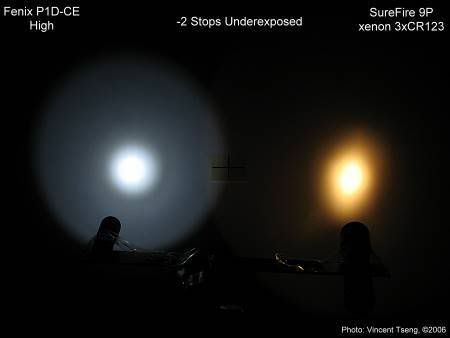

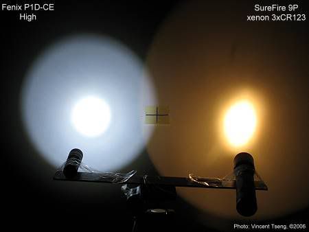

I had suggested previously that the Fenix P1D-CE on High seemed brighter than the devastating SureFire 9P xenon, 3x CR123.
Yes, I was incredulous too -
until I saw my own stairs and outdoors beamshots - especially when I removed/desaturated the colors so one could compare more directly.
Advertized light output -
SureFire 9P - 105 lumens (standard P90 module)
Fenix P1D-CE - 135 lumens High (but tested estimate was ~111 Lumens)
So I did the obvious side-by-side comparisons and included my favorite xenon/lithium - the Streamlight Scorpion -
Sizes
Heads
Beamshots -
P1D-CE High vs. SureFire 9P xenon 3xCR123A
even with the "distracting" colors - to me the P1D-CE seems brighter.....

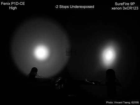

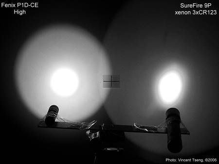

Just so that we are comparing apples to apples - I removed/desaturated the colors -
I think this may confirm it........
Reasoning - Note the SureFire 9P has a much, much wider beam side-spill and a orange-peel/stippled reflector - so its light is spread out more -
whereas the P1D-CE concentrates its light in a narrower beam so the side-spill will seem brighter.

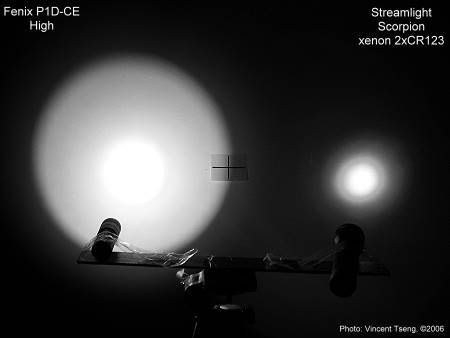

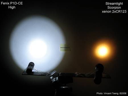

With that, one sees the Streamlight Scorpion fared much less well -
P1D-CE High vs. Streamlight Scorpion xenon 2xCR123A

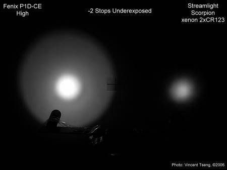

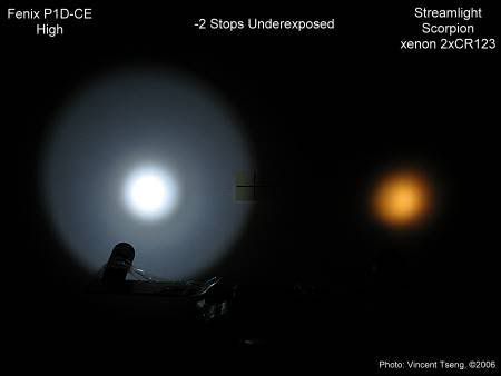

I am actually shocked by the -2 stops underexposed shot...
and I double-checked the batteries in both xenon lights to make sure they were fine, and they were......
More reasoning: the Scorpion's beam is even wider than the 9P - it also has an orange-peel/stippled reflector - so the Scorpion's lower light output is spread out even more
Just so there is no doubt - the color removed/desaturated shots -
