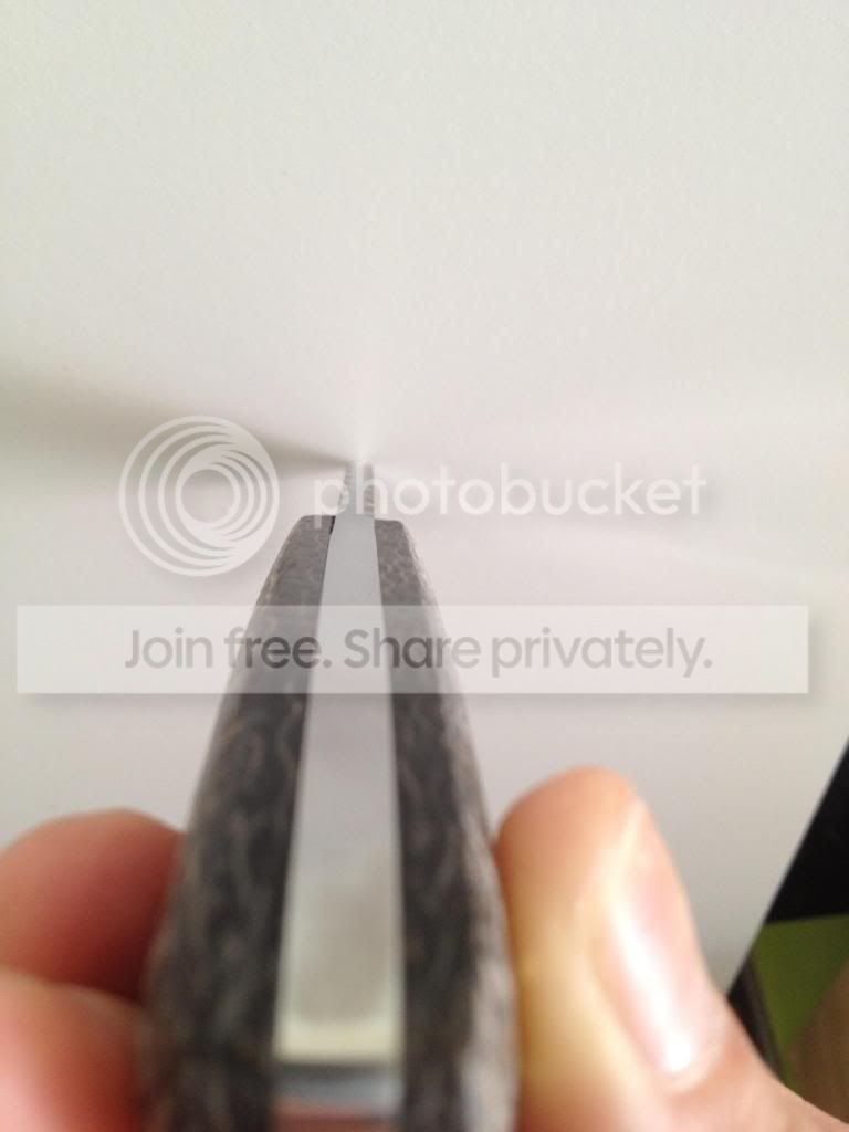

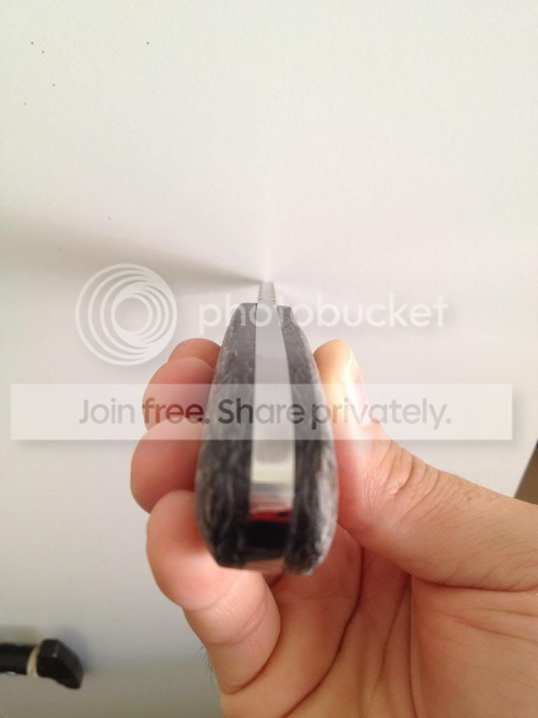

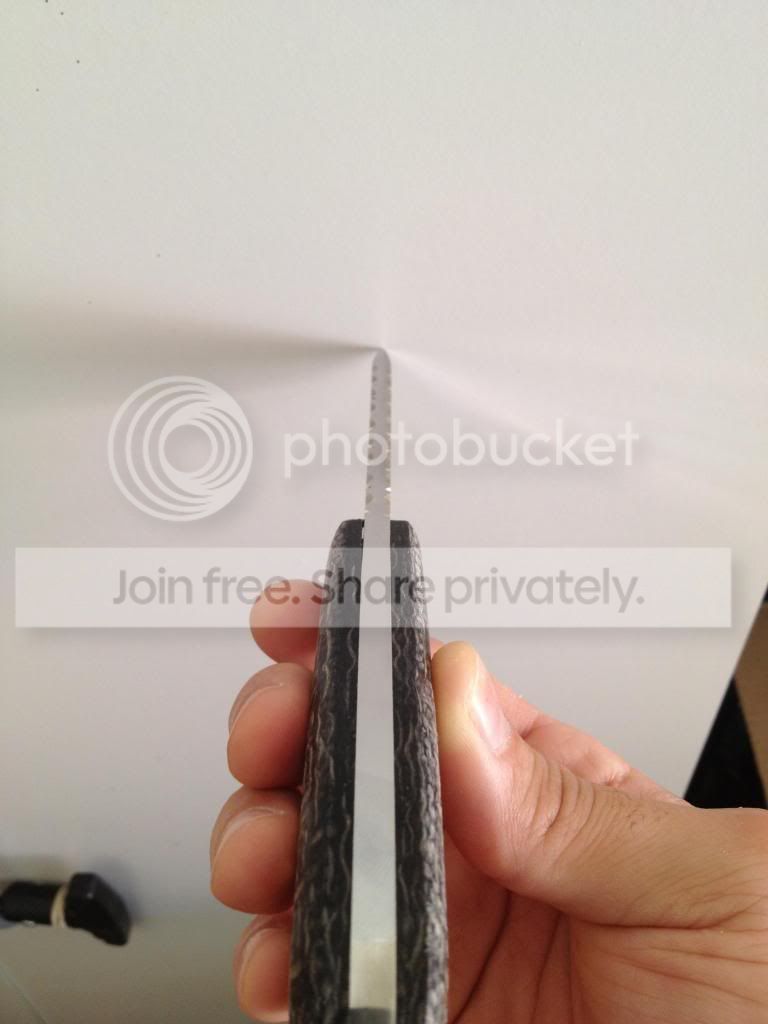

Hello guys,
I was hoping I could get some insight from some of you here regarding a new knife I had received.
It's a fixed blade about 8" overall and a 4" blade.
After opening it I looked it over and when I held it up eye level and looked down the spine from the butt end to tip I noticed that the top half (handles to tip) was slightly cocked/bent to the right.
I would say 1-2mm. Nothing major but noticeable nonetheless.
Is this a big cause for concern? I had sent an email to the maker but have yet to hear back?
If its fairly common with custom knives I guess I can live with it but if it means that it wasn't properly hear treated in one way or another I may have to send it back.
Thanks for any help.
It is very common for blades to warp during heat treat but any good maker should fix a noticeable warp before sending it out.
I would think he will contact you and make it right. I don't think most makers would want one of their knives out of their shop like that. Doesn't seem like it would help their rep. It probably just slipped by him somehow.

I also noticed that the scale on the left (near the tip) isn't flush with blade about 1/2" down. So it def. is off and my eyes aren't deceiving me.
Lets hope I get a reply soon.

You can see on top of the left scale there's a gap where it's not butting up to the blade because the blade is off to the right.
When I tried stropping the blade I could really tell it was bent to the side. I would imagine while using it for other chores I would feel it as well. As I mentioned above, I can live with it not being perfect but I'm not sure if I could keep it when I can feel that it is bent when using it.

I am not an expert but it almost looks like less of a bend than possibly a grind that is not centred. Seems like maybe the bevel drifted beeper or farther over on one side than the other. I have seen it one a couple of my own first knives. The gap in the scale, when viewed from that angle almost looks like it has a busted shoulder, like the tang is a hair thinner there than it is farther back
