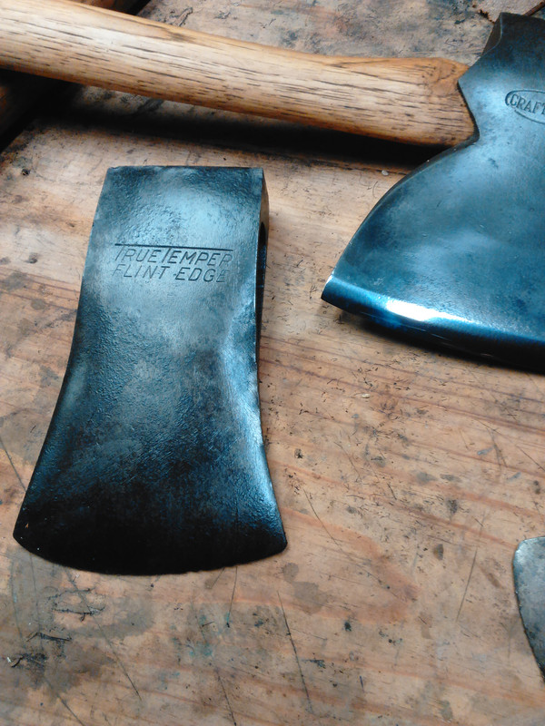

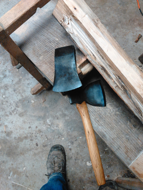

Last Friday morning while at work, I got to thinking about hanging an "unbroken line" True Temper boy's axe that I acquired on a thin straight handle. The head:
I would think from a known date Flint Edge head I have that also has the unbroken line stamp, this boy's axe head dates to the 1930's.

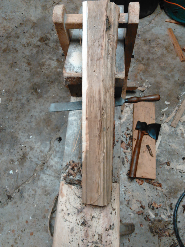

By Friday evening, it was becoming urgent that I must hang that axe over the weekend! So I went and checked the cull staves I had saved for hatchet length handles to see if one was suitable for making a 28" handle. It turned out I had a couple of prospects.
Bright and early Saturday morning, I kicked the ol' woman outa bed and told her to fix me sumthin to eat! I told her I had an important project I had to work on. The breakfast she fixed for me:

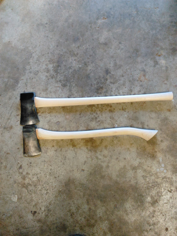

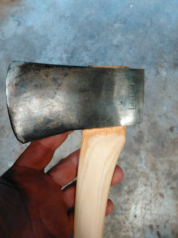

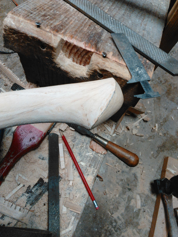

After breakfast I went to the shop and started working on the 2 staves. I ended up having a good 29" piece, and a 25" piece. I had a older 1 3/4 lb. Collins head that needed hung too, so I went on and shaped a handle for it also.

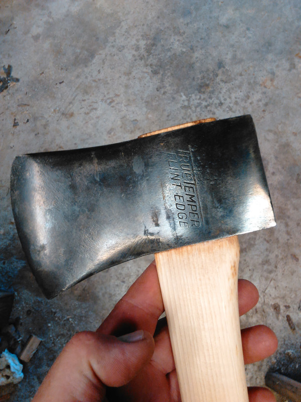

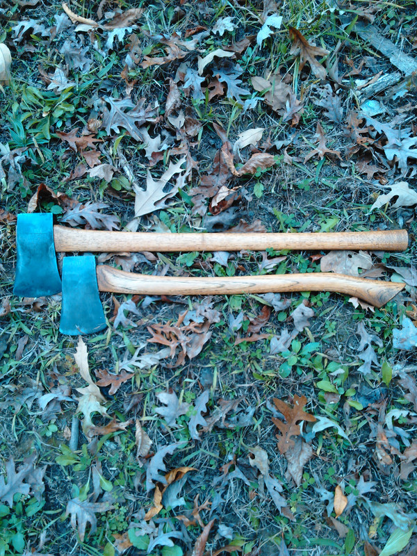

The True Temper newly hung on a 29" straight handle:
And the Collins on a 25" curved handle:

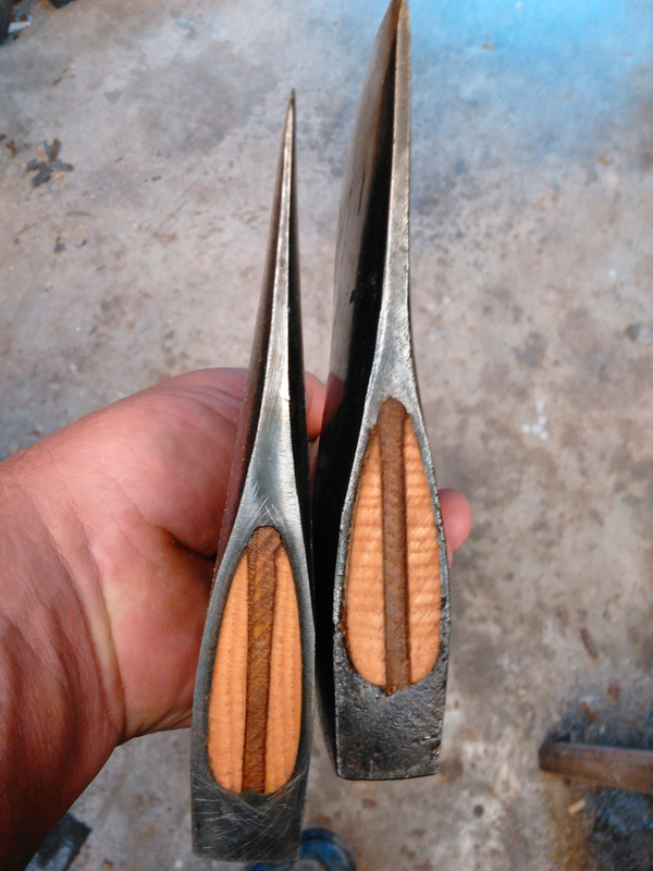

Top view, and side by side of the pair. Collins on the left, Flint Edge on the right, both wedged with sassafras:

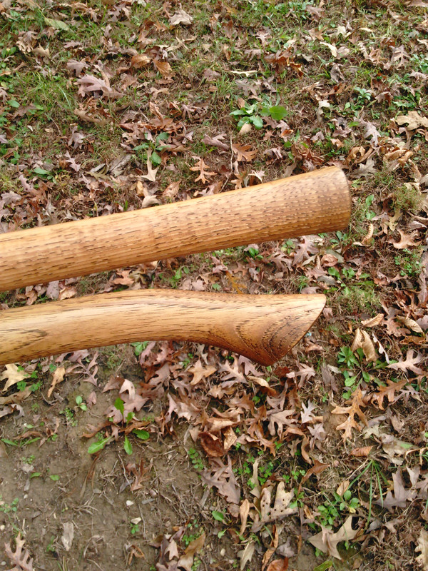

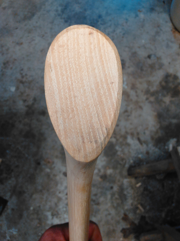

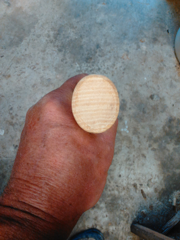

The swells:

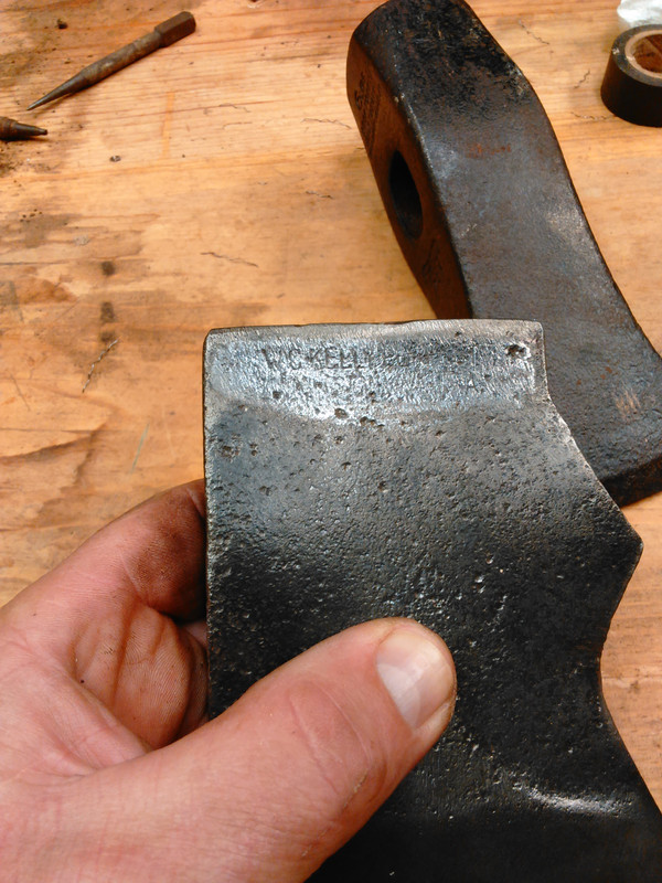

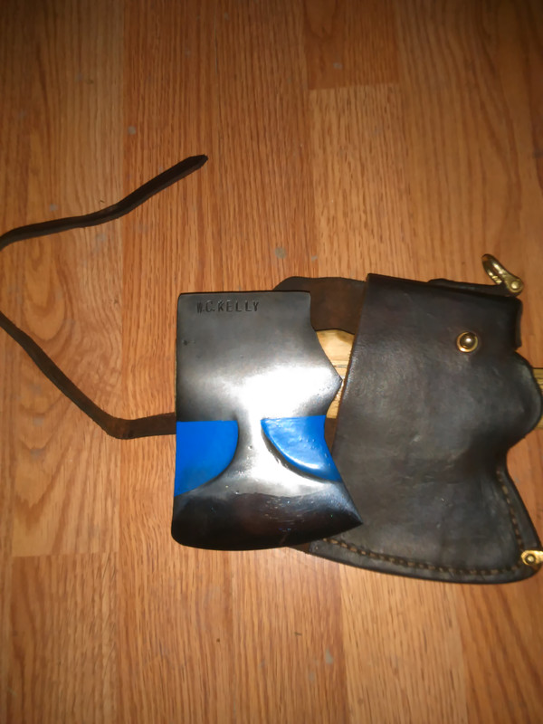

Quite by chance.. I stumbled upon my Holy Grail of axe heads! I took a few pictures along my way to giving it a new life, so I'll just let them tell most of the story.
It's kinda hard to read, but the stamp says: W.C. Kelly Perfect
Charleston WV USA.

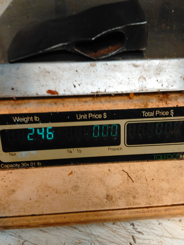

It has a 2" eye that is 3 3/4" deep from the top of the head to the bottom of the lugs, and a 4 1/4" wide bit.
And weighs just south of 2 1/2 lbs.

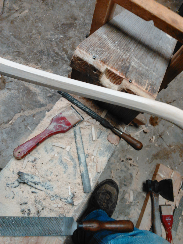

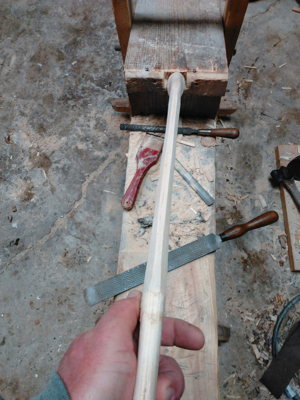

I picked through what staves I have to find one that would make a nice 28", curved, octagonal, knob end handle.
Facets transitioning into the grip.
Roughing the knob end.
Straight as a gun barrel!

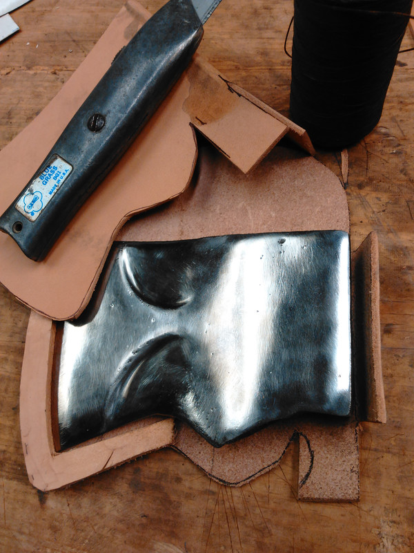

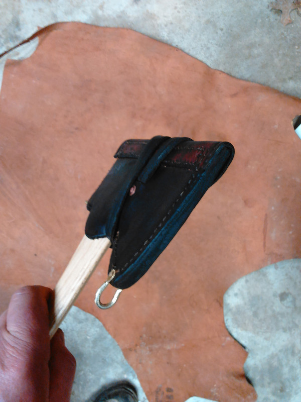

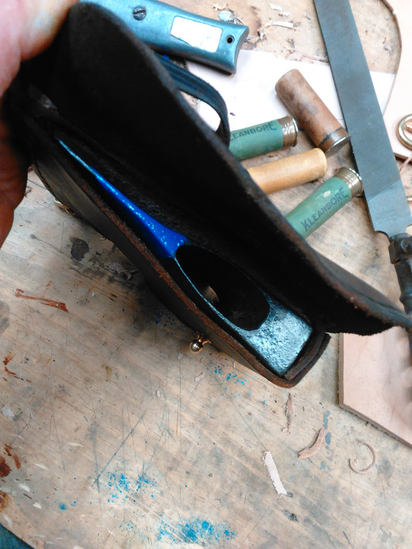

Time to fit the roughly cleaned head for the sheath with some scrap leather.

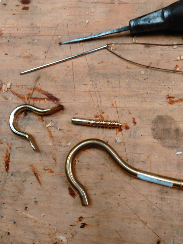

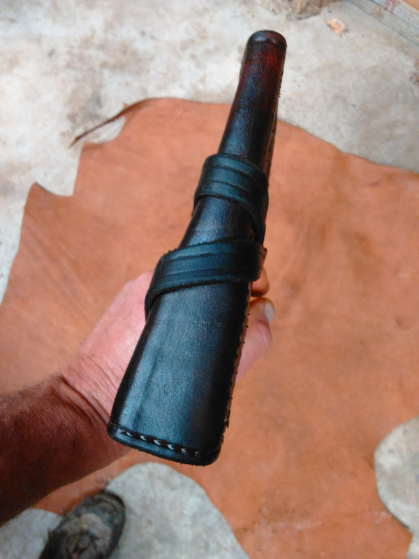

I didn't have any solid brass D rings, and neither did any of the hardware stores. So I made some.
The rings worked perfectly.
The head fits nicely in side.

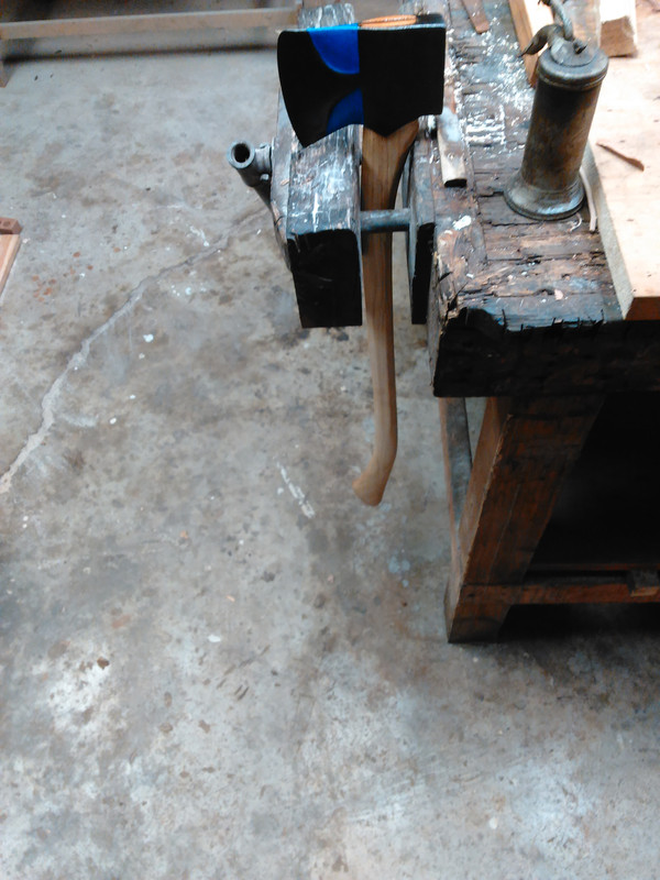

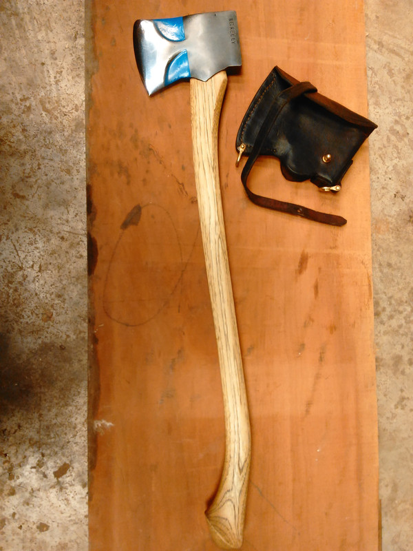

The little Jersey is hung, and the eye is soaking up some BLO turpentine mixture.

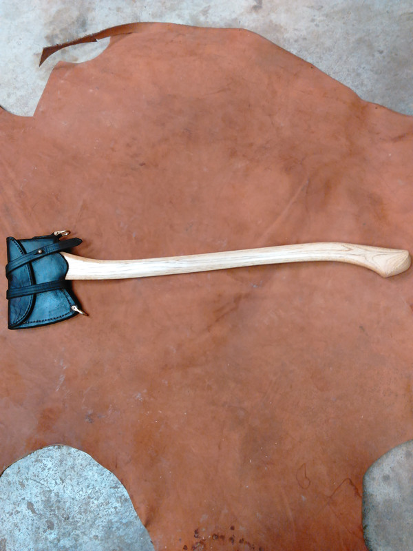

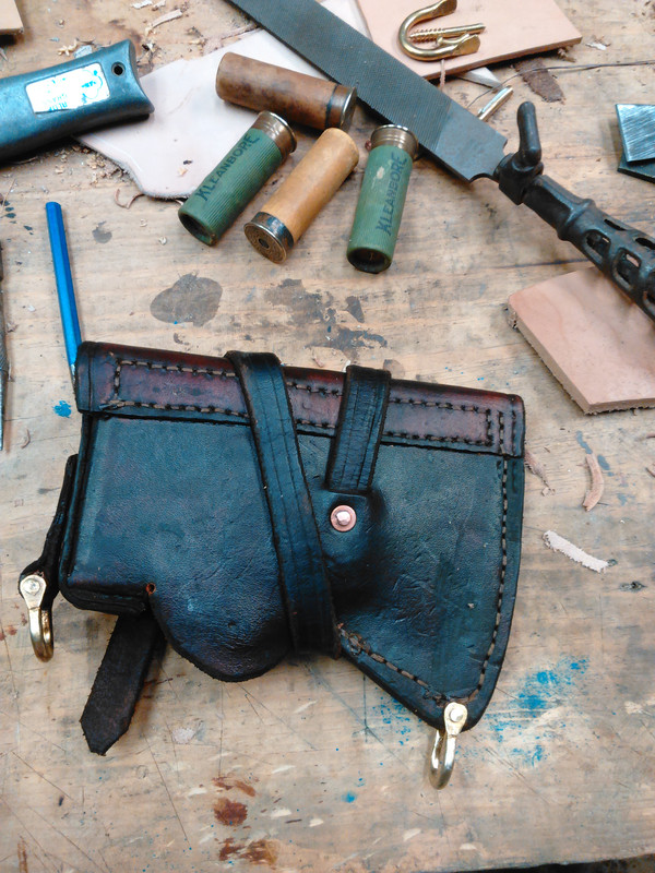

Here's the finished project.
