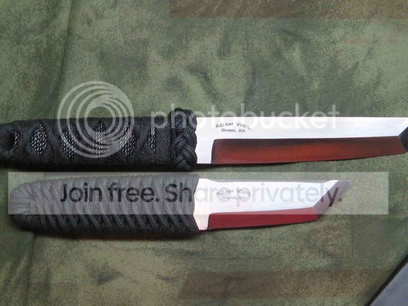

I bought one of Zaphs Etchers. I bought a stencil from Ernie and some etchent from TruGrit and these are examples of my first attempt at a makers mark
I think it is a good combination.
