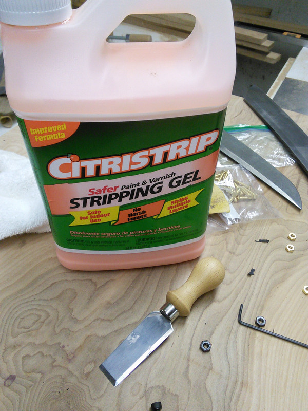

I just got a BK29 a few days ago, and, as usual, the 1st thing I did (after fondling it a few minutes) was strip the coating off of the blade. Man, that stuff was tough! I can normally have everything off of a knife in about 4 hours, but that one took me 12 hours! The only one I've seen even close to it, in terms of difficulty in removal, was the coating that Cold Steel put on a Recon Scout. Anybody else have a similar experience? Do you know if they changed their coating?
Troy
I'm curious as to how your stripping the coatings. I literally can strip a blade in 45 minutes. I mean no ill just asking. As for the coatings I did notice that my Bk5 was s little harder to get off and its coating looks like whats on my 29.
I use Citristrip. I know that there are other more agressive strippers, but I can use this stuff on the kitchen counter, it doesn't tear your hands up if you get any on you, and the kitchen smells like oranges the whole time.............;)
I could probably do it even faster with this, but I don't get in a hurry. I'll let it sit in stripper for 1-2 hours, and then scrape or wire brush off anything loose. Some knives only take the one time. If there are stubborn sections, I put it in stripper for another 1-2 hours, and just repeat as necessary.
I'm going to give that a try. The stripper from hell that I use eats thru my rubber gloves. Thanks for the info:thumbsup:
Jasco baby, Jasco. 15 minutes or less, and if I spill any of it on the grass, I never have to worry about mowing that spot again, ever:D

I can't imagine using anything better or safer than This...
Just glug it on, wait 30 mins to and hour, then lightly scrap off the coating... Super easy and smells Nice!
Did about 8 blades so far.
