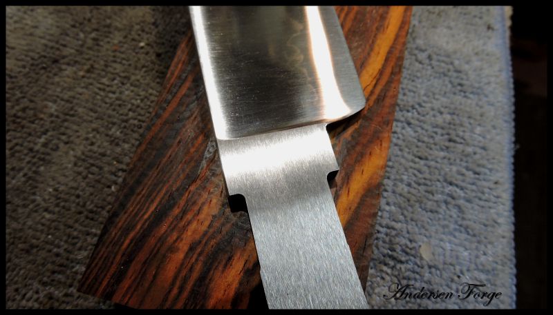

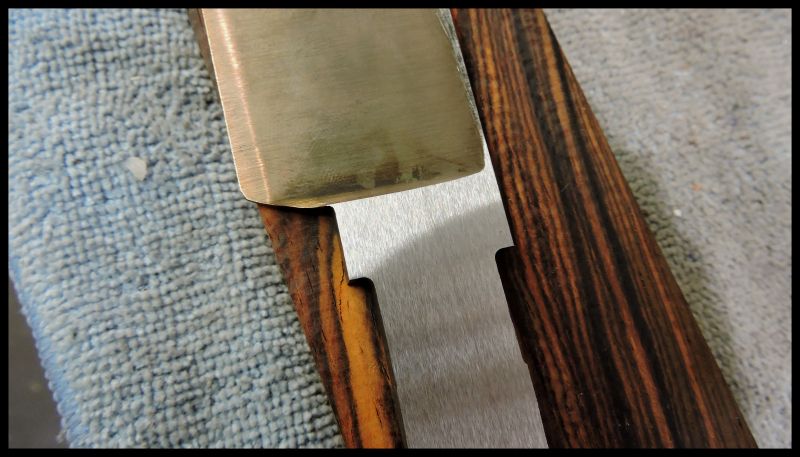

I do not do any filing in the guard slot to make it fit the knife. That's what I use my mill for.
I mill the guard shoulders on the blade and then harden and temper it.
After clean-up of the blade, I measure the thickness of the ricasso and mill the guard slot to that thickness/dimension.
Tap it on the knife/blade.
The only thing I file is a bit of radius at the top and bottom of the slot to match the guard shoulders.

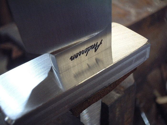

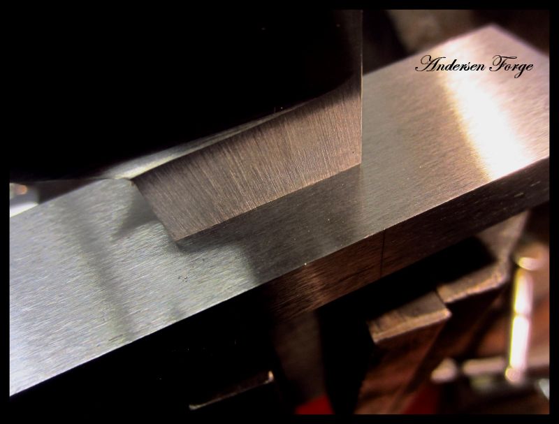

The two photos of the guard shoulders I posted up above were from a knife I am doing today. Those were taken just before lunch when I made that post.
After lunch, I slotted the guard to that thickness/dimension.

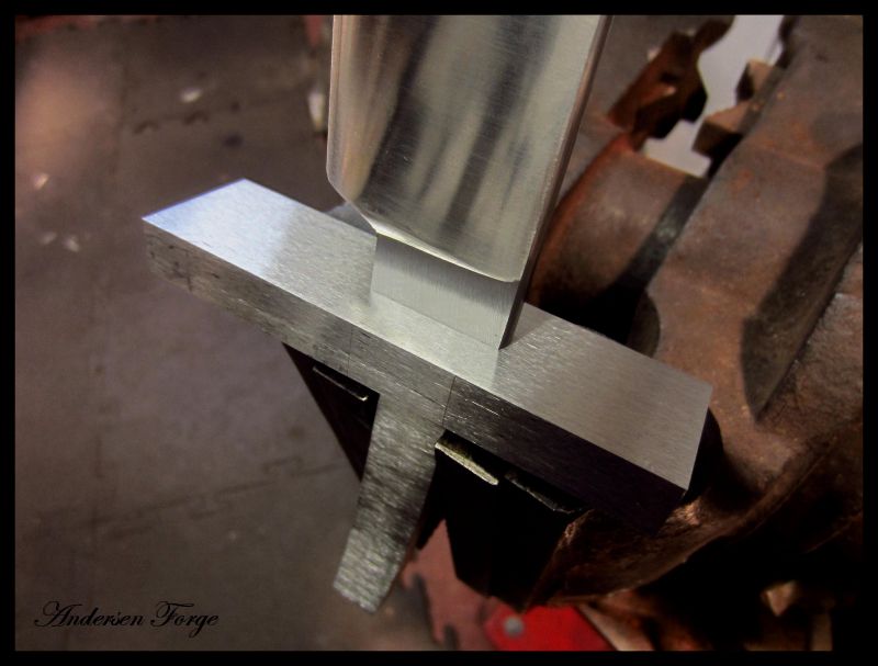

What you see below is the result.
I did absolutely zero - none - filing inside the guard slot. The only thing I filed was the small radius at the top and bottom.
The first time I slid the guard on the tang after removing it from the mill was to see where everything stood.
I thinned the tang down behind the guard .003-4" to remove it from the equation, slid the guard on and tapped it to slightly mark where the shoulder radius hit inside the guard slot ends, filed the small radius you see here, and then tapped it into place. (This is a take-down knife)
Where you see the guard here is where it is after the third time I put it on the tang.
This fit time was maybe 2 1/2 minutes after milling.

I will admit to being a bit confused when you mentioned milling a 90* guard shoulder.
If there's an end mill that can do that I'm not familiar with it.
