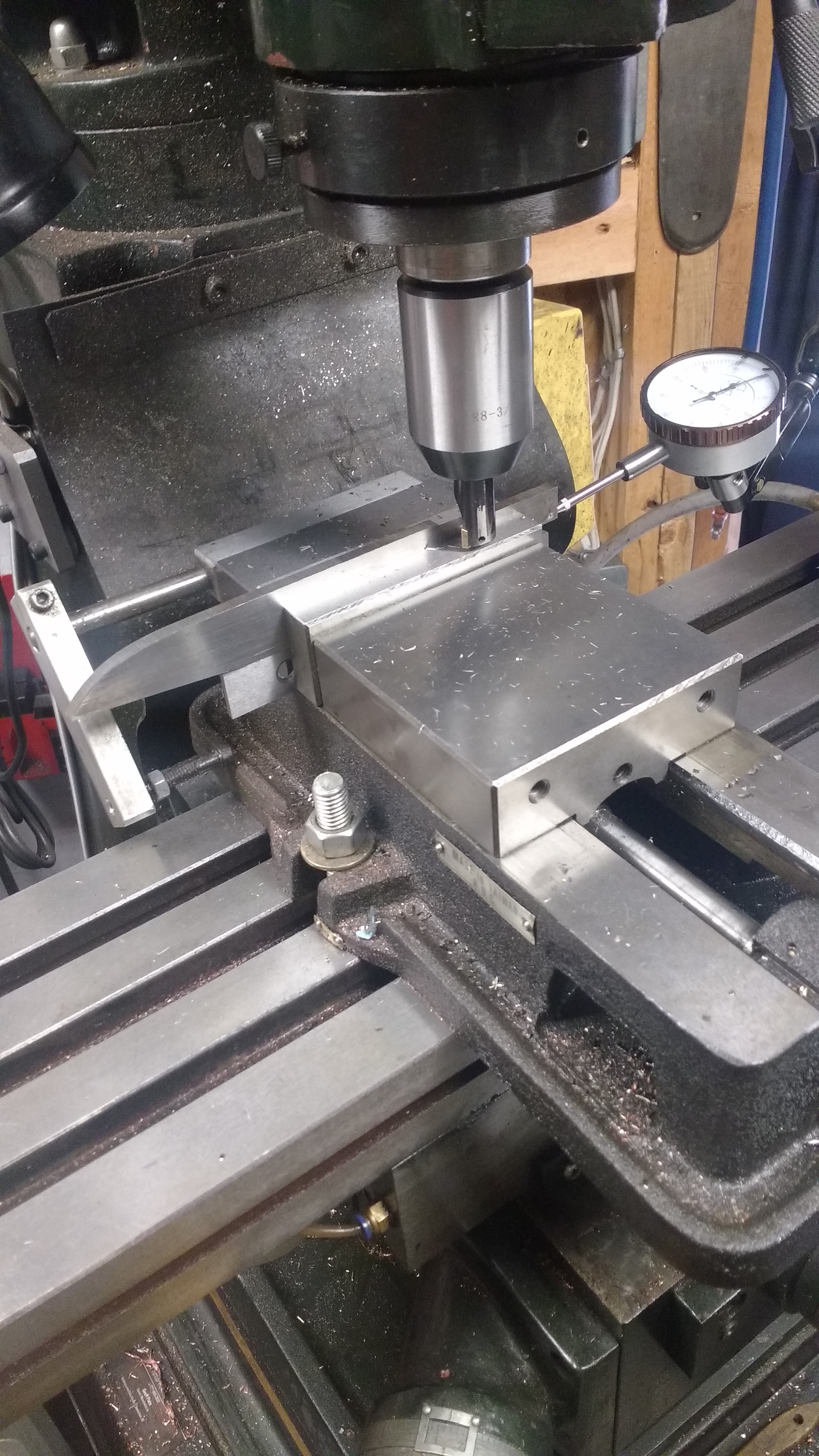

Please show me some pictures of doing it this way and how the guard fits up.That is very much the smart and easy way of doing it.
Just after doing enough obscure parts you'll figure out all sorts of creative setups.

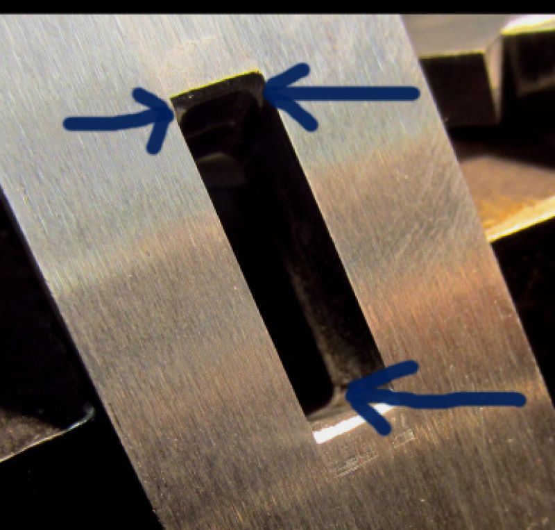

Uummmmmm inside the guard slot are 1/8" radius corners. You can see that in the top of the slot by looking in just a bit.That looks great Karl.
How did you get 90* corners for that slot on the guard without a file?
I've been milling my guard slots since the last century
One in every crowd.............By 'last century' you mean the nineteenth century, right Karl?

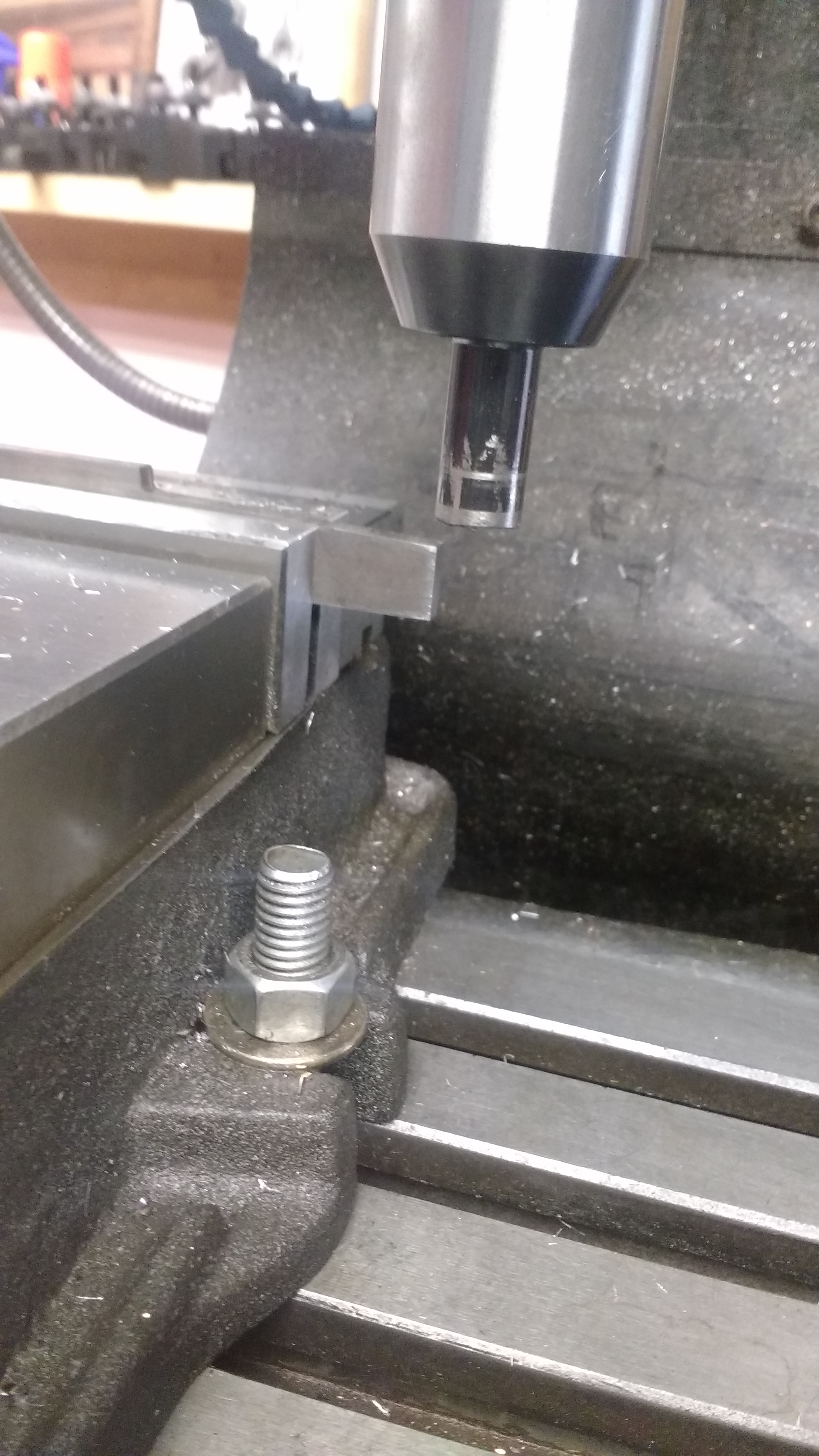

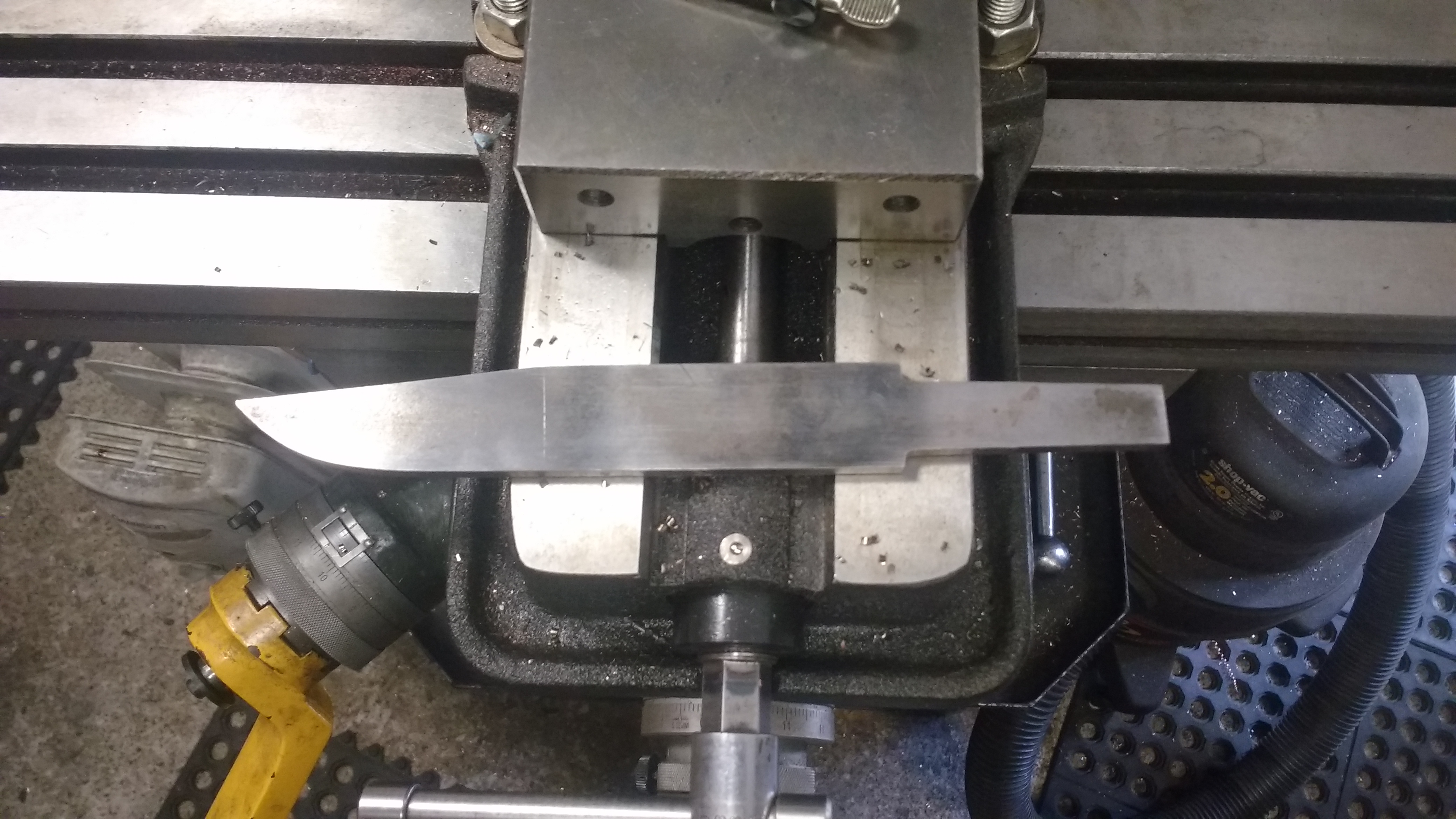

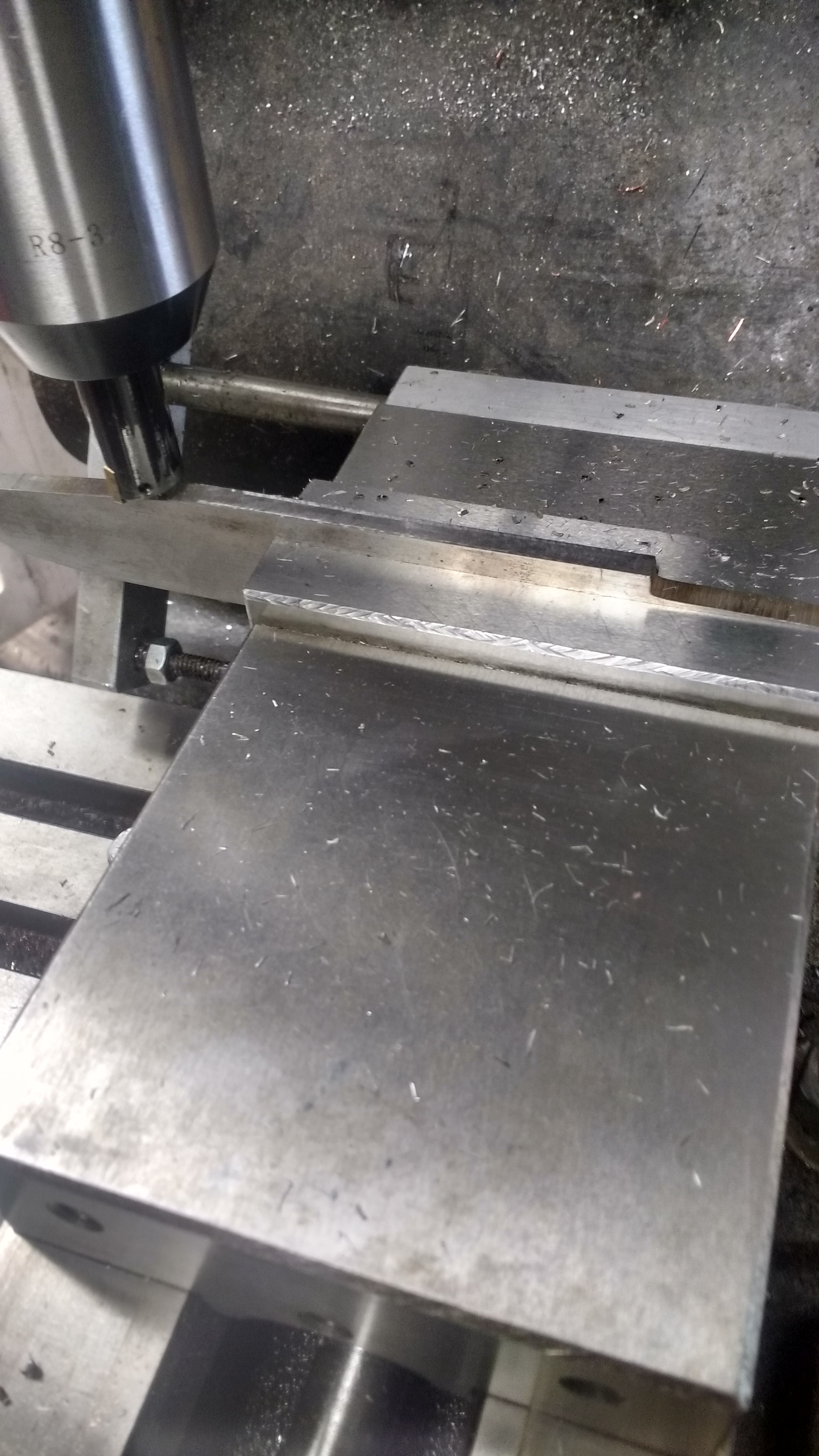

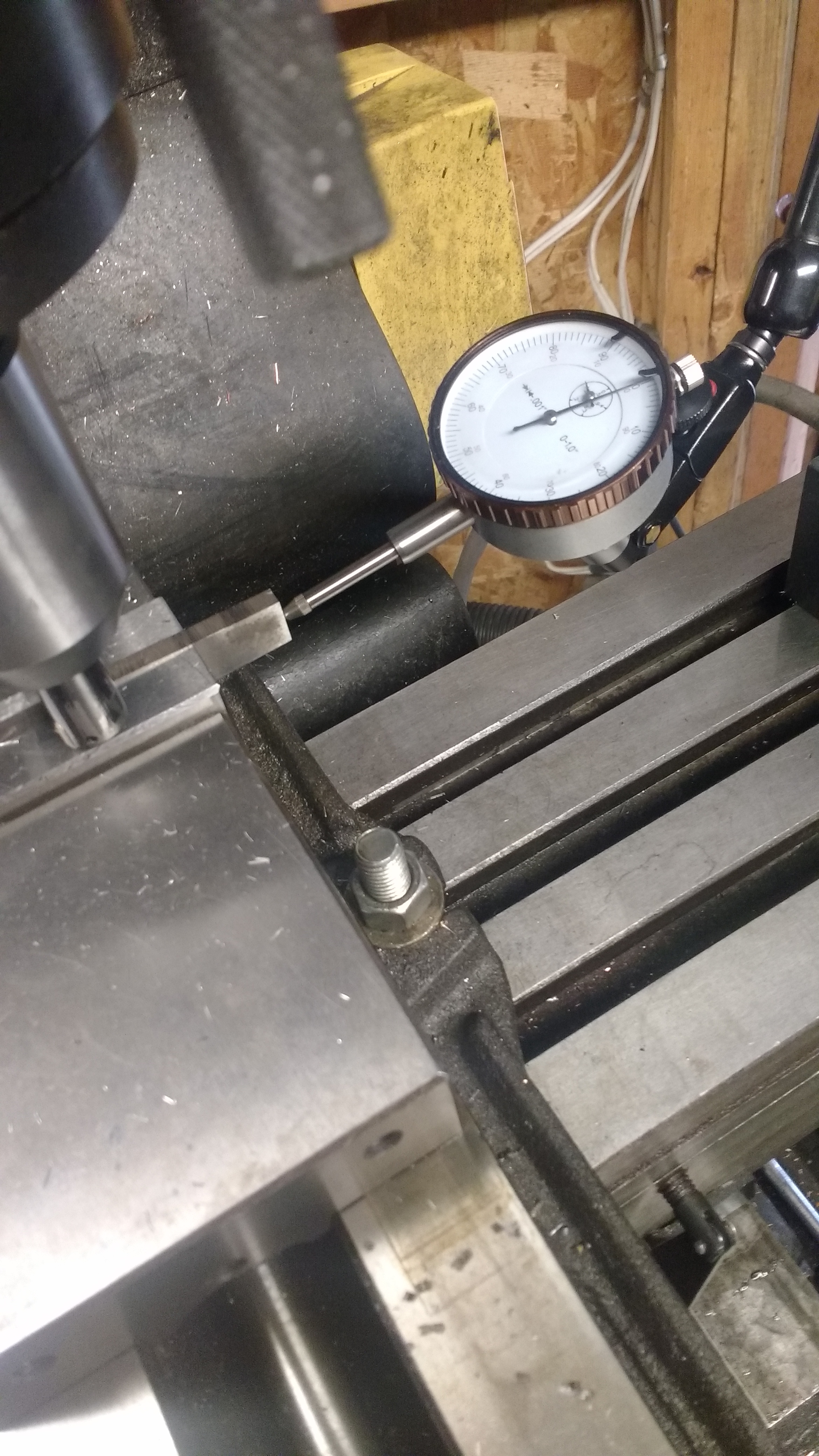

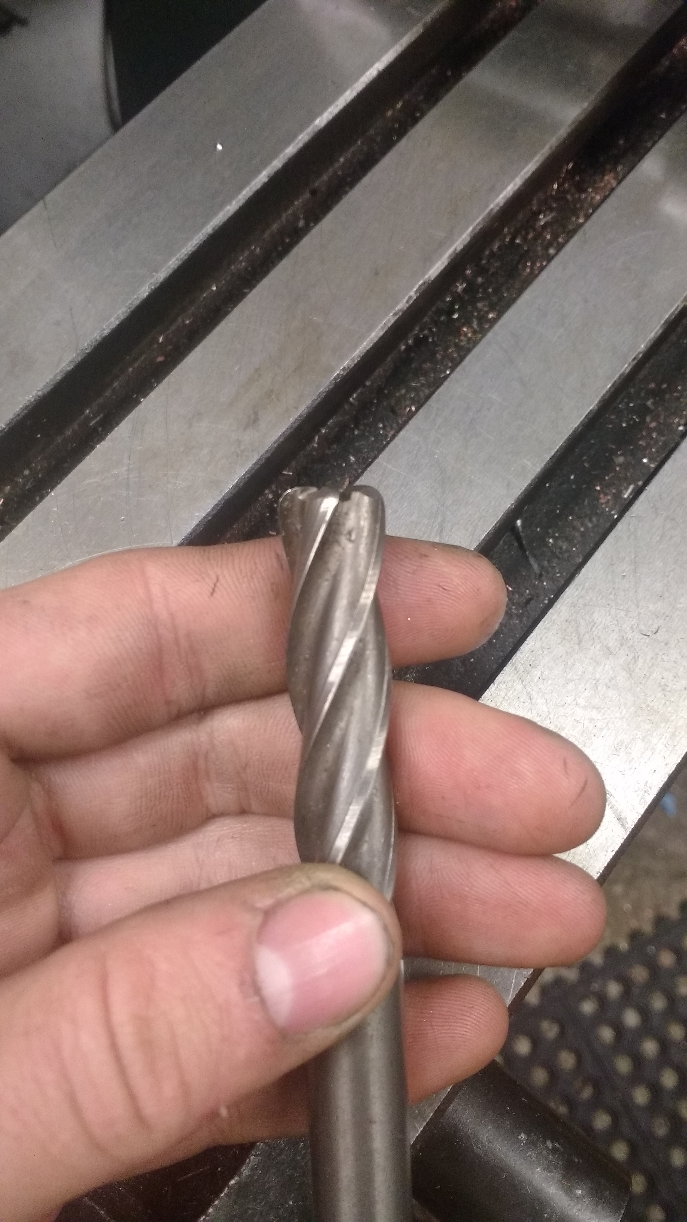

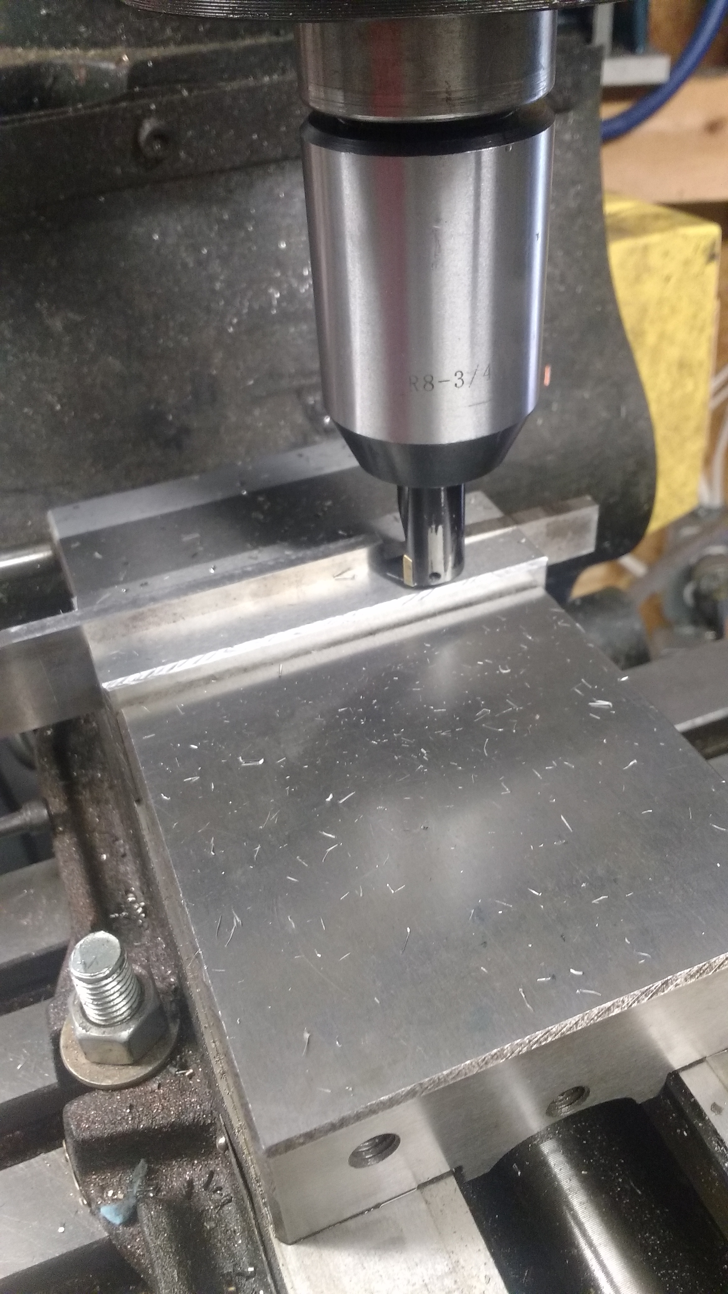

I look forward to seeing it. And thank you.For everyone interested, I'll set up and mill the shoulders on a blade the way I described tomorrow, and take some pictures of the whole process.
One of things I constantly notice on this forum is a whole lot of talk, and not a lot of photos showing it.
Excellent idea! It works.i work much thinner stock .113 mostly so i end up using a file guide and totaly rounding the tang to fit a 3/32 cutter slot
They don't look off to me. Thanks for posting those pictures.It looks a little off in that picture for some reason
I don't really know for a fact what the minimum would be.what do you guys consider the minimum safe radius for shoulders on the blade?
