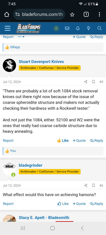

Some data to keep in mind.
Figure 1. Data from Larrin Thomas shows coarse spheroidizing did not have the same effect on 1084 like it did 80Crv2 due to the mechanism described in my post above.
In Kevin Cashen's 1084 DVD, he shows 1084 has a maximum as quenched hardness of ~65.0 HRC in his testing.
Figure 2. Data from Paul Verhoeven, further details how FeC3 readily dissolves compared M3C. (10100 steel has the same %C but with absence of %Cr)
So, the data and underlaying metallurgy explain why we can rule out coarser spheroidizing as the culprit in this specific situation for why this 1084 is not hardening.
Other factors I shared in the larger post show the direction needed for successful hardening in this situation.

Well, we don't have the same problems with hardenability with 80CrV2 like we do with 1084.
However, the carbides in 80CrV2 are more stable. (see post above)
So, NJSB 80Crv2 will need either a higher austenitizing temperature to better dissolve M3C or normalizing and annealing to break down the coarse spheroidizing into finer spheroidizing to make it more ready for hardening.
Without hardness testing it's difficult to rule things out when problems come up and require troubleshooting.
At this point I would recommend trying to keep everything as simple and streamlined as possible.
Keep in mind, the coarse spheroidizing is softer than fine spheroidizing and is excellent for machining and bandsaw cutting however, It's not going to be as ideal for hardening.
So, it's not like the steel is being purposely supplied to be difficult, there are trade-offs.
If guys are buying the steel to forge knives it doesn't matter either way but maybe we get more bandsaw life with the coarser spheroidizing.
For stock removal you can purchase future steel from Alpha Knife Supply Alpha Knife Supply .
They like to supply the steel ready to harden with finer spheroidizing and they are also good folks to do business with.
In the future when you purchase a hardness tester and surface grinder you can go deeper down the rabbit hole but right now the priority in my opinion should be to keep things simple and streamlined.
