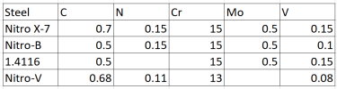

Buderus added 0.2% carbon to their Nitro-B to make Nitro X-7. Nitro-B is a 0.15% nitrogen addition to 1.4116, also called X50CrMoV15. It can be tough to keep up with the blistering pace of steel innovation sometimes.
The extra carbon would mean somewhat higher hardness and wear resistance at the cost of some toughness and corrosion resistance. It's not in the same product category as MagnaCut (level of wear resistance) so I wouldn't call one a replacement for the other.
