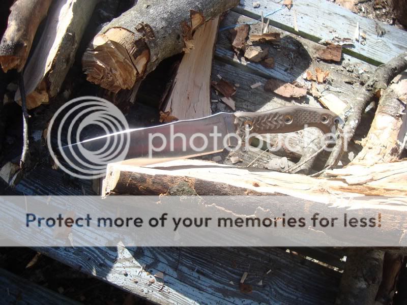

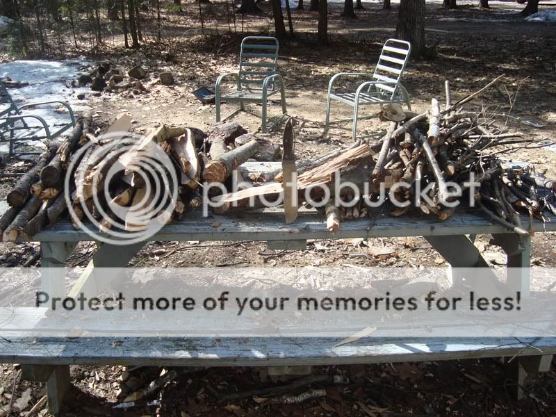

Took her out and beat the living snot out of her for a fire tonight. Still have a ton of downed trees/branches that need cleaning up after another rough winter.
I'm really into this knife quite a bit. It handles tremendously well, although it feels like the handle weighs more than the blade, it's not the case. It chops just as good as my FFBM did, and a little less than my NMFBM. In fact, I give it the edge on chopping for slightly smaller stuff over the FFBM as it seems to bite deeper.

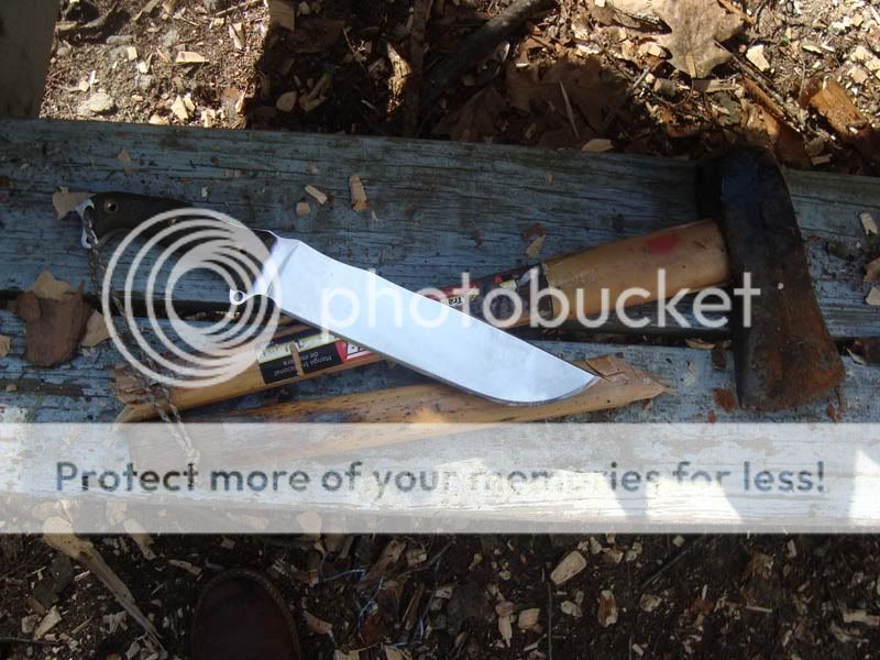

The FBM and a maul got into a fight... the maul... she'll never.. never split again.

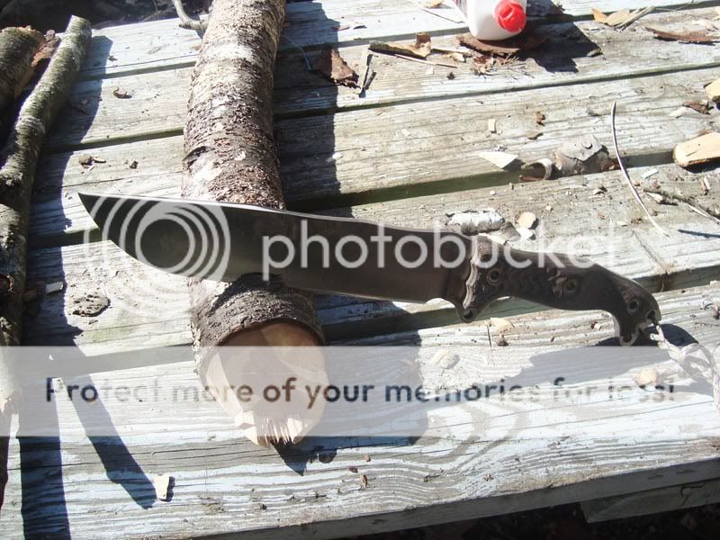

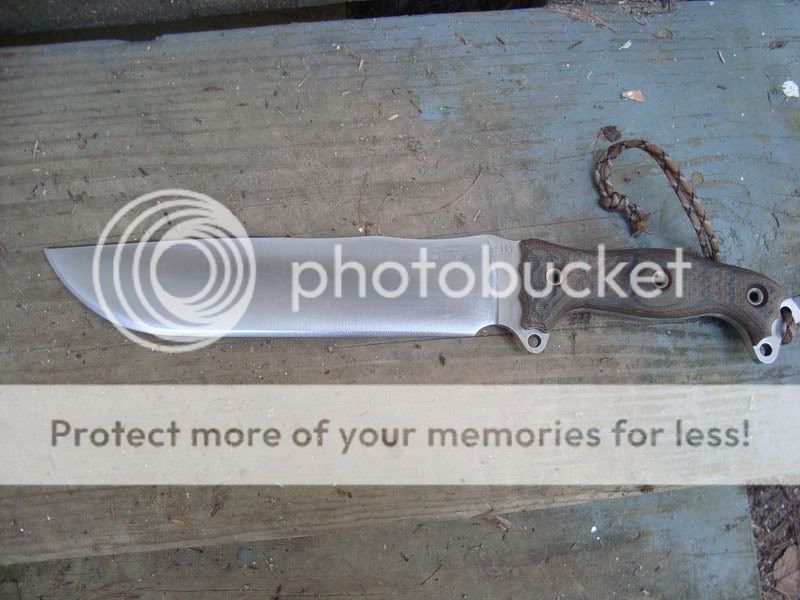

A little soap and water... cleaned right up.. well almost.
I think I may have knocked the handle out of alignment while batoning. Didn't really seem to notice it until the end, but had to really bang into it with one of the wood chunks.. Just a wood baton, but I was coming down hard to get it through a knot.
I have really bad luck.
Anyway, the knife performed awesome, although it doesn't chop quite as good as the NMFBM, its a pleasure to use. My hands don't even hurt...

Look at the bottom of the pictures and the pic of it with the maul, I already broke it first time using it.

another option:
drill out the tube fasteners (very carefully o_0) and replace them with screws and stand offs. you can get it really tight, replace them if sheered, and it won't damage the tang or the scales at all. if ever you (for some reason I'll never understand) want to get the tube fasteners back, you can send it in :thumbup:
230, I think LVC's got the right idea/answer. You could locktite them down and your handle problem would be solved. :thumbup: For now anyway, but you put stuff thru the test thats for sure. I still think you need a Moab with solid bolts though. ;)
I don't consider that broken. Being a machinist why not put them back on urself?
I am baffled though as to how hitting the spine would bend the tube fasteners.
I have thrown my FBMLE and the handles are fine. Lots of chopping also.
Don't tell me ur just that strong :)
If you go for drilling out the tube fastners 230 remember to only drill the tapered bit on one side .... after that you need to tap out the tube ... dont put the drill bit through the holes in the handle ... you run the risks of ruining the fit on the bolts ... PM Ban for the right technique ... he once posted that tip ... :thumbup:
Get some inserts like LVC showed. Carbide drill 64th undersized. Ream .005 under and
press in or make your own inserts with drill rod. Just my 2 cents.
I've done it to 2 knives, one busse one non-busse. The baton comes down and creates a sheering force on the tubes, something they really can't handle very well. The metal busse combat uses for the tubes is stronger then most, but it's still a long and relatively thin tube that your hitting from the side with a blunt instrument. you can help reduce the risk by raising the tang above the scales, such as these two examples:
http://www.grecoknives.com/Whisper_CT_Anodized_or_satin_finish_640_wide.png
http://news.soc.mil/releases/News Archive/2009/March/yarborough_knife.jpg
but it makes for a very uncomfortable grip when striking vibrations transfer to the hand via the raised area's. beyond putting a metal plate around that part of the handle like you see splitting mauls (a silver sheath around the shoulder portion of the handle, right up next to the head) there isn't much you can do to prevent handle scale sheering from baton strikes. Thats the main reason I prefer to replace sheered tubes with screws and standoffs instead of more tubes, it's faster and easier to repair on site, and it's going to happen eventually if you baton large wood rounds a lot.
