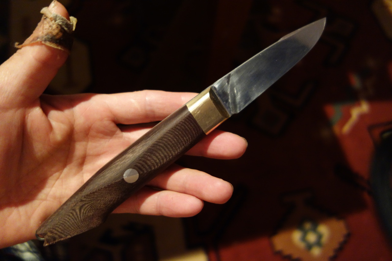

I'm building new knives, this time two blades at once.
The steel is cpm-m4, back from hardening process yesterday.
I'll add new shots to the photo bucket listed above with progress.

I mean this one.

I see you have gone for a maroon colour micarta. I think that's the nicest of all the micarta. Why the brass this time? Is it because it is easier to work, or because it looks more earthy with the micarta, or something else?
Thanks, baldtaco-II, you know everything quite well.
The motivation behind this work is, to be honest, an order from a friend of mine, whose boss retires from a job and he (my friend) wanted to congratulate it with some nice gift. I don't know the boss in person but I've heard he's a practioner of Iai-do and a Japanese sword collector.
Bolster material change comes from exactly what you said, partly from the easiness of work, partly because it looks better with maroon colour.
But above all, the largest change is the steel, I think. I was always using M2 HSS from Japanese manufacture for my blades but this time I moved to CPM-M4, which looks quite nice so far. it doesn't suffer rust as easily as M2. Also, this is the first time I use American steel. Really nice and no problem so far. Although I've cut nothing, but the steel can be felt while I'm working with it.

I mean this one.

Today I've shaped the handles. It's a hard long job. Knife making is a job way too hard for me. handle shaping not finished yet.
As you can see, the handle is shaped with multiple "facets".
When I come to this idea, I thought "wow this looks great! looks like a sculpture but at the same time also useful!!".
Then I realized how much complicated this shape is.

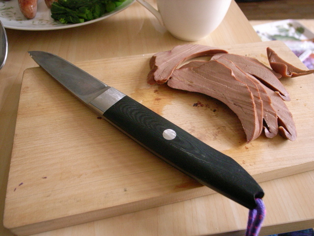

its done now. the one for my personal use.
