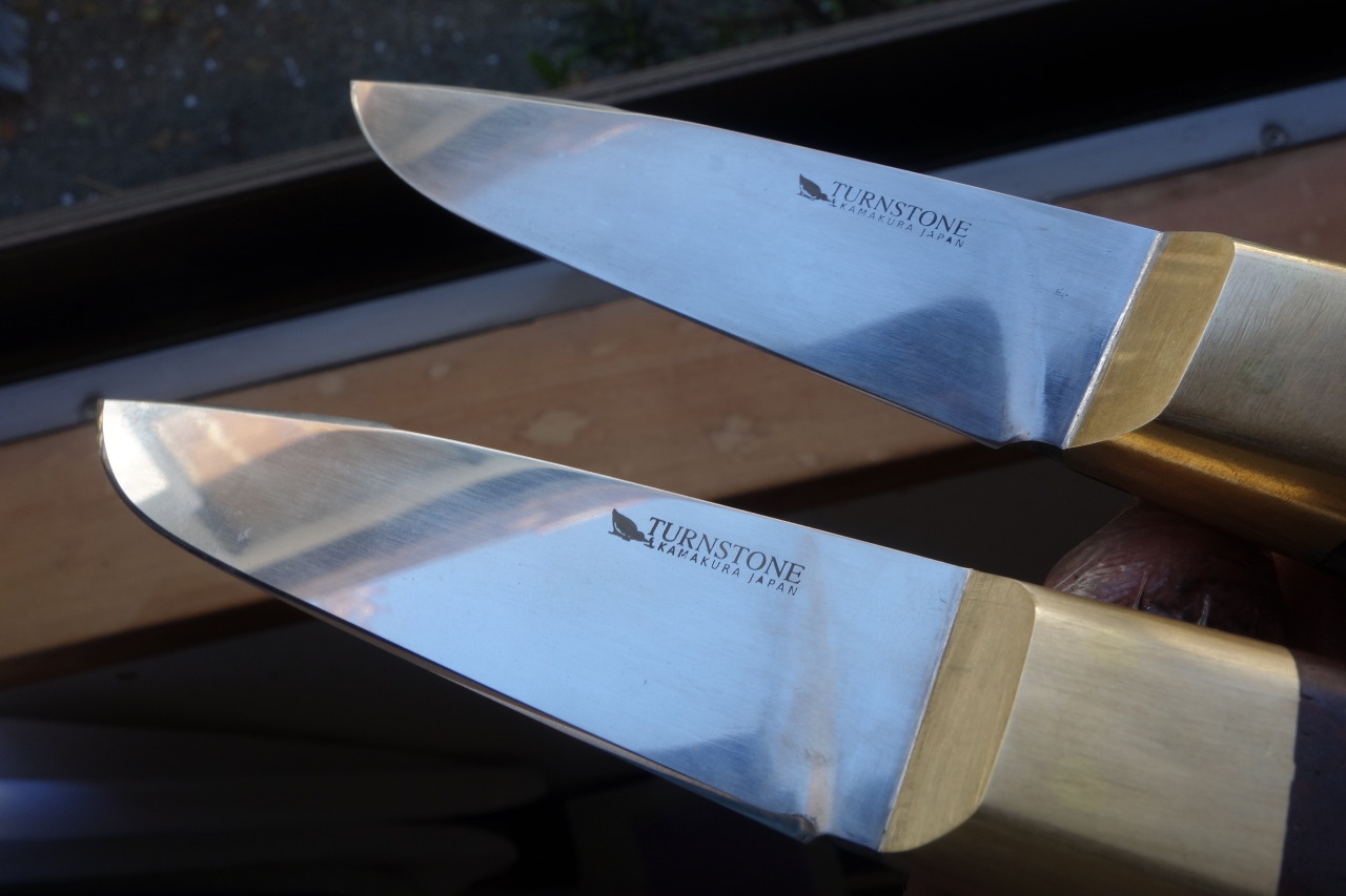

They're finally done. So I put maker's mark on each blade, although the one stays with me has failed at the thong hole :D
The logo is that of my company. This bird turnstone turns stone to feed, and my company regularly do data analysis, stochastic modeling
and related jobs. That is, this kind of job must turn stones to seek something good.
We humans also sometimes turn stones to find crabs in the wilderness, do we ? :D
I've etched on 12V DC powersource (a batt charger) with saltwater. It took only a few minutes.
The mask is a dry transfer, which I've sent a picture to the shop and printed. The cost was around 30usd.
