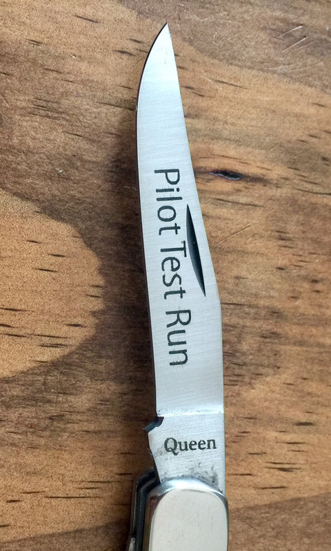

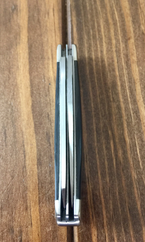

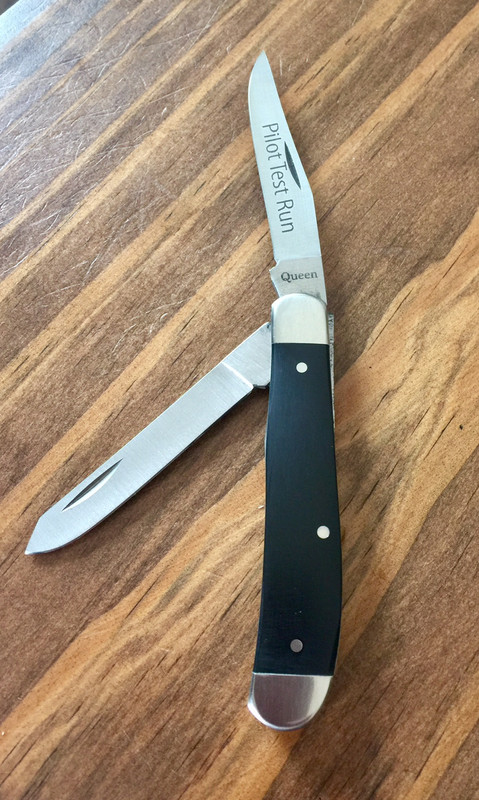

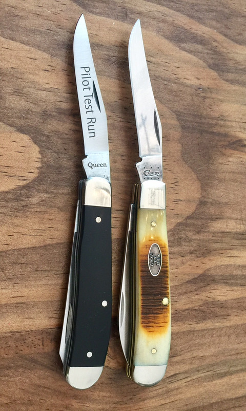

Mine surprised me and arrived today. I didn't really expect it until Monday...

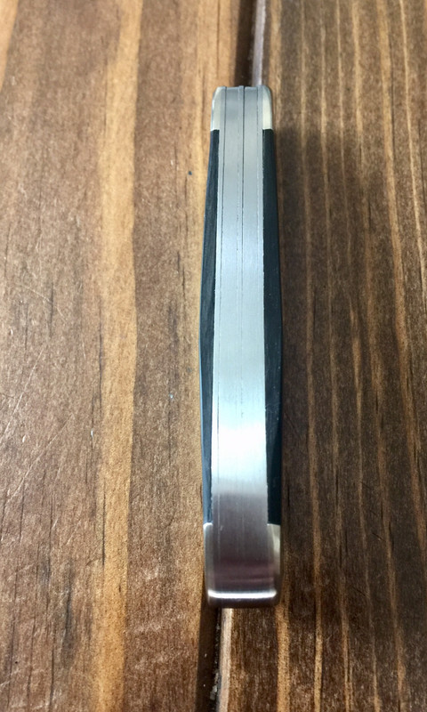

Overall, I'm pleased. Fit and finish are good. Probably equal to the yellow delrin Case trappers... if not quite equal, it is close. There is a little roughness in opening and closing, but I'm going to do a flush and see if that smooths up a bit. The blades have half stops. The edges are fairly sharp, and it could be put to use right out of the box. Of course, I'm going to "improve" them right away...:D
There a couple of very fine gaps seen when looking at the spine, but nothing glaring... blade centering is ok, but not perfect..... if all of their knives are of this quality, and they keep the prices down, I can see this becoming a viable choice for a good user knife. I think it's every bit as good as the nicer Rough Rider knives I've seen.
Got mine too super fast. Agree with everything hornetguy said. Worth the sub $50. Spey blade nail nick not really easy to access and very gritty at first but with some oil will be fine. Beater user whatever I’ve def seen worse so we’ll see what comes next. Better than expected.

My QN1 arrived today too.
I will just echo what Hornet already said, it's well worth the money. It definitely reminds me most of a Case knife. The action is a little gritty but the 'snap' is strong and positive. Overall the Fit n Finish is pretty good except some very slight gaps in the back spring. Transitions are smooth, pins are finished well, grinds look pretty even, and the blades sit relatively centered. Yup, reminds me of a Case knife but probably just slightly more crudely finished (not Case polished). I really like the pointier spey blade on this knife more than the one on the Case. At this price point I'd say it will be a good user. Maybe Bear really stepped it up for the Pilot run but future releases will tell the full story. I'd call this one a win. :cool::thumbsup:
Which brings me to the dealer. They should be up-front with the purchasing of the name and the manufacturer of the product. It's a solid knife for the price point and they should be proud of it rather than surrounding it in mystery. Okay, it's not the Queen of old, but it's better than some of those old brands that were resurrected overseas. No need for the shenanigans.
Enough talk, here's some pictures...

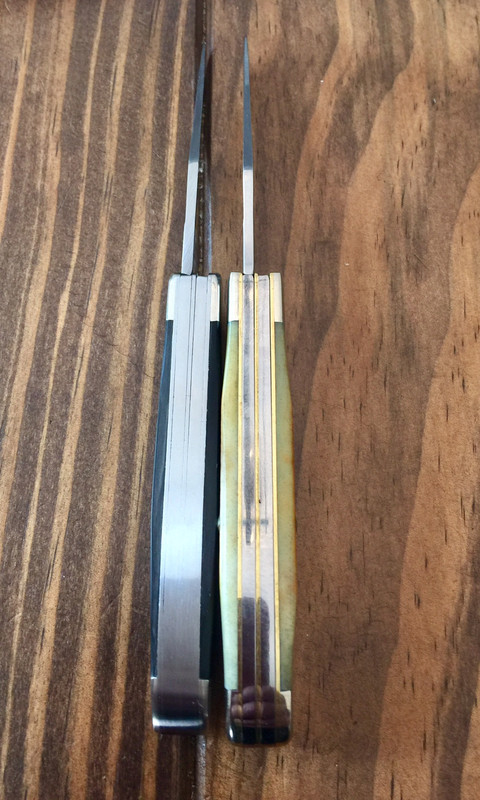

Is it the photos or is the blade stock a little thicker than most? Looks like a chunk of steel.
I do like the as ground finished blades.
I just put caliper to both my Case mini, and the new Queen, and the Case blades measured .095 at the top of the tang, and the Queen measured .087 and .090
The Queen is a little "fatter", in the middle of the knife, due to a "swell" in the handles, but rough measurement at the bolsters shows the Queen to be slightly slimmer. 0.44, vs 0.487

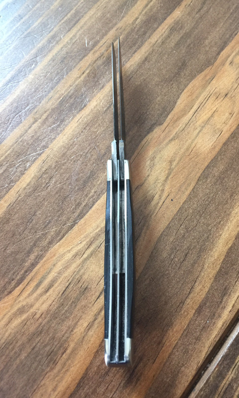

The primary bevels look really good.
And the rest of the knife looks just dandy. I even prefer the shape of the clip blade on the Queen, and the nail nick placement too.
