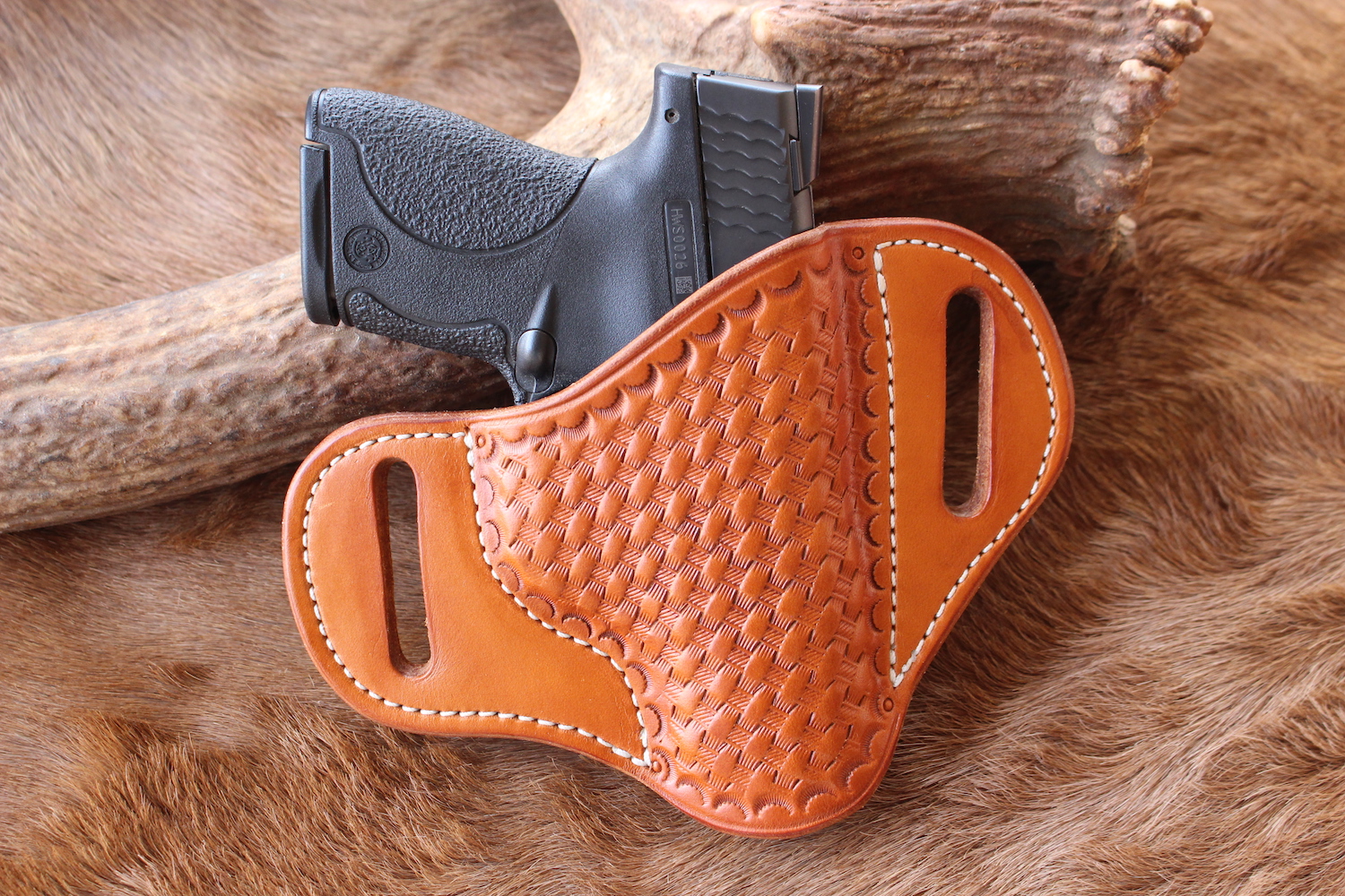

On this holster you can see a border cut and bevelled and then camo border stamped and basket stamped inside the border. You can also see the uniformity of the stamping and the depth achieved. Some of this is experience and a lot of it is good leather. My wife Nichole did the tooling on this holster.

I did this holster and I much prefer this. Again this is for strictly durability reasons. Above is not wrong. In fact it is the "correct" way, its just not how I do it. But my thoughts are based on thousands of sheaths and holsters:
I haven't mentioned the camo border tool yet. Here is another area where quality doesn't always equate $$. I use a Tandy Pro Crafter. Think it was $15. I REALLY like it an have many camo tools that cost many times that but its what I prefer.
