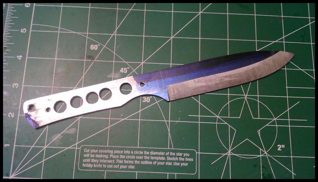

And here is a "small" knife in progress :)
SK "Metro" 1065 steel 4,5mm

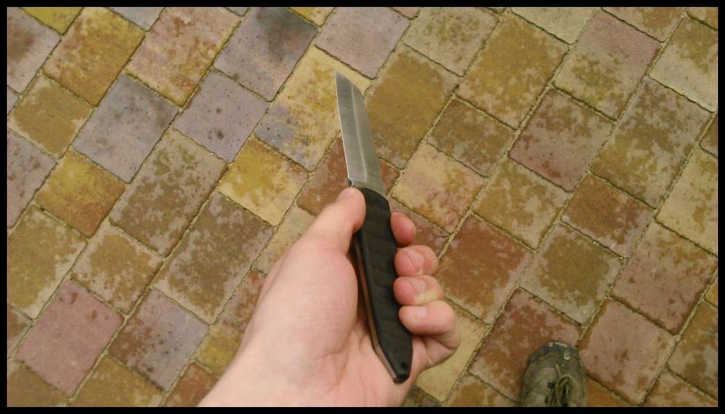

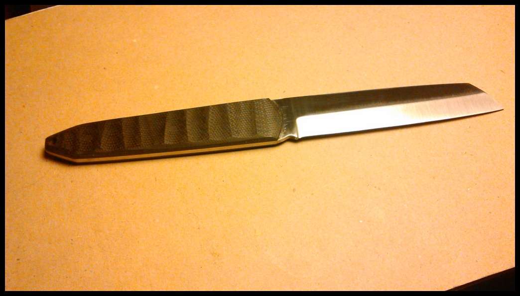

Fresh like gradma cookies :D
Steel: 80CrV2 (NCV1)
Hardness: 59HRC
Scales: 3mm black sandblasted G10
Blade: 95mm
Handle: 105mm
Very Sharp
Next 3 almost finished.
Steel: NC6 5,5mm, 59-60HRC
Scales: 6mm G10 black , toxic + sandblast
Now I think about to make for them a nice black leather sheats :)

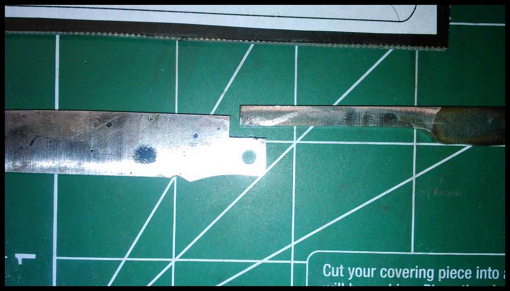

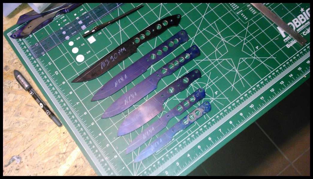

Couple of blanks profiled and drilled ( and one tapped for M5)
M390PM 4,3mm - Metro - tactical knife ) will be with M5 screw mouted G10 black - toxic finish, blade sandblasted + stonewash ( or acid + stonewash)

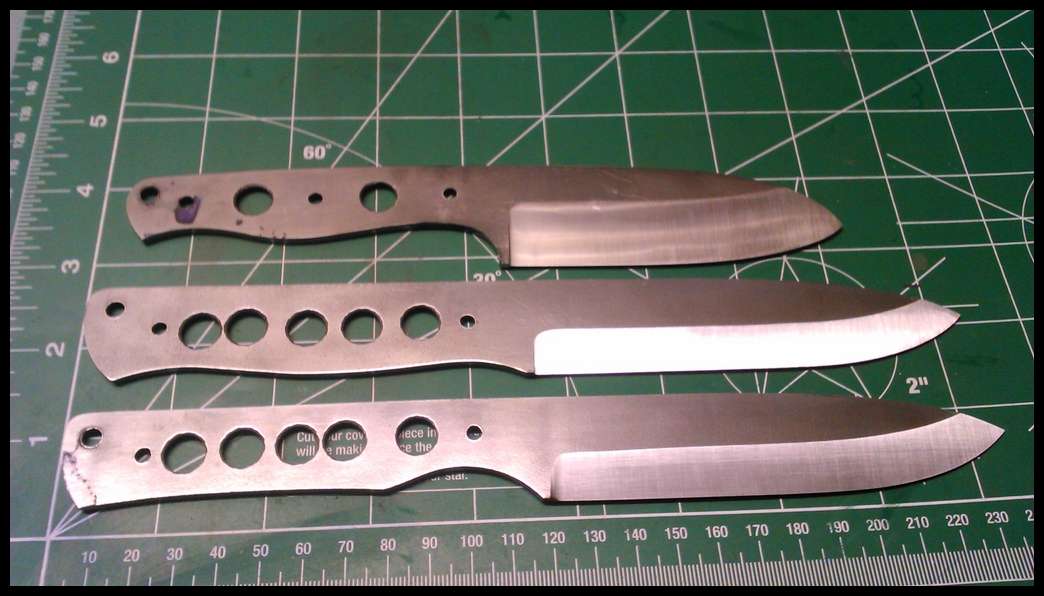

80CrV2 3mm 2 Bushcrafts, 1 drop point and 1 small sheepfoot and 1 drop point :P
Nice bushcraft knife in progress :)
Steel: 3mm NCV1 ( 80CrV2 )
Grind height: 13mm ( after HT will be 14mm )

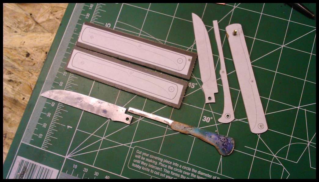

From time to time, I was thinking about to make my own Slipjoint knife, and finally I started making prototype :)
3mm 80CrV2 steel + 3,5mm G10
For v.2 slipjoint I'll use Bohler N690 2,5mm steel. Acid etch + Stonewash :)
And 1,5mm Titanium 6Al4V for liners, sandblasted + anodized, but now I thinking abour spring material.
Scales probably from Black G10 or C-Tec.
For spring can I use N690 or 2,5mm Titanium?
Washers = Nylatron GS 0,28mm or 0,51mm , Screw pivot assebled, to give chance of cleaning knife :)
Some tips ?
