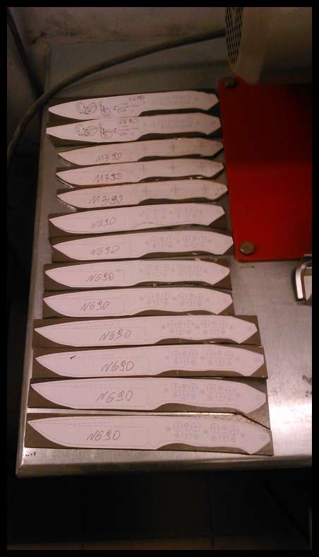

New Knives and some look on workshop (WIP)

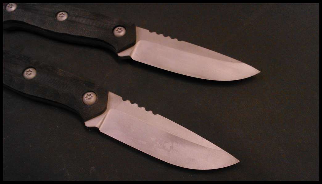

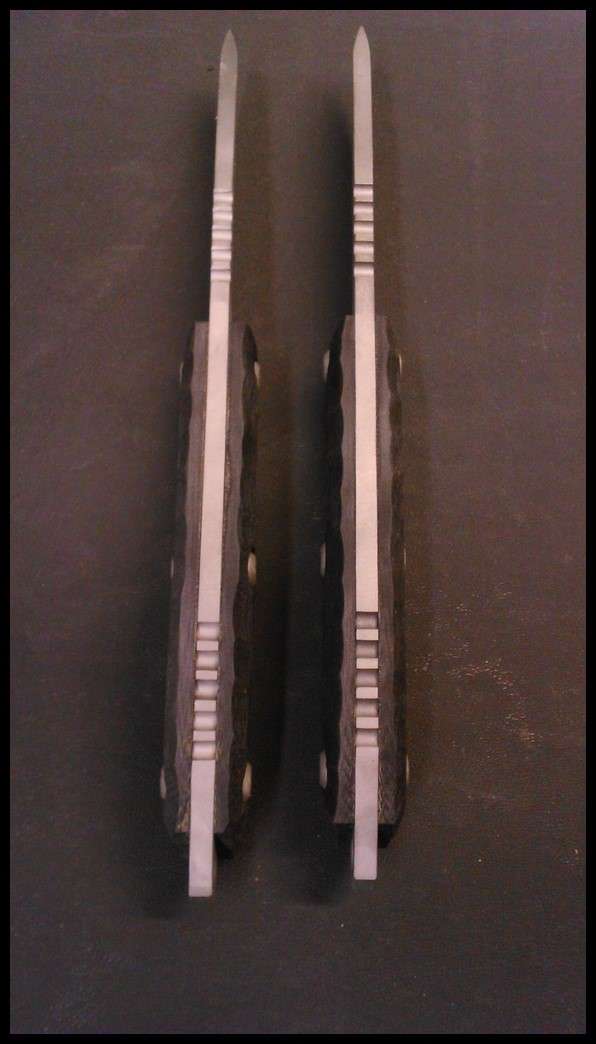

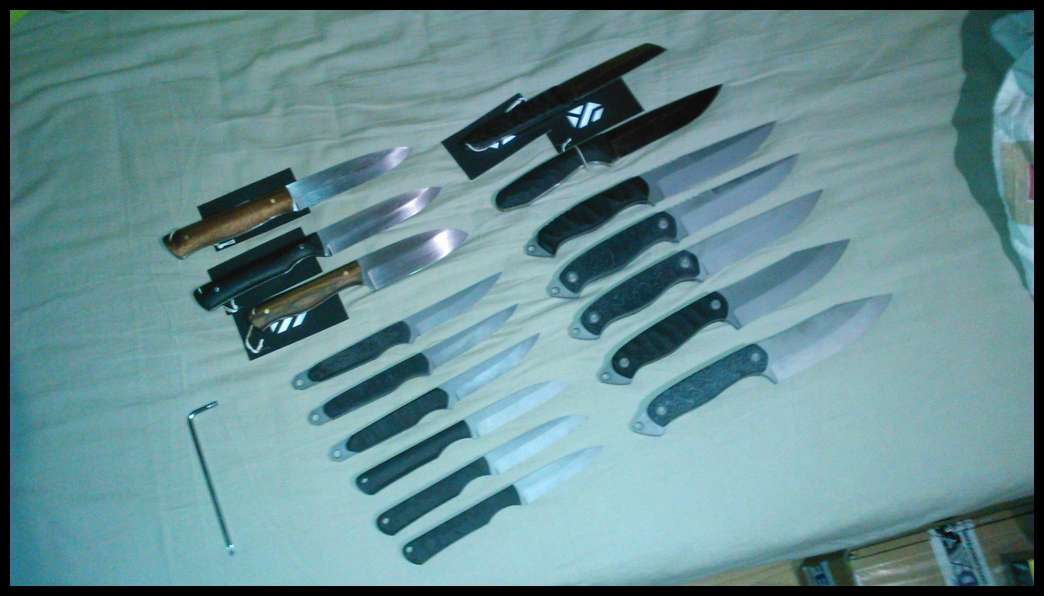

Knives ready to sell :D
Tomorrow taking all 15 knives to small knife show in Warsaw.
5x M390 ( Gryphon and Grendel)
6x N690 ( Hunter and Skylark)
4x NCV1 ( knives with wood)
1x NC6 (Hydra-P)
Sorry for matchbox photo:

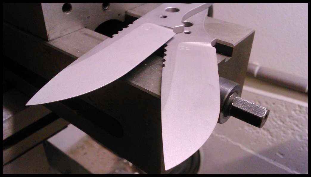

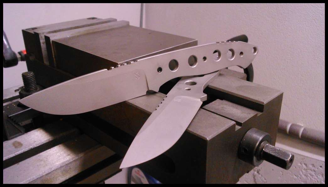

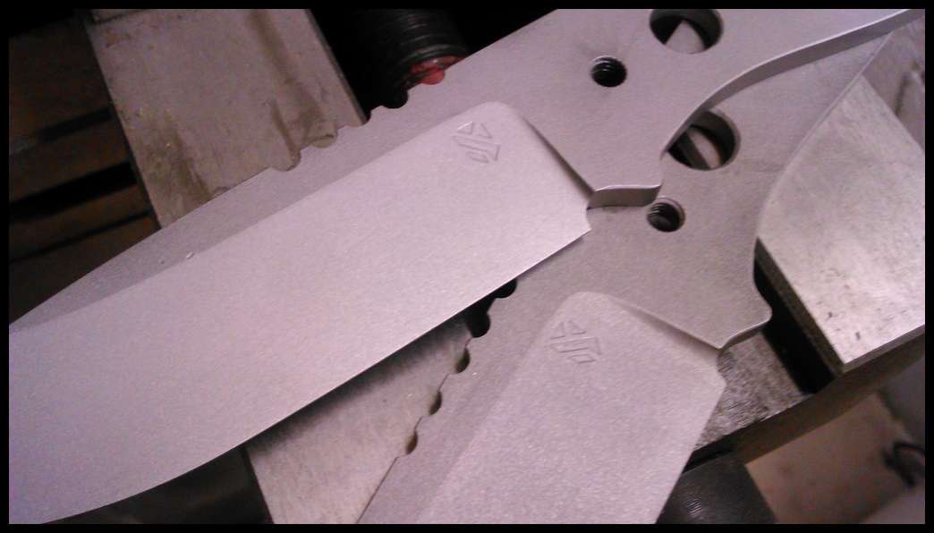

SK Sphinx made from Bohler M390 4,3mm , 96mm blade. Now Only I need to finish next 2 and send this to HT.
One of Sphinx with flat grind:
And 2 new with Hollow grind ( first try of this type of bevel)

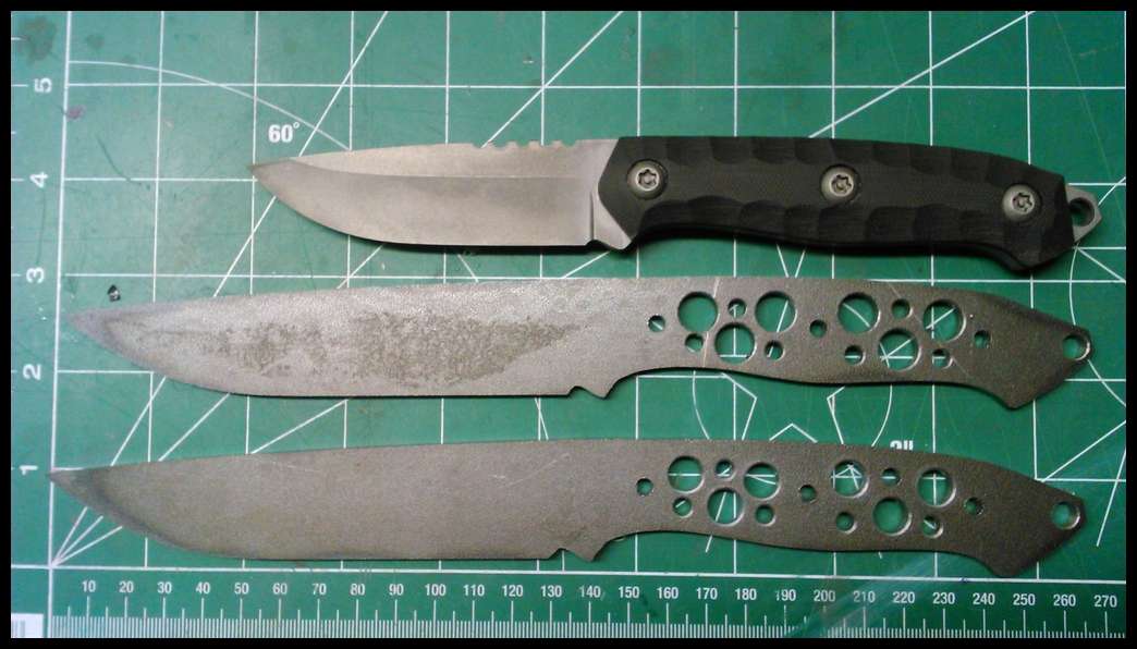

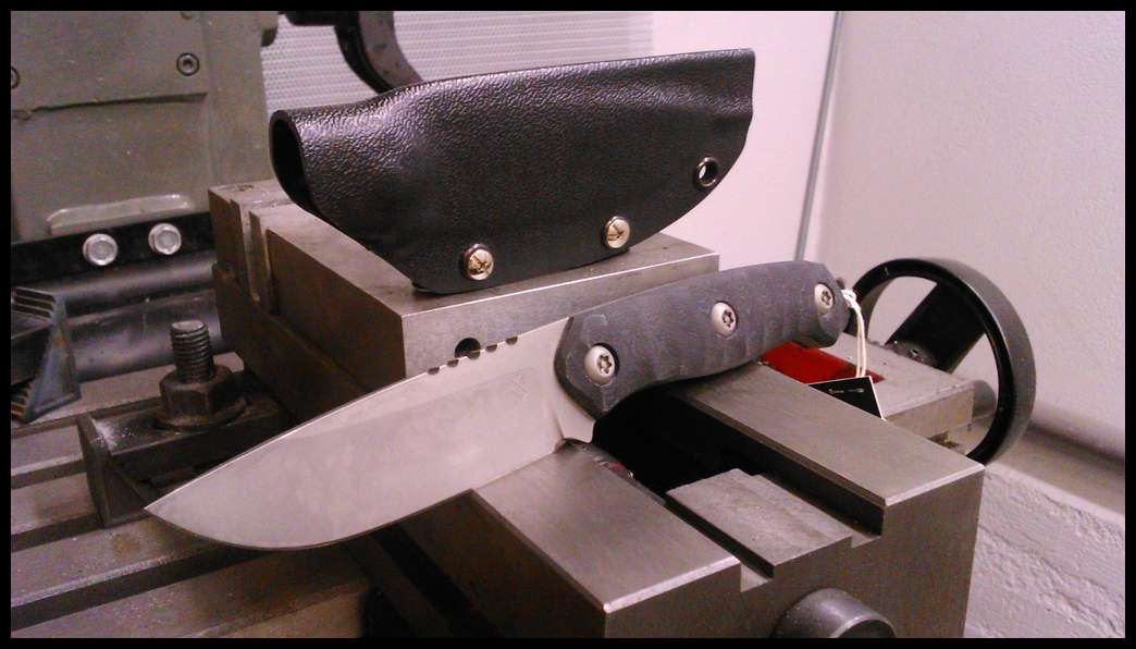

Here this 2 knives before grinding, but besides of them is a 2x new knife designed for me by my friend :)
Tactical Bushcraft ;)

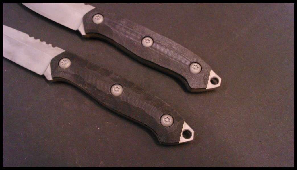

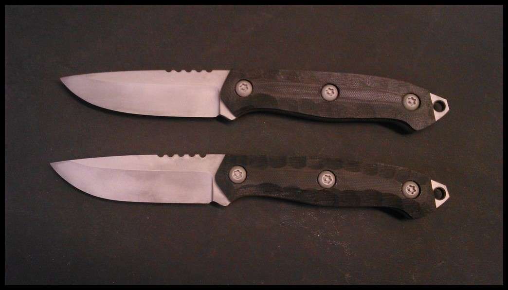

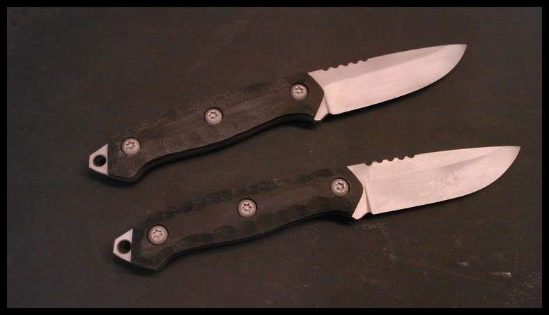

And Here are some recenty finished 3 knives :)
SK Manticore
AOL: 250mm / 9.84 inch
Blade: 110mm / 4.33 inch
Bevel Height: 27mm / 1.06 inch
Handle: 120mm / 4.72 inch
STEEL: Bohler M390 4,3mm / .169 inch ~59HRC
Scales: G10 black 6,5mm / .255 inch
SK SPHINX
AOL: 217mm / 8,45"
Blade: 90mm / 3,54"
Bevel Height: 18mm / .70"
Handle: 120mm / 3,72"
Scales: G10 czarne 6,5mm / .255 inch

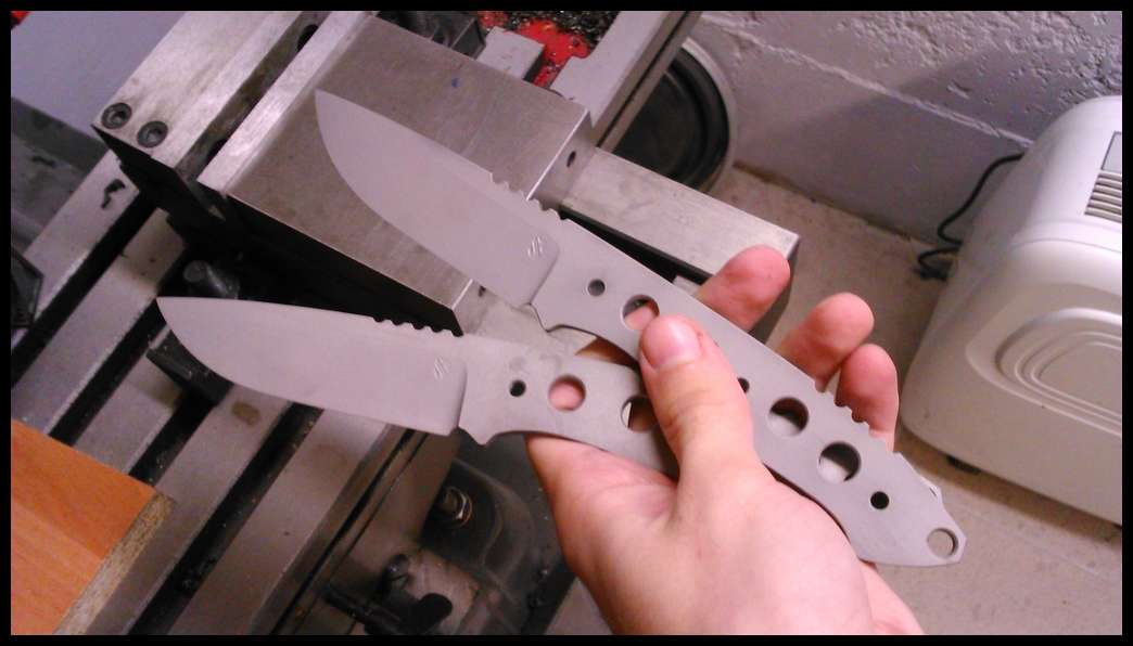

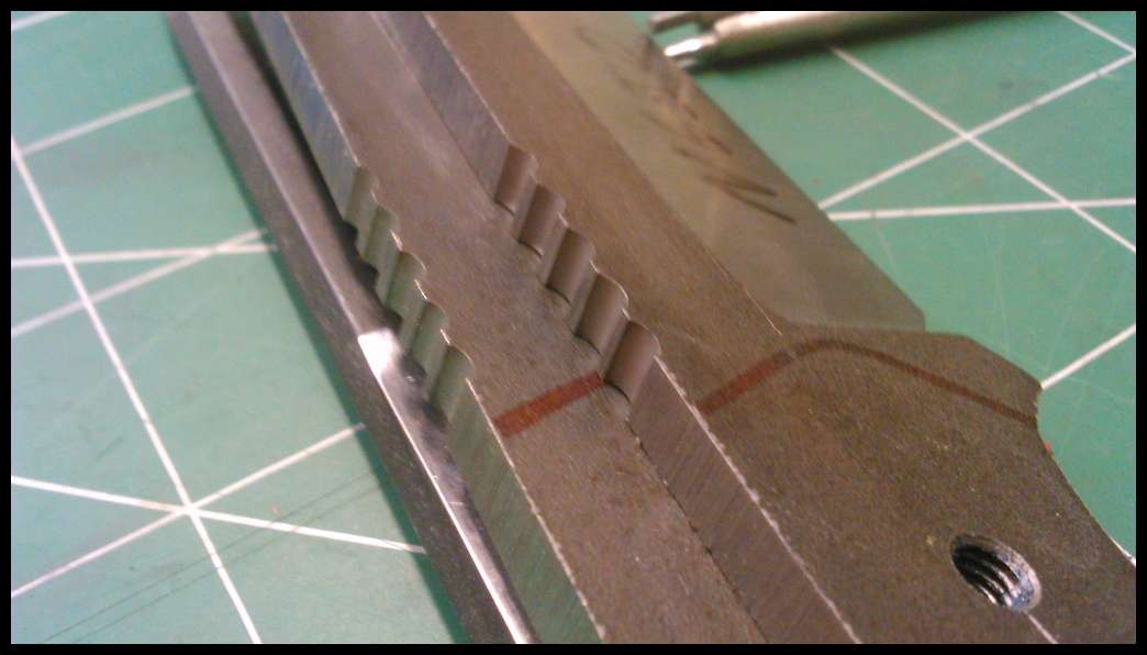

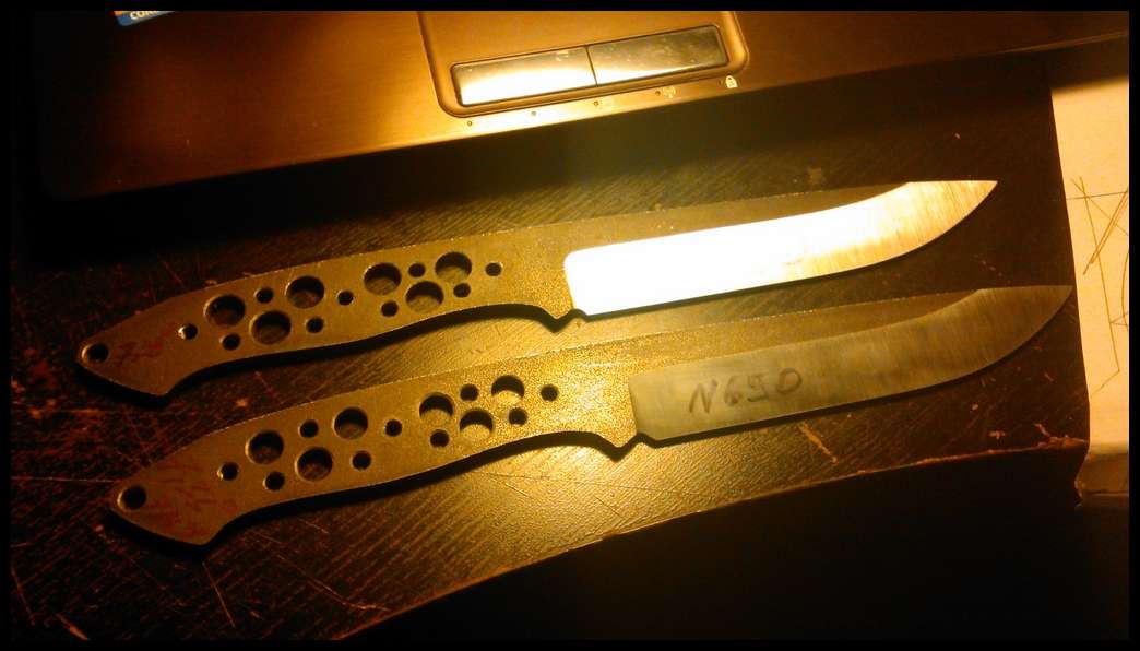

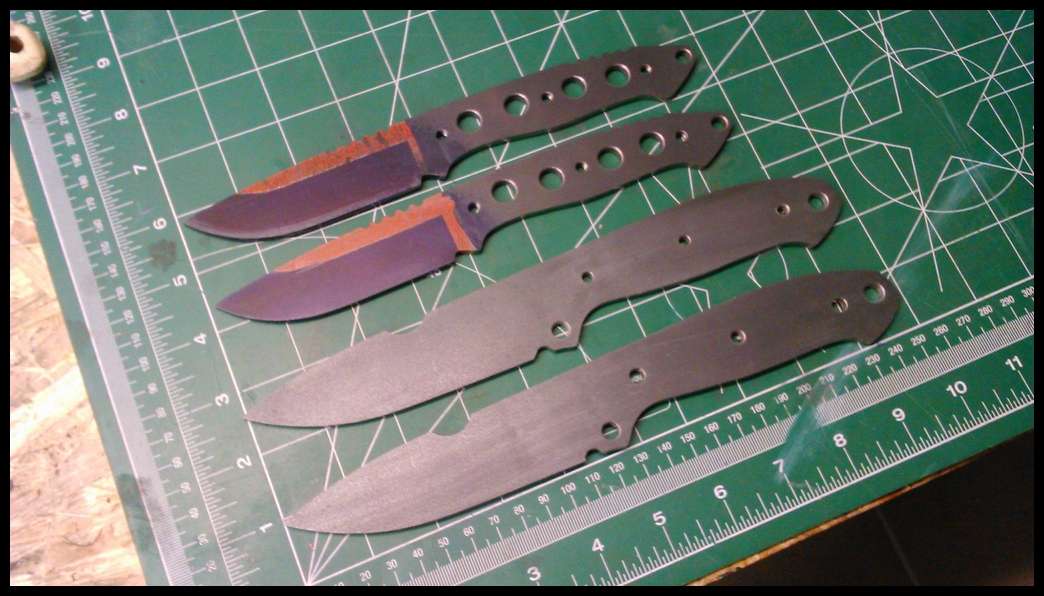

Started working on 2 blades Gryphon, in slighty new way ;)
I think to put on them scales in style like on Sphinx.
One is already reserved :)
Both Gryphon's have bevels now :) (7,33 degree per side)
In monday they going to HT :)
And in monday I also get new Deerfoos Bora7 P40 belts, and then I will shape rest of knives.

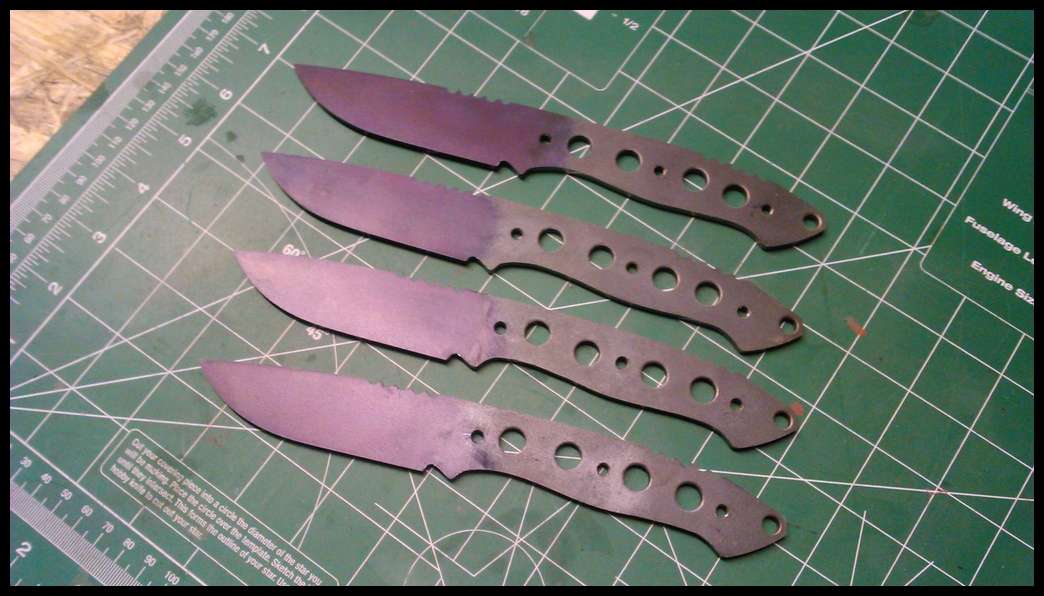

N690 4,5mm:
2x Gryphon
4x Sphinx
4x Grendel ( "tanto" blade for hard working)

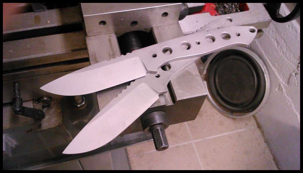

And how two Grendel's look now :)
