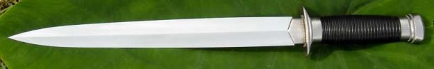

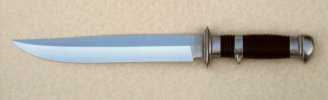

I'm working on a few pieces to bring to the Russell Knife Event (show), July 24-25-26 in Rogers Arkansas. These are still WIP pics... I need to do the final finishing on them, but they are starting to look like knives now.
All four shown are D-2 steel with all titanium furniture. The grips are rubber wrapped over a laminated bamboo core, and all the knives are complete takedown pieces via toggle tang construction. The dirks will all have kydex sheaths and shoulder rigs in the Vorpal style... haven't decided about the dagger scabbard yet. The pieces are ultralight... weighing from 7oz to 9oz... yet very strong due to the bamboo and titanium.
I've been working on developing the rubber wrapped handle style and I really REALLY like it a lot. It has an incredibly secure feeling in the hand... very grippy and slightly cushy. The technique involves the use of stacked O-rings, which are available in many sizes, thicknesses, colors, and materials. There are some tricks to getting them to lie right, and especially to getting them to sit down at the surface (instead of above)... but (IMO) this technique has the potential to completely revolutionize custom knifemaking just as the introduction of thermoformed Kydex did in 1982. While several manufacturers have made injection molded synthetic rubber handles for years... it has always been beyond the reach of the custom maker. No longer! While W.W. Cronk pioneered the use of O-rings on a knife handle as far back as the 1970s, he never took the technique any further and apparently didn't share the idea around. You've got to handle one of these things to appreciate what I'm talking about. I can't take my hands off them.

Good golly, those are nice. Are you planning to color the Ti parts? I personally like the purity of the gray/silver finish.
Have fun at the show!
Wow!......very beautiful.
Are the brown o'rings Viton or one of the oxygen compatible compounds?
Yes the brown are Viton (fluorocarbon)... the black ones are nitrile. They're completely replaceable. I mark on the handle underneath how many of what size are needed.
Hmm... yes I was planning to color the Ti parts... the gray finish looks so much like stainless to me that it seems to lack some "zing"... plus the deep blues and purples are darker next to the black. I was thinking green for the one with the Viton handle wrap.
