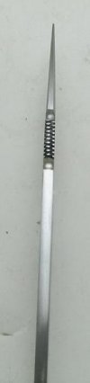

hey guys hope ya like it
1/8" thick O1 tool steel
5 1/4" long overall
thumb and forefinger checkering
400 grit machine satin (gonna kick it up one more notch and go to 600 grit)

you got it... just edited to fit that in....
i think it will make a nice little neck knife, for small chores ya know? i'm working on a few models like it with different blade shapes
one a little larger with an integral guard too, geared a little more towards stabbing, i mean self defense:D

Kind of looks hollow ground, is that so Mikey? Looks sweet, too bad I don't have enough of a chest to rest it on!
haha yeah it is....
i figured i'd make it small for chicken chests like us

Is O1 stain resistant enough to work for a neck knife? I know sweat is some nasty stuff. Very nice design and execution. I love the way the grind looks with the notch on the blade spine. Great work.
I've had some O1 bars sitting in my garage over the winter, getting damp and stuff, and they're, compared to the mild CRS next to it, in supprisingly good rust-free condition, with only surface rust on the side that was contacting the ground. O1 certainly rusts, but it's a lot better than, say, 1084 / 52100 in my experience. I picked up some O1 along with some other steel scraps from another smith who hadnt used any of his steel in 20 years, the O1 was identifiable from the mild and wrought iron because it was the only chunks which were still mostly shiny.
What's the blade length and can you make it with a drop point in cpm154??
yeah i imagine i could do that. this was mainly a prototype in O1, because its what i can HT at home for now.
as far as the corrosion resistance, its not that good. though i have has A2 neck knives that i coated with eddible silicone grease and wore without any rusting.

Justin: you're right on that relatively speaking its not bad for carbon steel. especially with a fine grit finish its pretty good
editted the first post to add a spineshot for you. thanks for looking guys
