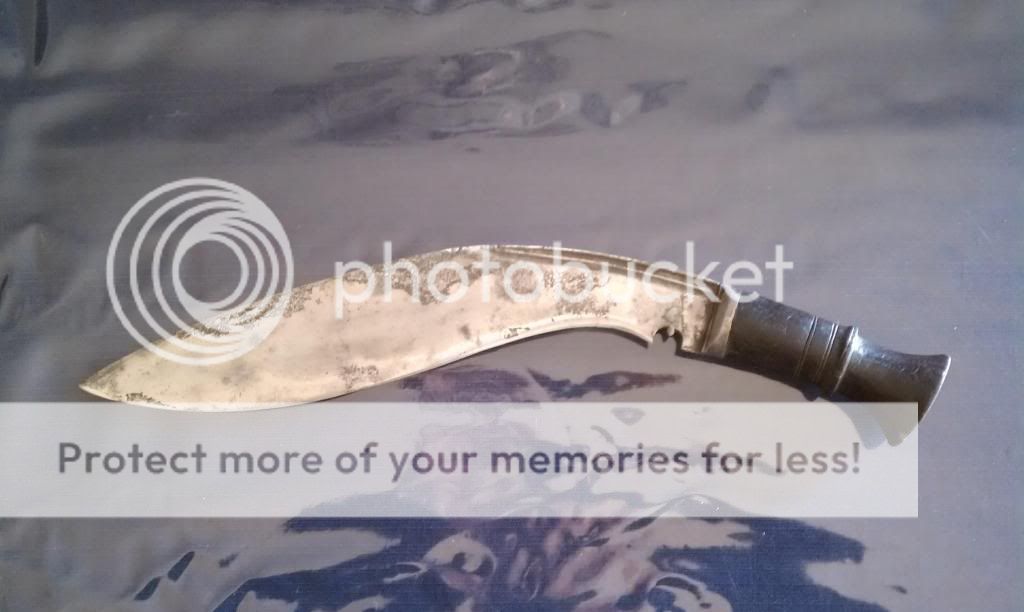

Picked this up off of that auction site for a song but I'm gonna need some ideas for repairing or replacing the pommel.

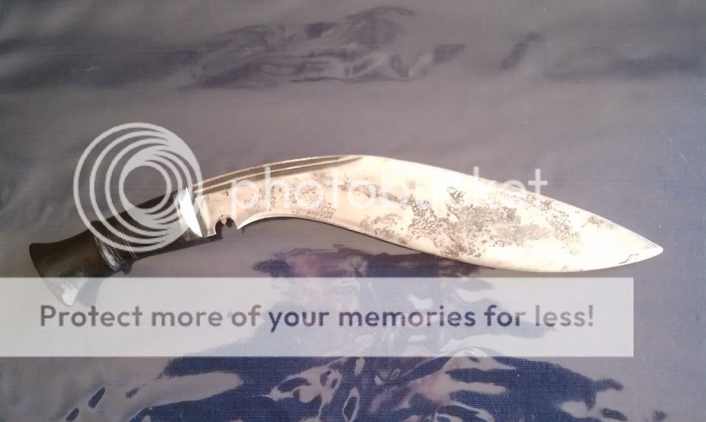

Looks like someone was throwing it as the tip was blunted and of course the missing buttcap. I repaired the blade using period tools (file) but I am now moving into new territory with the pommel.
Saved the dried out handle by soaking it in BLO and it came out great. Oiled up a very dried out sheath as well.
She is 17.25 inches long and weighs 21.95oz
Nice job so far.
You could cut a piece of soft steel or thick aluminum or brass into the shape of a buttcap, drill two holes to match the protrusions, rough up the existing butt, and attach the new buttplace with two-ton epoxy, which would also fill the apparent gap between wood and tang.
Since the wood is a bit rough around the edges of the butt, I would be tempted to use brass, make the plate a little wider than the butt, and hammer the brass around the edges of the butt so it wraps around, covering the wood for maybe 1/8".
Maybe thin out the edges of the brass with a file and cut some slots, to make it easier to bend it around the edges of the wood butt.
An easier option might be to file down the rough edges of the wood to eliminate the gouges; then you could attach a buttplate without having to do the wraparound. You'd lose a little of the butt flare, but that might be worth it.
There's also a bit of metal protruding at the top end of the tang. You can probably just file that off.
Looks like someone intentionally ground the butt plate off? Its too nice and square. Maybe replace it with a brass plate to match the handle pins and re peen it. Period correct may be steel? May have to do some grinding around the tang to get enough material to peen it again? It looks like an IMA/AC Bhojpure except for the full tang which would lead me to think it is British or India made? Dont bank on my history knowledge tho. Nice find! Do you see any markings on the blade?

Being it is full tang I'd probably break out the Ben Gay and a file and work that pommel down both wood and steel until everything is smoothed up and even.

Looking again and after reading ndogs post I'd probably try filing away the metal that is above the wood top and bottom and smooth up the wood but leave the two old post where it was peened before. Give the butt end some character and you can use it to stamp people with your mark after your done with them. IE- use the two post for decoration.
It has no marking so most likely it is a private purchase kukri but either very close to the end or just after WWII. Id say it was made by the same outfit that made the M43 as its nearly identical to the M43s I currently own (save the non sunken rivets and lack of any rings cut into the handle usually 5)

I beginning to think that was a project Khuk from somebody that removed the butcap and sanded the rings down then abandoned the project. Since it has been modified already if it was mine I would be inclined to epoxy the voids full and just sand everything flush to the wood. The wood is already nicely exposed so just filing the metal even with the wood might look really good.
