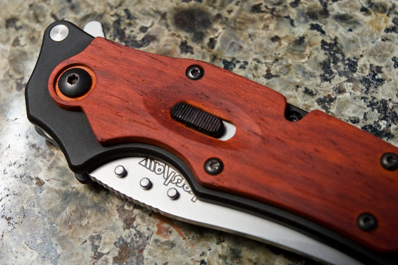

New scales for my RAM
Thanks for the compliments. I'm probably going to use some lightly-figured cocobolo I have for the next scales. The color is very similar to that of the Padauk, but cocobolo is much more durable. After that, I'm not sure. When I get back to my real shop, (I'm on vacation at my family's house), I might try some tulipwood, snakewood, or maybe some Asian ebony. The sky's the limit if I decide to go with a stabilized wood.

Thanks again for the encouragement, guys. I just finished my first full set. Again out of Padauk.
I'm not at my shop, so the process is not as smooth as it could be, but it's working out. I first blank out the pieces and flatten them. I start at about 1/8" thickness. I've been backing the padauk with some CA to reduce chip-out and increase durability. I then trace the pattern and drill the holes and countersinks, (this is tough with the crappy press I'm using). I then use the belt sander to rough shape them followed by lots of hand sanding. The indent for the lock is put in by hand. I then flatten the faces and smooth the edges. Finally, a coat of tung oil finishes it.
The wood scales are thicker and smoother than the G10 but they feel really good in hand. I have to sacrifice some durability, but they do look good.
I'm planning on making more of these. I think I'm going to try blackwood with gemstone inlays next. I just have to figure out what pattern would look best.
Phillip
(I think I'm going to have to make a lumber run soon)
Here are the pics. The padauk is interesting in that it changes color quickly. The orange turns to a darker red in a few days. That's the reason the color doesn't match in the photos.
