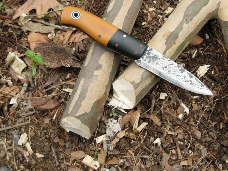

Got another paper package from Andy Roy of Fiddleback Forge
The specs are
Over-all length....8 1/4 imches / 21cm
Blade length.......4 inches / 10cm
Handle material....Natural canvas micarta with black canvas micarta bolster
Blade Steel........ 1/8 inch / 3mm spalted O-1
Maker: Andy Roy of Fiddleback Forge
http://fiddlebackforge.com/

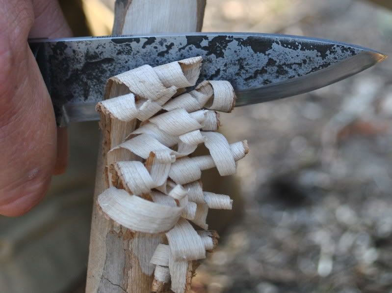

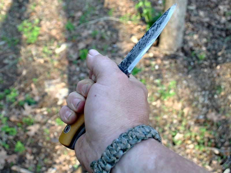

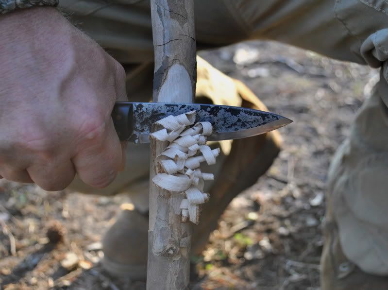

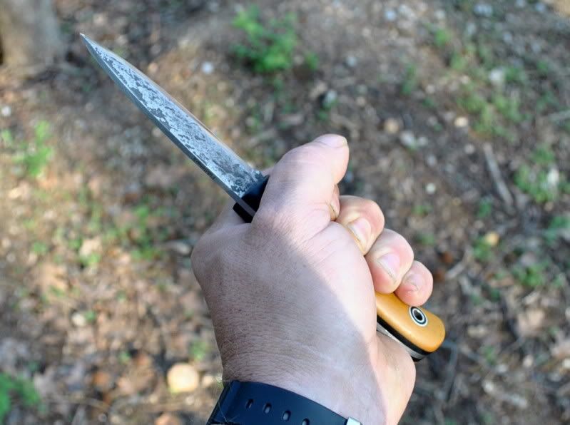

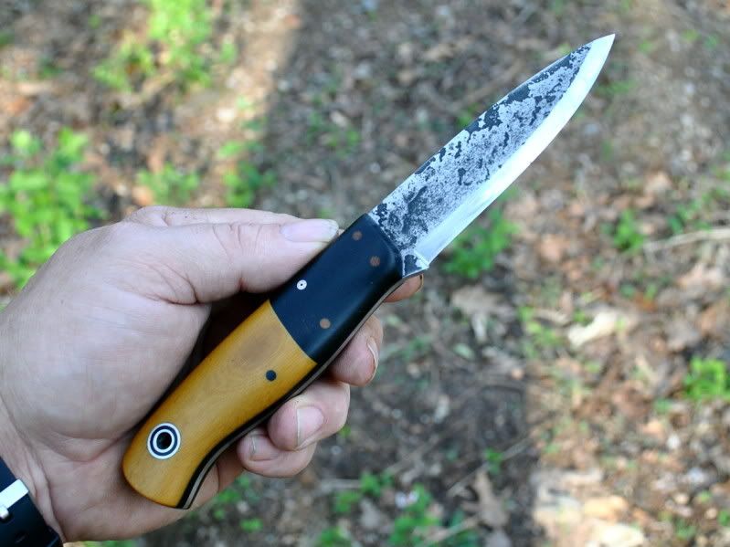

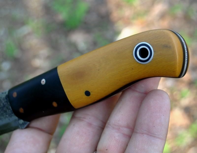

I love Andy's craftsmanship, his handle ergonomics are always sublime, and as usual this one has been comfortable in every grip I have used it in. The balance point, though not pictured, is pretty much right on the line of pins with the mosaic pin. This makes it a bit handle heavy which is fine for me in a knife I'll use for long term whittling and carving.
This one is my first custom with a scandi grind
end part 1 of 4

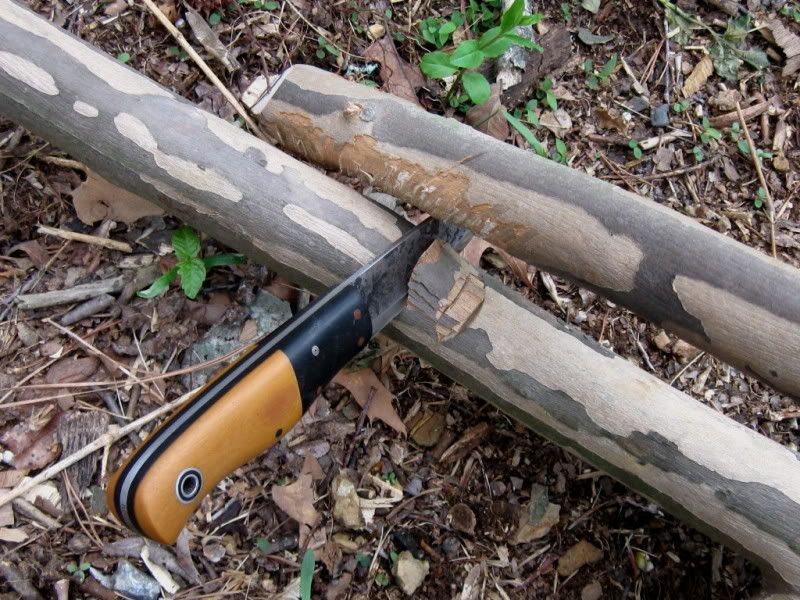

Having a scandi grind on a knife thicker than a Mora is mostly a new experience for me. I have never really been a Mora fan, and never really new if it was the grind I didn't like or the thinness of the blades. I have learned that it was primarily the flexing of the thin blade I did not like. While I am more familiar and comfortable with flat grinds, V grinds, and have in recent years gotten used to convex grinds, I have noted a couple of things about this type of grind. For one putting a really sharp edge on them is easy to do. Secondly I like how this type of grind leaves a lot of strength in blades of 1/8 or 3mm thickness.

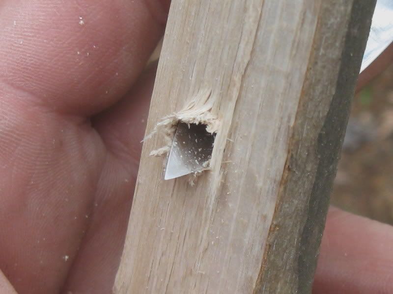

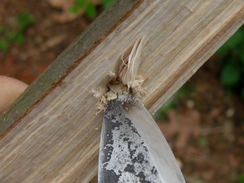

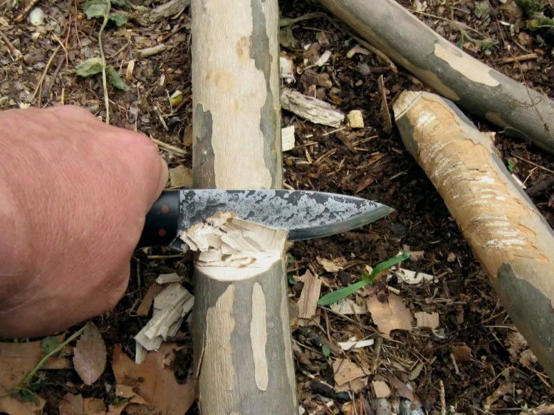

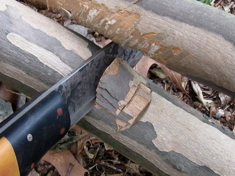

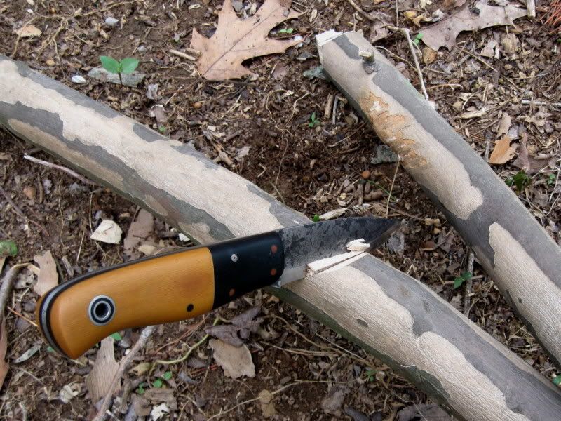

I used it for some cross-grain batoning or truncating some hard seasoned sycamore and it handled that quite well. First I used it to partially cut through a long limb so that I could easily break it into a manageable size.
and then to cut a piece of that down even further as if I were needing a piece for a hearth or the drier insides for tinder. The knife took the beating very well, with no harm done.

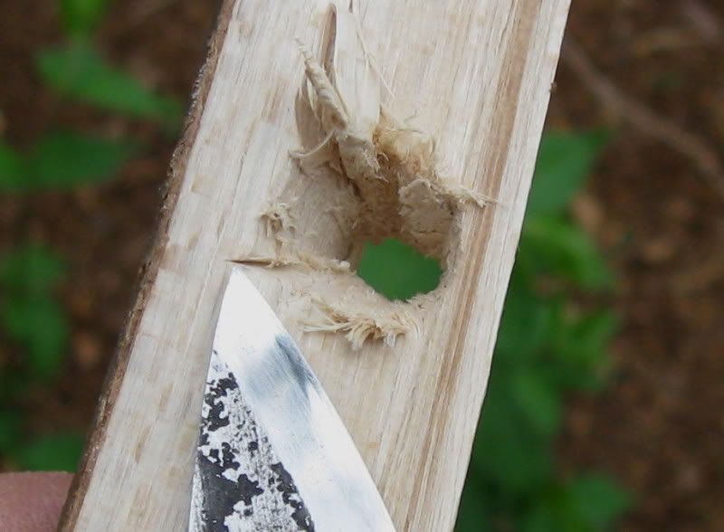

Then I proceeded to baton that with the grain, no troubles there either. I think the knife is definitely up to most tasks I would need to perform to achieve fire even here in the temperate rain forest I live in.

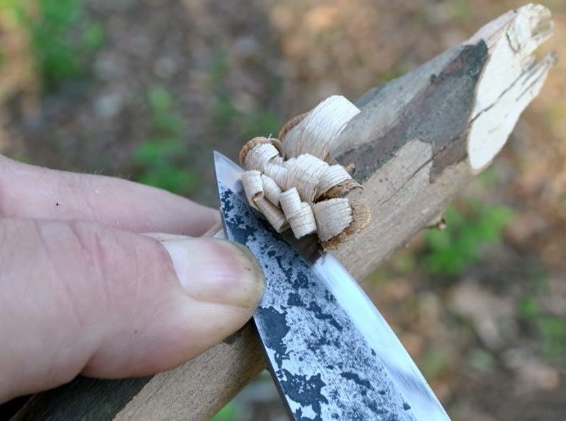

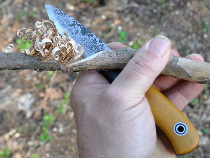

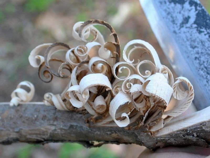

It handled some tip work just fine as well.

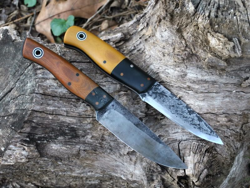

How do you feel the cutting performace compares to the bushfinger? Anything one does better than the other? I'm always debating the merits of convex vs. scandi in my head . . .
Yeah, it looks a bit pointier at the tip, with a more gentle curve to the edge and spine. I dig it. :thumbup:
They both handle great, I'm not sure that I could really do anything with one that I could not do with the other, but I'll try to get them both out in the woods at the same time soon...do the same tasks with both knives and make mental notes. Typically when I am using any knife I just concentrate on how that knife is doing then and there, not so much comparing them with another one. There is definitely a learning curve involved with scandi grinds, at least for me anyway.
The main difference between the two in my opinion is in the sizes. The KEB has a fuller handle and smaller (shorter, narrower, and thinner) blade than the BF. To honestly access one grind compared to the other I'd rather have a convex KEB or a scandi BF to work with.
Another difference is that the scandi grind limits the thickness a blade can have and still be effective I think. I think 1/8 is about the max most makers will do a scandi on. Not sure, still studying the grind in use.
