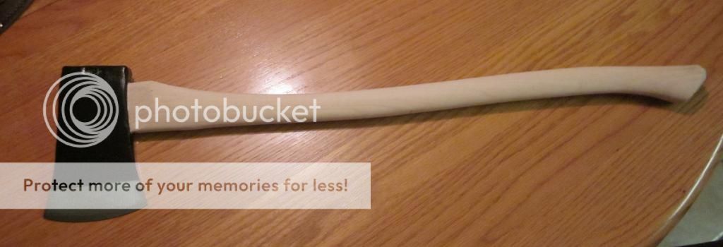

Friends,
I need a recommendation on boiled linseed oil - is there a particular brand or formula you all use? Here's what came in the mail today and thus brings up my question (courtesy of Omaha Knife :thumbup:):

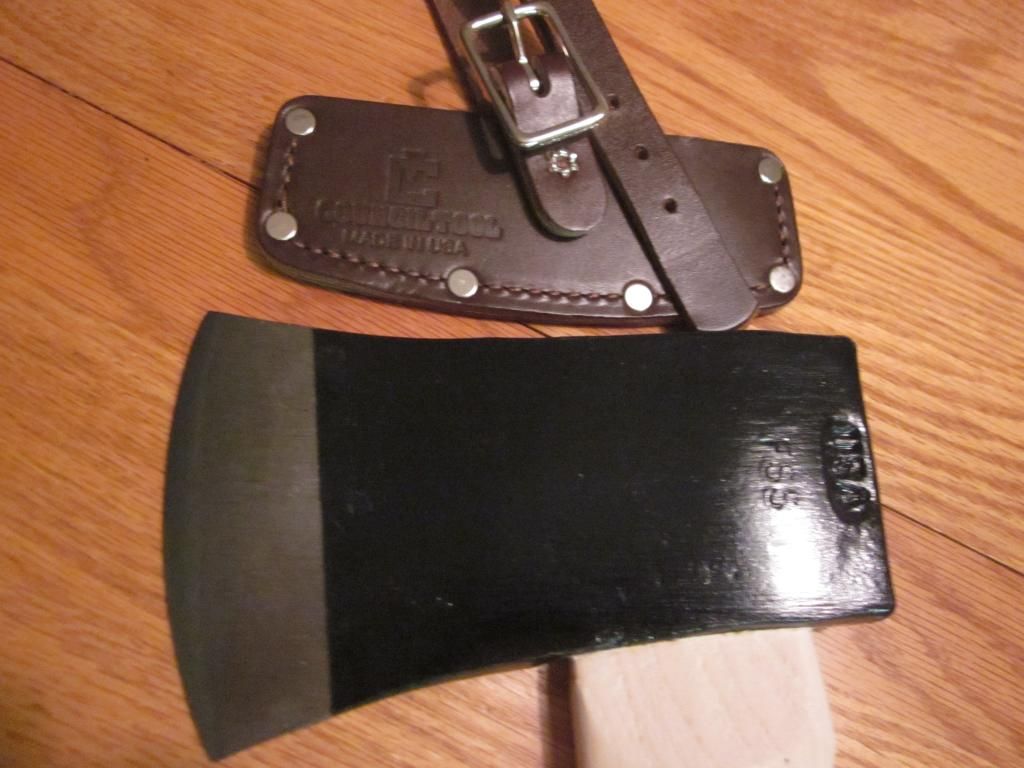

It's a Council Tool FSS with the optional "hand picked" and sharpening service. It is literally shaving sharp, was packed very securely, and is completely impressive! I'm looking forward to taking it out camping in the next couple of weeks.
I almost went with the Council Tool "bad boy's axe" but ended up going with the more affordable "bang for the buck" option.

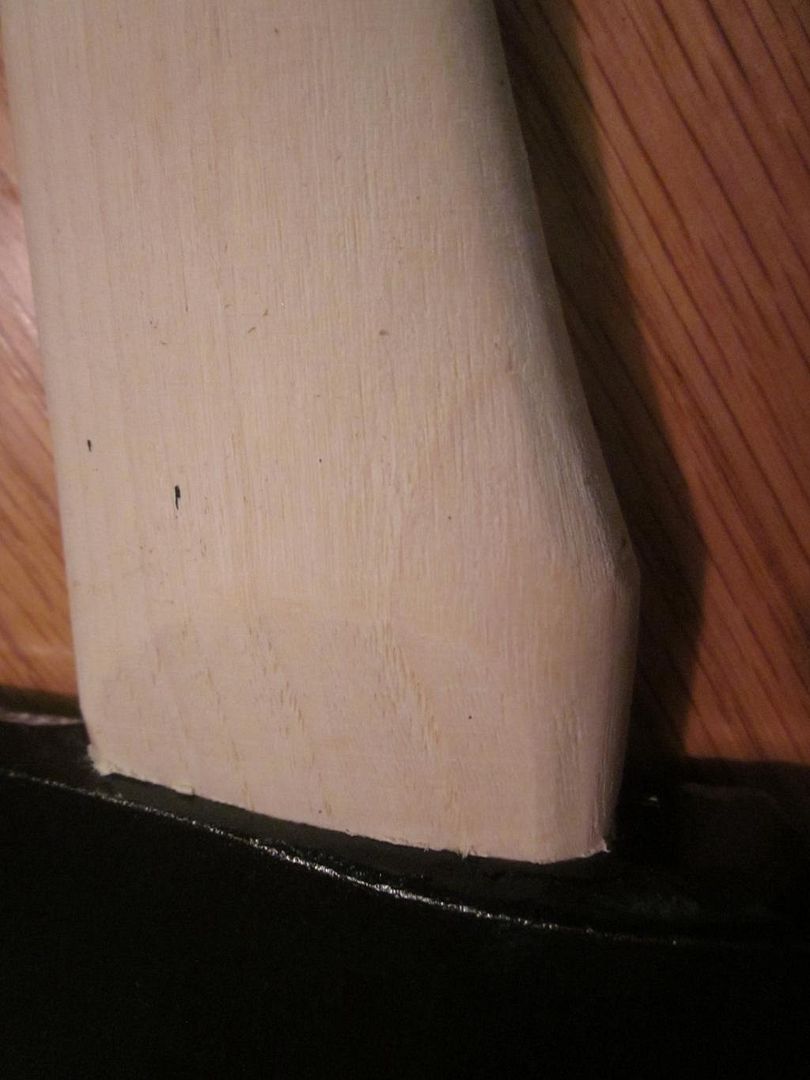

Nice handle, altho for a hand picked one i would have wished for a perfect grain orientation.

Hey looks like CT did a nice job for you there and based on the rings of grain we're seeing on the side I'd say you got awfully good grain if it isn't "perfect". Just get whatever BLO you can find and go for it - let the end grain get as much as it will take.
Agree with MrFixIt and cityofthesouth - use what is readily available to you. But also wanted to complement you an your new toy. That's a great looking axe and the sheath looks pretty darn good to. :thumbup:
