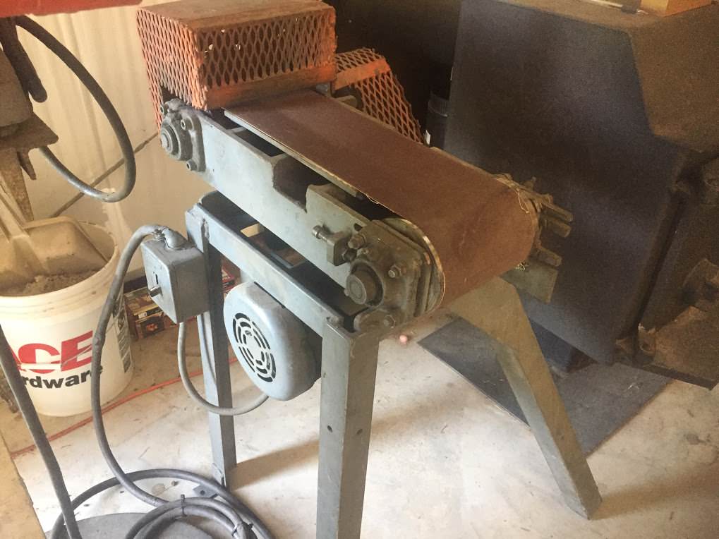

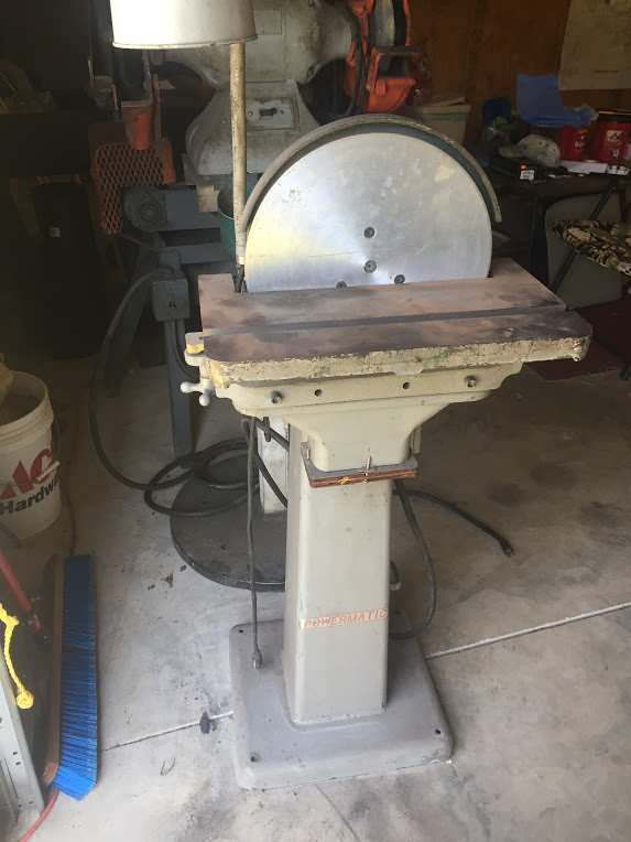

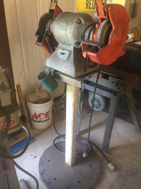

Ok I talked myself out of a buffer, I don't need mirror finish. I see I do not need a vertical band saw , I see I can do the cutting with my horizontal band saw or my Portaband band saws or my plasma cutter . So I am building a 2x72 grinder when the frame gets here. What else is a good idea to have for doing knives ? I have a 4x36 sander/grinder w/6" disc , 1x42 sander/grinder w/8" disc , will have 2x72 grinder . I have a friend who is giving me a forge. I have a equipped metal / machine home shop. This interest in the knives is me trying to create some interest for me to get busy with all my shop toys. Retired for years now and need something to grab my interest. Getting long in the tooth and bored. I may already have all I need till I see if I am serious. Also is there a place to get templates ? Or just buy a couple different blanks and use them as templates?
Personally I'd recommend just getting some paper and a pencil and sketching until you find something you like.
There are loads of patterns on Bob egnaths site though, including a number of loveless designs. Drop point hunters, and bird an trout knives are usually good starting points
Thanks I will look for Bob egnaths . I made 2 paring knives for my kitchen from 2 small files. They work and look ok, but rust over night if not dried after washing. Thanks for input.
