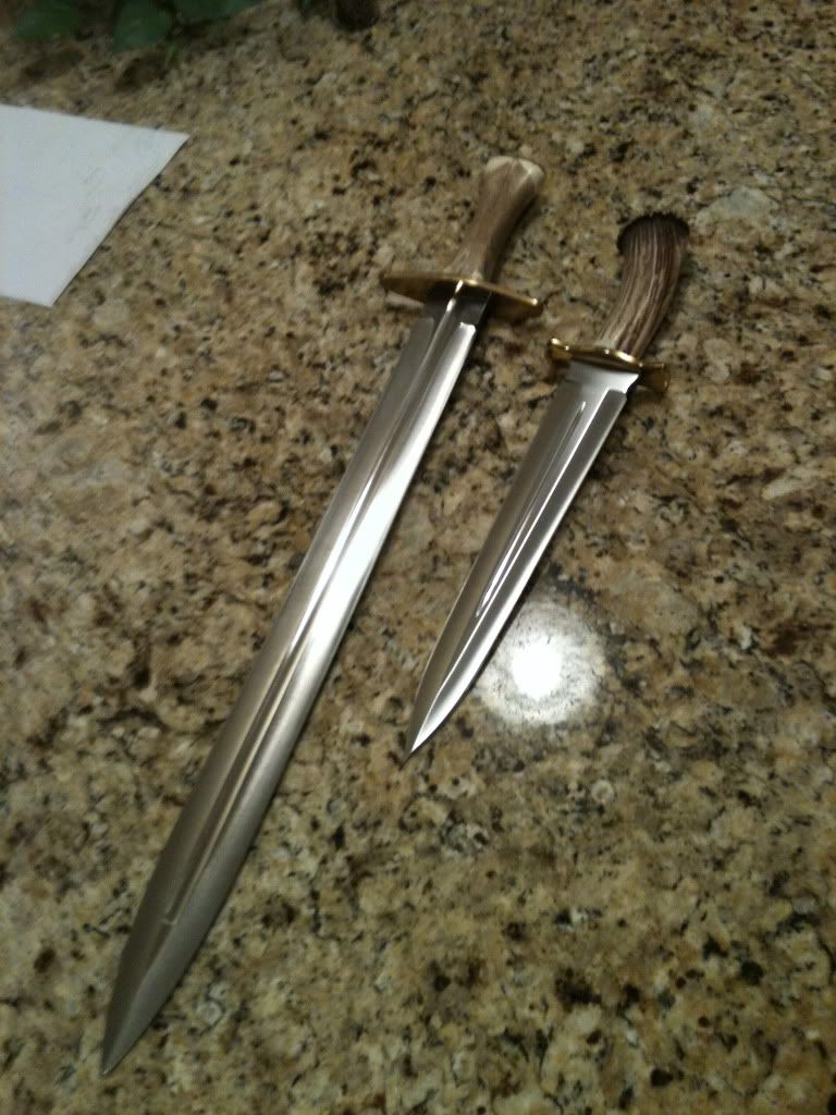

Just got word from Darrin that the blades are on their way back to me. Also have enough 5160 coming for a few more of these, as well as the 3V. Stay tuned. Should have an update on Friday of next week.

Sure, thanks for your interest. I'm getting the proto back on Wednesday. I'm hoping to get it handled and somewhat finished by next weekend. I've got some steel coming in for a couple sale versions, so if you'd like to put your name in and claim one of them, I can grind one out for you as well.

Okay, got them back from heat treat today, and will be working on getting the blade polished so's I can get the scales epoxied on.
I also talked to Jerry Busse, and the word is that I'm not going to be allowed to fill the holes with mosaic pins, since that evidently highlights the feature somehow. So there won't be any holes in any sale items, obviously, although Jerry graciously allowed me to keep the ones in the blades I'm keeping for myself. I'm still going to be filling the holes in these blades with mosaic pins, since I like the idea, and I do want some ornamentation there. I'm a little dubious about the claim that it highlights the feature, since the relevant feature isn't even there any more (compare to inserting a stained glass window into a hole in the wall--it's a decorative object designed to fit precisely into the hole, but does it really call attention to the hole, or does it call attention to itself? I think it's telling that we call a window a window, rather than a hole in the wall, and we sell panes of glass as being windows, not holes in the wall). Out of respect for Jerry, I won't be drilling holes in that area any more, but it seems to me that there's a lot of problems with that argument...
