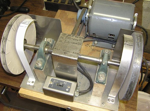

I guess I've got too much time on my hands. From looking at my knives under 12X maginfication, I still was not completely satisfied with the results by using the LAZER, so got to thinking again. I did speak with RichardJ the other day and told him I was working on something else, so here it is.
Under the maginfication I could still see somewhat of a wave in the Edge, so I was not satisfied till I got that out!. I found that using the Lazer was in my estimate about 80%or so better than using nothing at all. I will add here, that there is absolutely no reflection in using the LAZERS on the eyes, as i Hold the edge right at the bottom of the Lazer line. So got to thinking about building a rest to ride the knife across. Can still use the Lazer if wanted, but not necessary at all if I didn't want to use it, after my angle was set.

Now my edge on the knife show's absolutely no waves in it, and is completely polished. I'm very satisfied with the results. I realize that this is not going to be for everyone, I just wanted to share what I've done, in hope's that it may possible be of benefit to someone. It did take me probably about 5 or 6 hours to build the rest to lay the knife on, and I used JB weld to mount a piece of very hard plastic (Starboard) to the metal rest so as no metal would ever come into contact with the wheels. It takes approximately 2minutes to change the rest from the Grit wheel to the Compound wheel, and it is fully adjustable to any angle or bevel that you may want. I believe that using the paper wheels, now my knives are as sharp as they can possibley be using this method of paper wheel sharpening.
Hope it helps someone that has the time to build such a contraption!

Very nice set-up and it looks well thought out. Looks like most anyone would be pleased with the results you achieved.

1scooter, you have given us the "best yet".
Another "whole level" above the lazer.
No batteries and/or reflections from lazer with this set up.
The edges are dangerously bright.
For sure I will be one of the "someones" benefiting from your R&D.

Yes absolutely, they will turn black, from the metal and the compound that you use on them. I'll be glad to discuss it with you sometime. Bmilla325. I know I love it now, even though I don't use the rest all the time, but sure use the Lazer probably 100% of the time.
When sharpening scissors, the rest really shines.

that is a neat setup 1scooter. nice even edge. that would come in handy for sharpening a bunch of scissors for sure.
as long as the angles were the same on every pair you did you could really fly with that setup.
