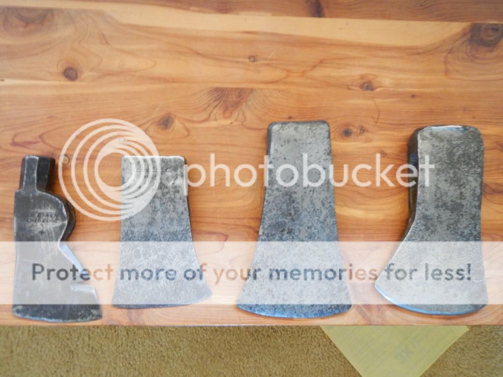

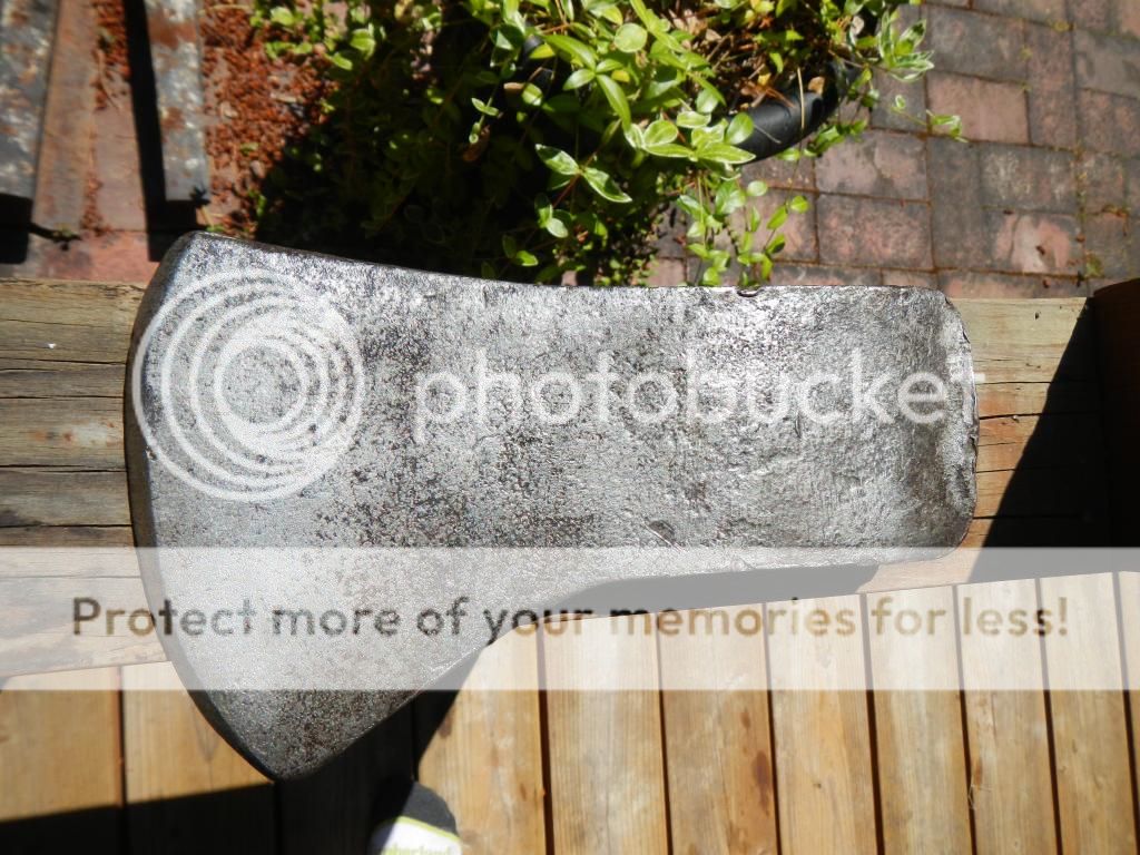

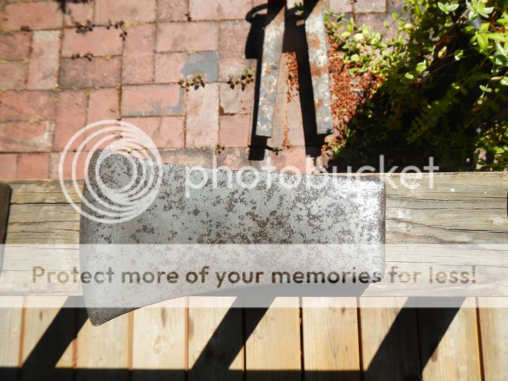

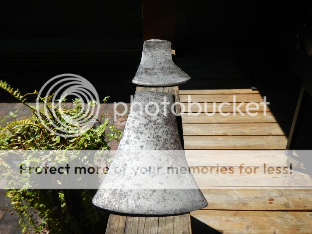

Hey Garry, thanks for the info. I'm still very new to vintage axes and differentiating between patterns.
It came from my old boss' 100 year old ranch in Olympia, WA.. Lots of logging around the area and rafts in the port, so it's definitely a possibility! The only stamp I can see is a very faded Collins stamp I believe.
The heat treat on the poll is also a unique feature of good rafting axes.

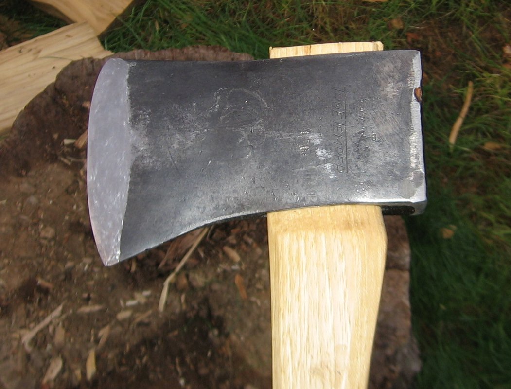

Here's a Rafting Pattern with a stamp:
That one's mine. Loggers turned it into a branding axe.

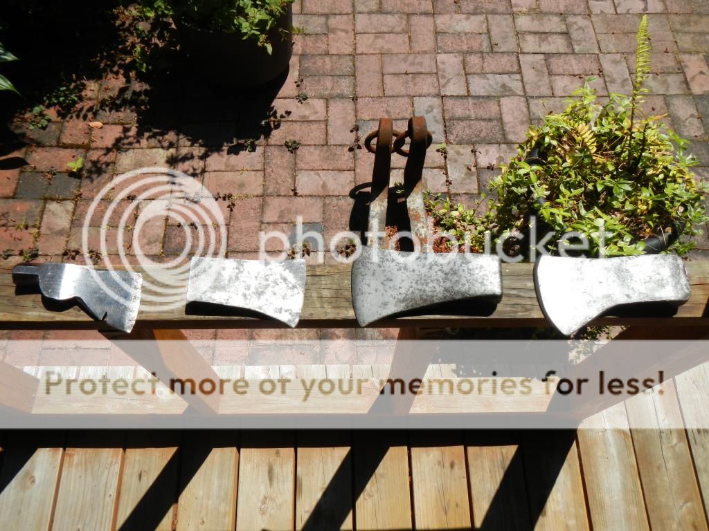

Thanks again pegs. How thin do you grind your cheeks? at the point on your grind furthest from the edge of the bit? Also, I went ahead and bought a 3" brass cupped wire wheel for my drill, and tore into the four single bits I had... Turned out great! Hard to show what the finish really looks like on camera, but it is much better than it was post vinegar bath, and I like it more than just sanding. I really think leaving as much of that patina as possible makes for a gorgeous axe. Here's what I have so far:

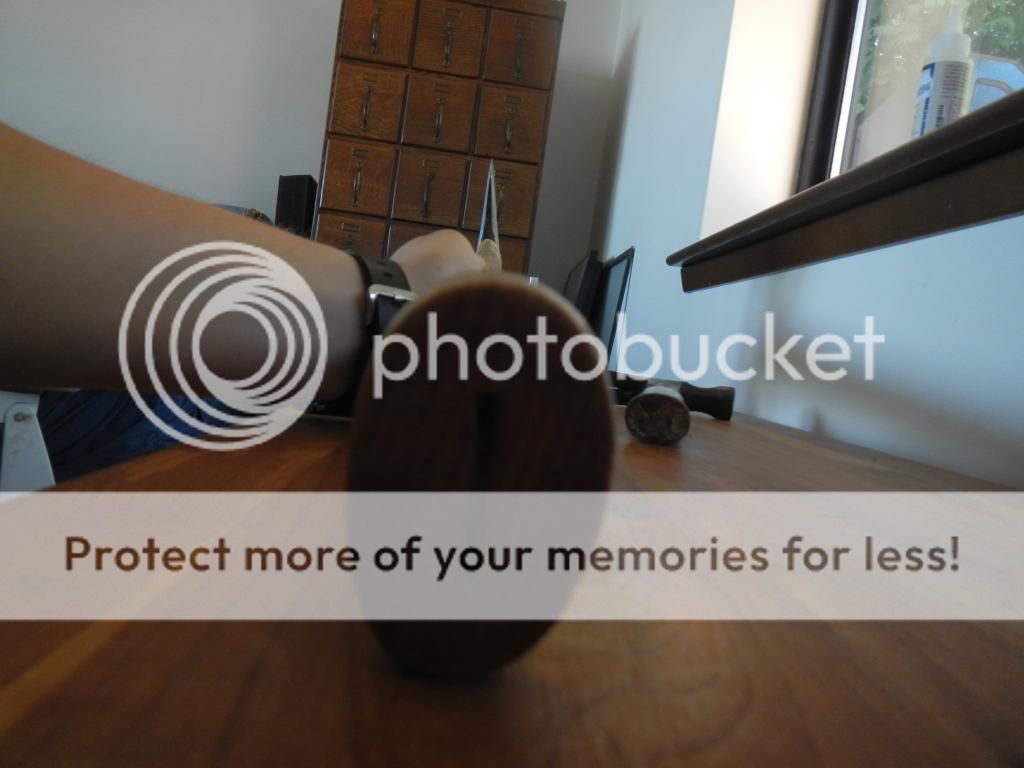

Is the eye really crushed? Or are the edges just peened over, in which case you could file back the lip?
Sorry, referring to post #15.

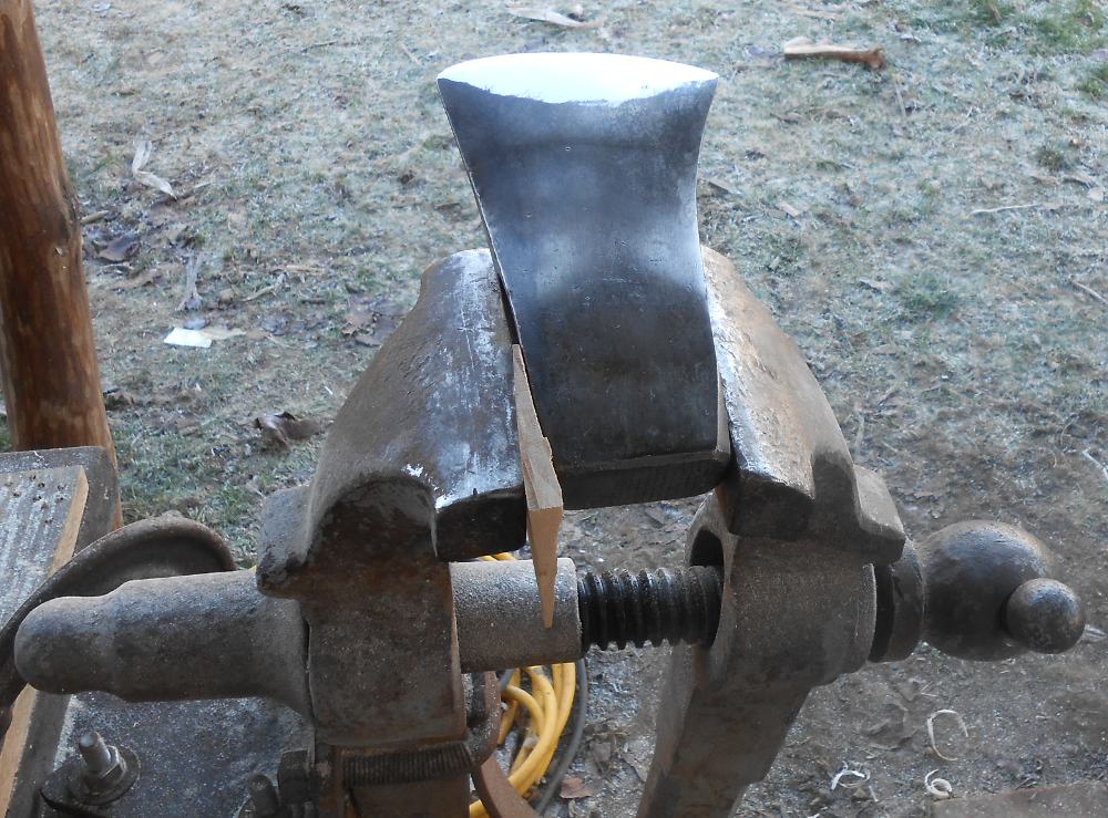

Alright guys... First attempt at rehanging. Tried to rehang my swamping pattern warren... Turned out okay I guess... The head is not perfectly in line with the handle though, as the portion of handle meant to go through the eye was pretty off center. I'm sure if I was more knowledgable I could have fixed it, but it is what it is. Just need to re profile and sharpen now, make a sheath, and get this guy back on trail. Also found an old plumb hammer in my grandmother's garage yesterday.

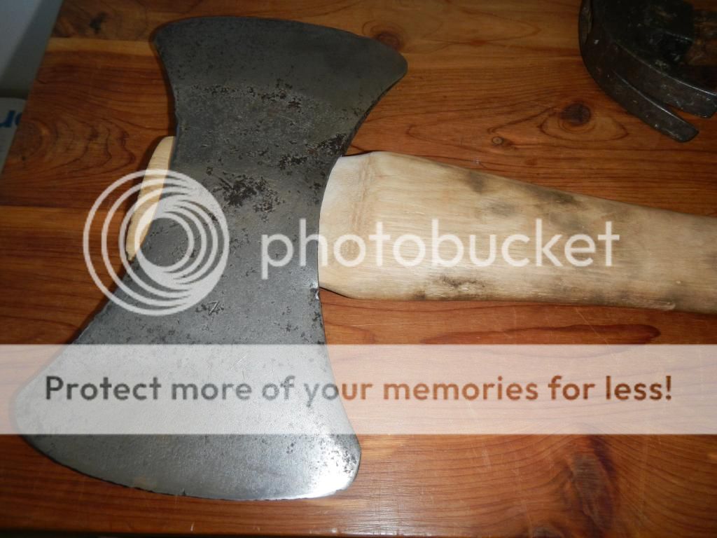

Finished the rafting pattern... and I'm VERY happy with it. I think it looks gorgeous...Damn I love these old tools, and bringing them back to life.. such a joy.
