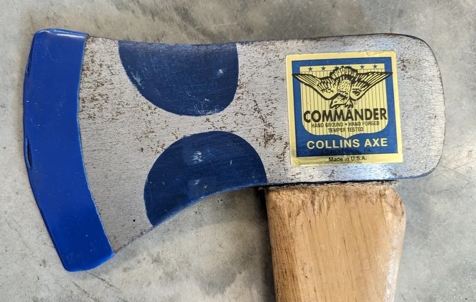

hello, well, is this ironic? can you explain as i don't know that model? ground down phantom bevels are not anouncing quality stuff, but, what is the issue with it?
ouch pressed down handle like that is a sure way to breakage is that the most point of weakness you don't like in it? can clearly see wood chips under the steel, and some teared off wood allready gone from strong assessment with poorly prepared haft not much at the size of the eye ...
right?
The bevels on the Collins commanders ( 1980's or early 90's ) are useless and barely existent , and the heads are a very ugly narrow poll vague representation of a Michigan pattern.
They're basically the polar opposite of this new Warwood which is a good representation of a Dayton pattern with functional well defined bevels.

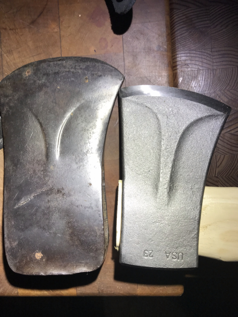

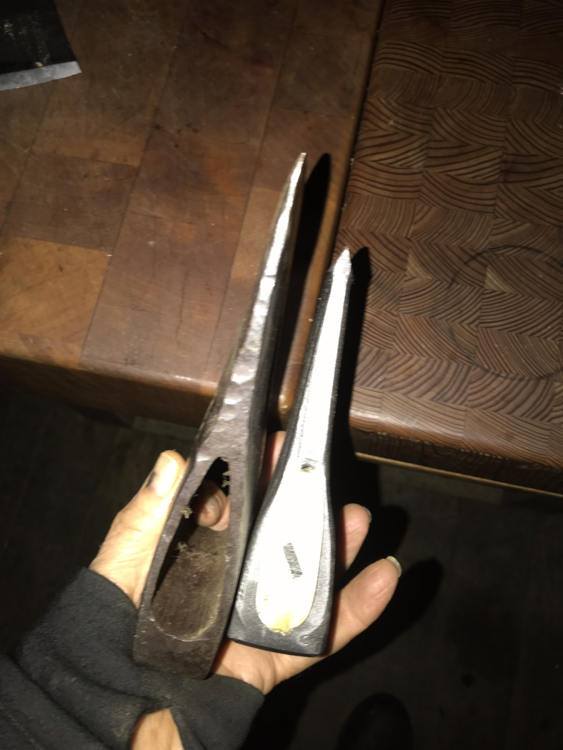

It's a pretty nice axe, but not that close to the Kelly Perfect.
The raised cheeks are about the same height as the original True Temper Kelly Perfect, but the axe head is thicker and softer. And the raised cheeks have a different sweep, as you can see below.
I have a 3.5 pound Kelly that is pretty worn and larger than the Warwood Perfect, which is a 2.25 pound head. The old Kelly Perfect is quite a bit thinner on the outside edges behind the bit, despite being the larger head. On the outside edge, where the cheek sweeps in behind the edge, the old Kelly is 0.21 inches thick. The corresponding point on the Warwood is 0.31 inches thick.
Where the cheek sweep ends before the haft, on the outside edge, the Kelly is 0.41 inches and the Warwood is 0.57 inches.
I don't know the hardness of either head, but the Kelly is harder. I can scratch the Warwood with the Kelly, but the Warwood cannot scratch the Kelly.
The Warwood came with a beautiful haft, with the grain perfectly parallel to the head. The fit was good, and left with a little less than an eighth proud. The bit was fairly sharp, but there was a considerable burr on one side. The balance is nice. It's fun to use.

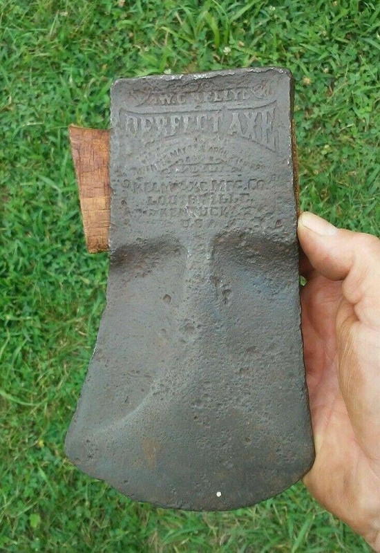

I assume they were trying (and failed miserably ) to base 2023 model on much earlier Kelly Perfect; Your axe looks like True Temper era.
https://www.worthpoint.com/worthopedia/antique-c-kelly-axe-co-perfect-axe-1899815160
https://www.worthpoint.com/worthopedia/antique-c-kelly-perfect-axe-3869895140
That is a BIZARRELY anemic poll, though, I must say. And the bit is real thick behind the edge bevel, so the cheeks could stand some extra grinding.
Modern makers absolutely refuse to make axes that are thick where they should be thick and thin where they should be thin. It's not like the axes that were made that way were all hand forged either.
The only current maker I've come across that does a good job of making the geometry right behind the edge properly thin is Rinaldi, but they're southern European styled axes rather than American. I honestly wish that more makers would take their approach if economical edges were desired. Their edges come with a ragged burr on them that comes off with a few strokes of a file, but that backing geometry is nice and thin like it should be.
