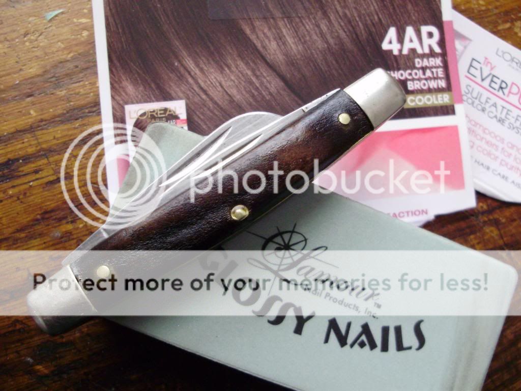

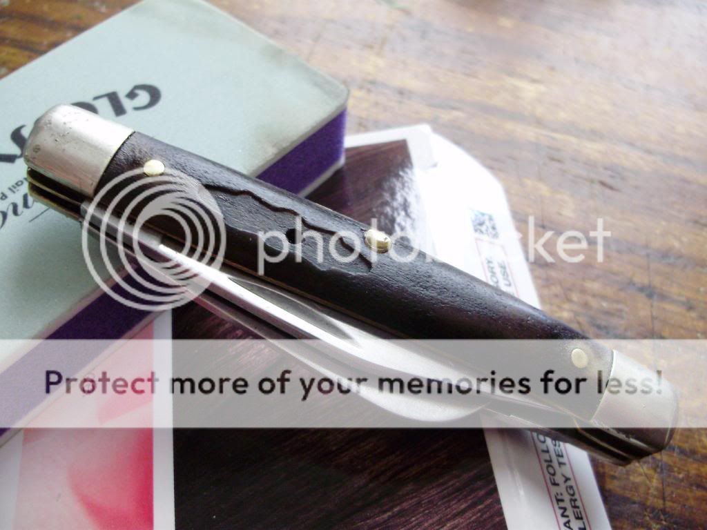

Update:
I figured I had nothing to lose, so I decided to give this old knife a spa treatment. Literally. After a good cleaning, I used those foam backed manicure sanding sticks/buffers on it:
Then I used L'oreal excellence cream 'dark chocolate brown' plus colorstay conditioner. After more buffing and a mineral oil bath, it doesn't look too bad. All this soaking and drying has made one edge of the covers pull away from the liner, though I couldn't get a good picture of it, it's about half a millimeter. Maybe it needs more oil? Unfortunately while I was working on it, I dropped it in the sink with the main blade open, and now there's a bit of blade-wobble. It was a fall of less than a foot. This is why I hate Swinden Key construction!
Some pics of the still oily knife.
I now suppose I'll sharpen it and see how the stainless takes/holds an edge.
