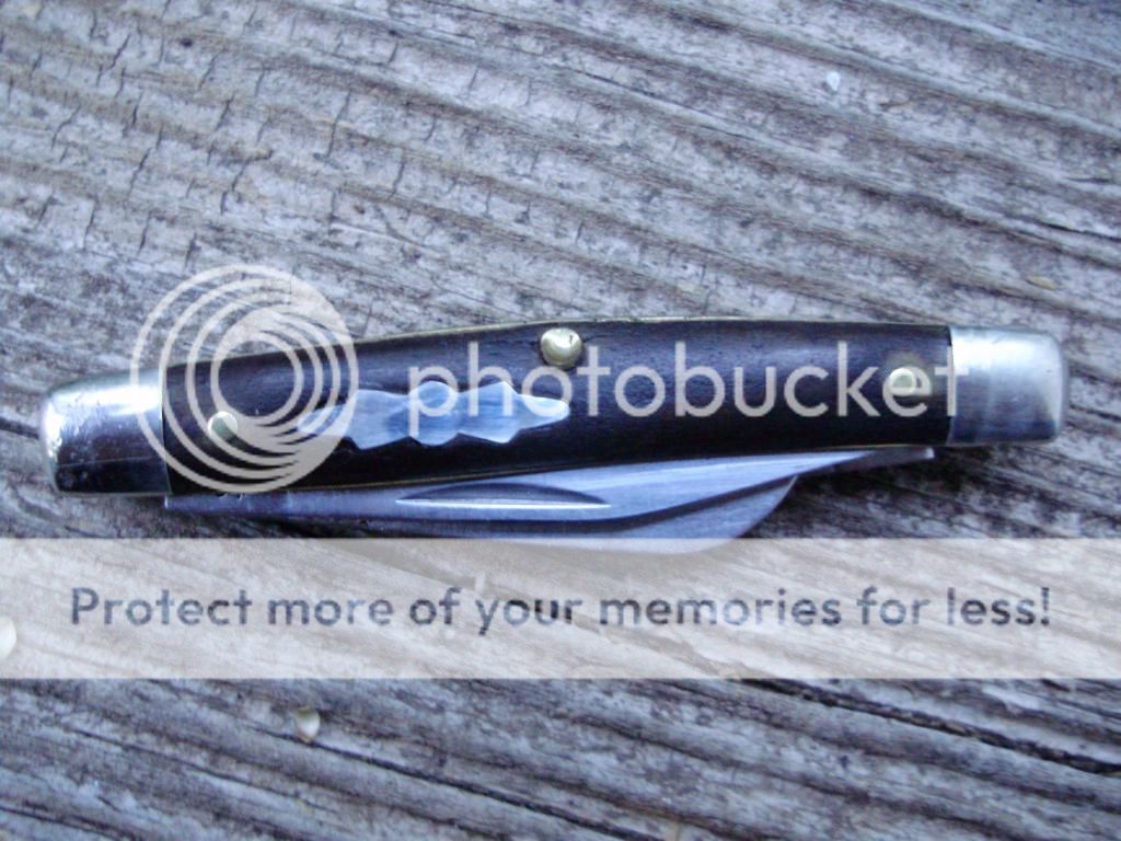

Thanks for the advice, Jon. This particular example is, as you say, an experimental knife. I really don't think I could have made it look worse unless I actually burned off the covers. So hair conditioner, oil, etc. was fun to try. (also, when I say soaked in mineral oil, I mean liberally doused with it, and left to sit a bit and then wiped down. As opposed to sitting days fully submerged, if that makes any difference)

Wax instead of oil. Something to seal and shine the surface without soaking into the pores. I am a HUUGE fan of Sunshine Cloth. It contains both a very fine abrasive, as well as wax. Makes my knives shine like nothing else. I do all parts, blades, bolsters, handles, everything..
Now that you oiled the stag handle, glue wont work. So, if youre feeling experimental, I suggest you blow it out with brake cleaner (which is mostly acetone), or Qtip it with Acetone (but not the type with oil in it as some manicuring acetone), or alcohol, to get rid of the oil, at least so the shield can be glued.

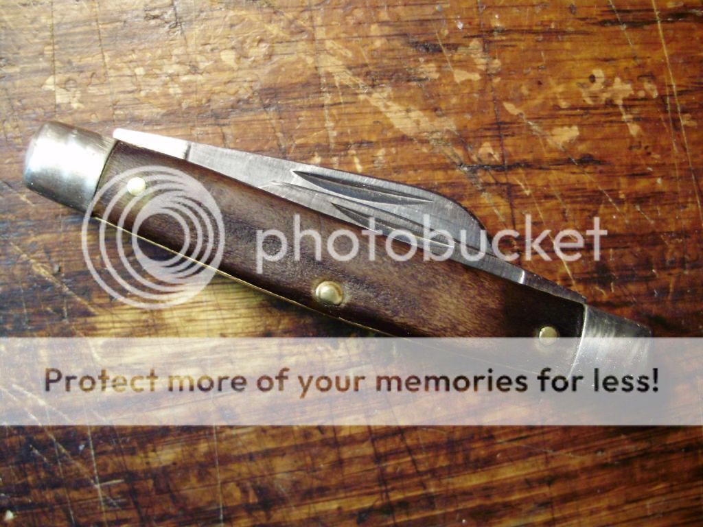

I would agree to give the newly spa-treated covers time to dry and stabilize. You can speed that up by, no kidding, burying the knife in a small jar of white rice. I do this when I absolutely must submerge and wash a knife in soapy water. Also, yes, clean out the shield cavity with a q-tip dampened with denatured alcohol before glueing the shield. As I keep repeating, I am not a cutler, but I am thinking to use 3m clear silicone for the glue. It will adhere to both surfaces, and still be flexible when it vulcanizes. I've used it before with good results in Delrin cavities. If/when I get a shield, we'll see if it has a stud on the back as I suspect, that presses into the stag. If so, that is likely why yours fell out. When the knife was submerged, the stag swelled and then shrunk as it dried out.

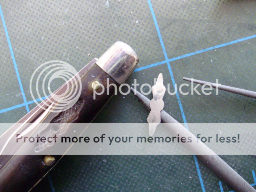

Codger was kind enough to send me some shields, but unfortunately, they don't fit. (He suggested I do a shield giveaway, so that will probably happen, unless I come across someone who needs that particular one first) Thanks again, Codger.
So I thought what the heck, and looked through my odds and ends and scraps and found a thin little piece of silver left over from an art class and just freehanded it.
I'm pleased with it. It's not perfect, but it looks OK if you don't look too close.

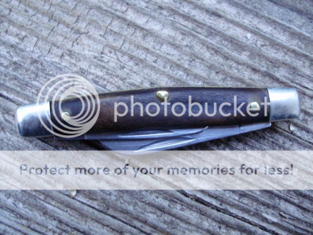

A little warmer lighting:
I'm still amazed what a quality hair conditioner can do for stag. :)
