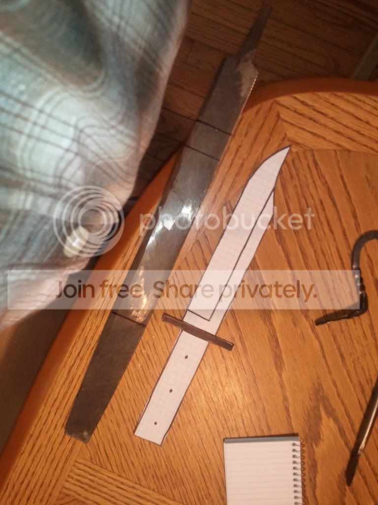

I would have to have some of the handle overlapping the tang then. Since the where the handle begins, the file starts to taper from 1 1/2" to 1".
It would help with my visualization if you laid the file next to your design. Alterately, you could leave more of the handle at the back of the handle. Allow the handle to swell out at the back.

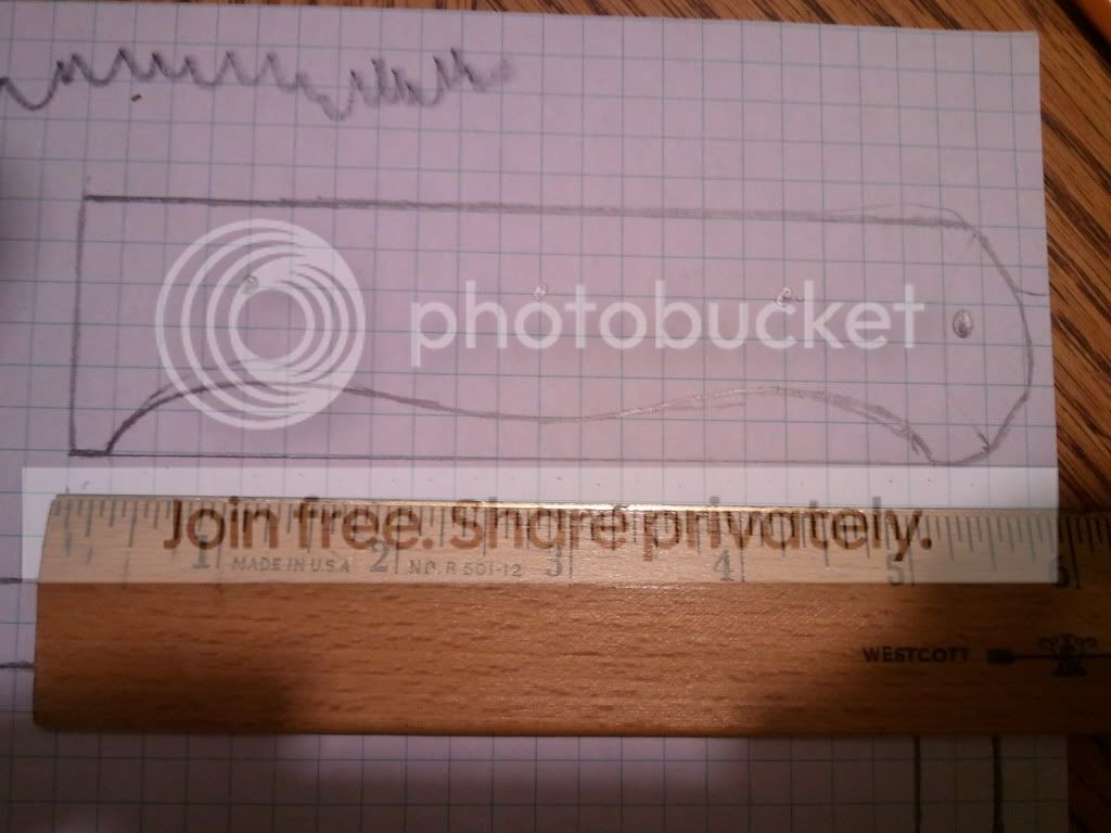

Hmm, I'm having a thought about a traditional knife handle. Like the one of the Svord Tom Tempsky Bowie. I would use a brownish g-10 or micarta to add to texture, and I may add a gaurd to it depending on how the style is goign to go.
So I got my new handle design sketched out. It's a good thing that I cut out the handle from the blade.
Alright instead of dealing with that annoying taper fro 1 1/2" to 1" I just switched it around to the side of the file with that pin.
This is to scale
