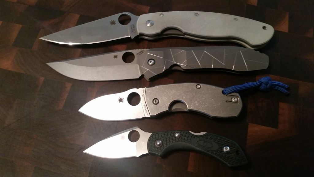

After much anticipation I finally received my Nirvana today!
Here are some pics and initial thoughts.
First of all, this thing is just jaw droppingly gorgeous. The stonewash finish alone would look great but the milled pattern really brings it to the next level. The fact that they were able to seamlessly continue the pattern around the entire handle is quite impressive. I believe the blade finish is an acid stonewash and it's dark, worn look matches the aesthetic of the handle nicely. The clip is stonewashed as well. Only the milled lines, clip screws, and pivot hardware have a shiny finish and I love the contrast.
I don't have a scale at home but the knife certainly has some heft to it. It's definitely heavier than my Military. Curiously, the handle is quite a bit thinner than I expected and they did a great job of fitting as much blade into there as possible. I would imagine that some people might not like the thinness of the handle, but I see it as an advantage for a nice slim profile in the pocket. The blade also features a very nicely jimped thumb ramp that adds some traction to the smooth and slender handle.
Deployment is extremely smooth and the blade flicks out with impressive authority. The downside of this is that the lockbar has a considerable amount of stick. Even without flicking the blade the lockbar is sticky. When flicking hard, disengaging the lock has sometimes required two hands. It's an unfortunate downside to an otherwise superb knife.
Overall, so far I'm very impressed by this knife. I've followed this one closely since it was first announced and it's clear that Spyderco had to overcome some large hurdles to see this model to fruition. The lock stick issue is disappointing but I'm not sure an insert would even be possible on a thin integral like the Nirvana. I suppose the lock surface could be carbidized but I don't know how that would affect production and the cost. Either way, I won't let it keep me from enjoying this wonderful offering from my favorite knife company.
Update:
After about two and a half days the lock stick is gone. Lock bar is still a bit stiff but maybe my thumb just needs to be a bit stronger. :D I disassembled the knife, which was ridiculously easy, cleaned out the excess oil, applied a drop of 10Wt nano oil to the bearings and a miniscule drop of 85Wt to the detent, and reassembled. Wiped the lock face thoroughly and put on a light coat of Sharpie. All I can say is wow. Even smoother than before with no traces of a sticky lock.
