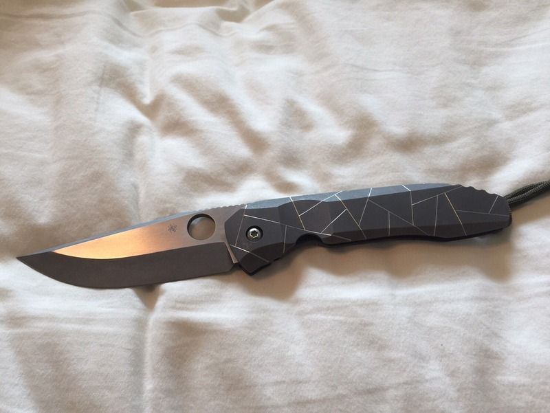

Mine arrived while away for the 4th. Awesome looking, very smooth with a great blade shape. The contoured area below the pivot offers a good purchase area if you need to choke up on the knife, The egos are pretty darn good, the gimping is ok. The over all ATD is in step with Taichung produced spydies, very nice. Mine has lock stick, nothing heinous but it's there and the edge was pretty dull IMHO.
My lock stick is horrible. To the point of having to put graphite on the tang. Something I haven't done on a Ti framelock in years. :mad:

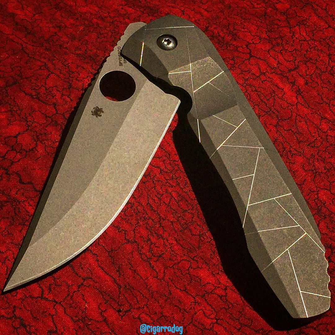

The amount of Lock stick is the only sticking point(pun intended), to an otherwise superb knife. I tried cleaning, graphite, sharpie, opening and closing, etc. It's a little better, but still problematic. I tried removing the pivot to remove the blade for thorough cleaning. One pivot loosened easily. The other would not. Instead of being smart, and stopping, I kept trying, which partially stripped the pivot head. I called Spyderco, and the Rep is sending me a replacement. Now I have to figure out how to remove the damaged pivot. Any constructive thoughts would be appreciated.
Other then the lock stick, the knife performs as if it were a custom. Here's a post processed image of my baby.
