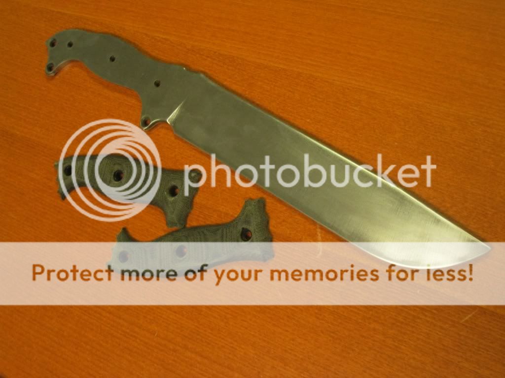

Well, I knew it was bound to happen ... I finally began working on my NMFBM.. So far it has served me very well and is a blast to use.
Now I need to make it proper and modify it to something more my taste..
I am doing all the work myself on this one..
So far I drilled out the handles, stripped it , and am now in the beginning stages of applying a full hand satin finish..
My main question is ... What type of bolts are best for securing the handle slabs back on the blade.????. I want to stray away from the compression rivets that Busse uses. After throwing the NMFBM a lot the handles began to become severely unaligned. I may also epoxy the slabs on..
Thanks for the help :)
MY NMFBM in its current state .... I have a lot more work ahead.. :thumbup:

For the handle bolts I would recommend using stainless steel 5mm countersunk hex (allen) socket head screws (12mm long). The metric countersunk heads (10mm dia) just fit the original countersunk holes on the micarta slabs just perfectly giving a near flat finish rather than the deep holes the pressed rivets leave. Also the 12mm length is perfect so you don't need to trim these. They are standard screws your should be able to buy off the self on a good stainless steel supplier.
To hold the two screws together (one on each side for a rivet hole) I would use the original tube that was drilled out of the handle (provided that you haven't already thrown them away). It's already the right 1/4 inch diameter and it's just the right wall thickness for the inside diameter to match the thread which needs to be cut.
All you need to do is thread the inside of the tube to 5mm metric using a thread tap then trim the old flared ends off which should make it slightly shorter. This shorting in turn should then fit perfectly in between the handle slabs. So in effect you will get a threaded tube with a screw on each end to hold everything together. If you have already thrown the old tube rivets away then you can get the tubes from 'KnifeKits.com'. It will be the standard 1/4 inch tube they sell as Thong Hole
Tubing.
Of course you could use imperial size countersunk screws. You just need to choose the appropriate size screw and thread tap to suit. Do this for the other rivet holes and you should have a very smart looking handle with hex screws.
To finish off I would recommend using Loc-Tight thread fixer to stop the screws from unscrewing off from heavy vibrations that might come about from chopping. I would recommend using the Blue Loc-Tight so that your able to remove them for cleaning or maintenance. Don't use the Red Loc-Tight which is permanent and is very difficult to remove if it is ever possible.
I hope this helps you (or anyone else that may need screw type rivets).
Cheers.
