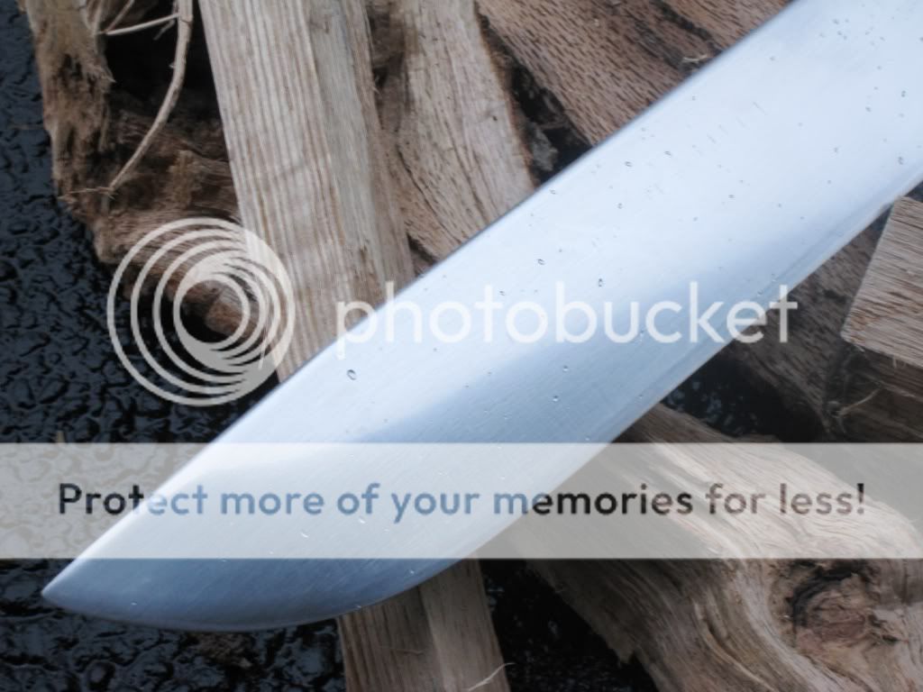

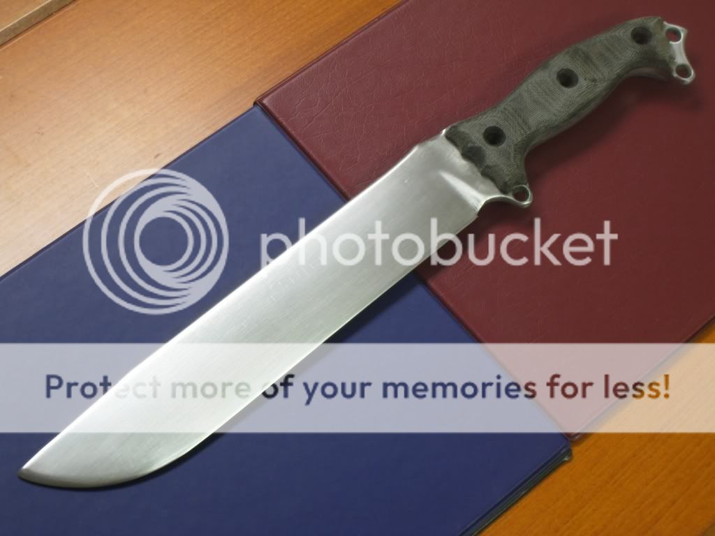

UPDATE !!
Well,, I have just about finished up the NMFBM ... . TOTAL TIME SPENT a little over 9 hours of work time....
I am beat ............. I need to clean her up now.. was a bit sloppy with the epoxy :o
Maybe I'll post pics of the near finished product tonight..
also I decided to put a zero/conxex edge on it..
Almost done .. I still need to go over the blade with 2000 grit sandpaper and clean off some epoxy from the blade and handle. . No bolts either ... hmmmm ?
Looks great!! Keep us updated, and get some more pics. :cool:
Here are 2 more pics...
I decided not to use any bolts . Just a healthy dose of metal/cement epoxy to hold on the handles ..
During the day tomorrow I will take better pics in natural light.. Its very hard to take a proper pic. of this blade otherwise..
ALSO ... REMOVING all the factory grind lines by hand was a chore in a half to say the least ...

Yep ..... things changed . :thumbup::thumbup::thumbup: :cool:
As you can see I simply said "I decided to put a zero/convex edge on the blade" That means I "decided" to change things up ... Understand??? :confused:
I'm curious why you decided that? Too much extra work to re-grind? Figured you could always regrind it after some abuse? Figure thick stock + infi + zero would hold up fine?
Grinds are interesting to me, because I never really figured they mattered very much. And I always thought there were two: Chisel and V. I know a little more now... But I'd be intested in your decision making process so I could be smartened up more!
Looks great by the way! 9 hours? Man...

Yea , I gave it more thought. It seems like the V grind gets dull faster that a zero/convex . I found my self touching up the edge very often . On my zero/convex Busses I only need to go over the edge if there is damage. Figured I can always go back to V grind if need be.
9 hours is about right.. Most of the time involved nothing but hand sanding with cloth/mouse pad and sandpaper.. Stripping the thing took over an hour also.. This sage was very difficult to remove..

There are thin and thick variations of convex and V grinds. A thicker V would obviously take more abuse than convex and vice versa. But given the same edge thickness the convex is more durable and easier to maintain. This is based on my personal experience. Others may disagree.
I use to sharpen many countless knives on my trusty Edgepro that turn out perfect high polished V grinds. I find that the more acute angled V grinds will take on my many tiny little rolls when used hard. This happens very rarely when I use the same thickness convex edge. Convex edges will obviously also take on little rolls when ground too thin just like any other edge.

Here are more clear pics of the current state of my NMFBM ... Its been fun .
. :) I still need bolts. They are on order .. :thumbup:
It is looking great UJ. I can see the high gloss polish finish on the surface of the whole blade :thumbup:
