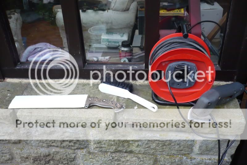

I do a lot of chopping and prefer to smooth the grip rather than wear gloves. What I do is use a triangular shaped sander to take the rough edges off the grip so that I retain a uniform pattern but the feel of the grip "in hand" is smooth. I did this on a TTKZ and the pic of the gear I used is below.
Try and do this outside and allow for prevailing wind as the dust off the grips you don't want in your lungs. Use a mask if this helps.
