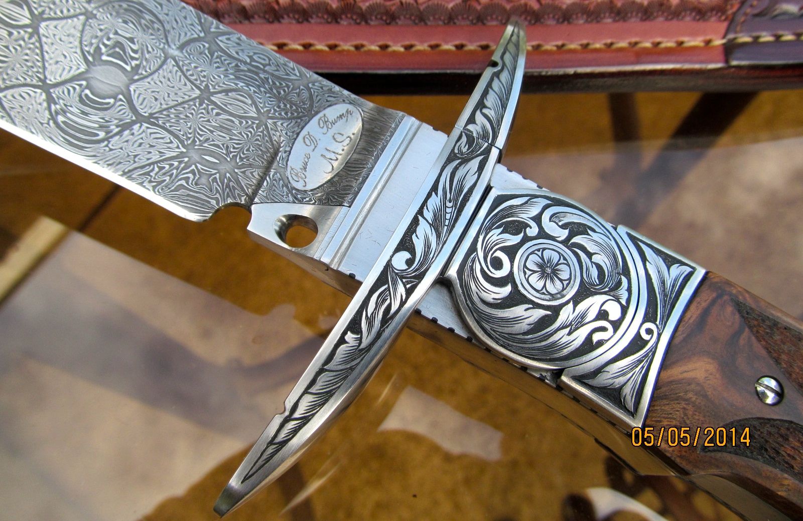

Of course the clever guard takes center stage. As it should.
I'm also liking the subtle details: How you left the choil and fluted area polished, and the clean checkering.

When I first saw the "joint" in the guard, I said "wtf", but when I saw the swinging
guard, I said, "WTF!!!!!".:eek: Bruce, where do you keep coming up with all your unique
designs? Amazing.

Is the whole blade built from a single piece of a damascus steel or is it built from a piece of damscus steel that was joined to a mono steel at the ricasso?
Or is the damascus steel was wisely covered with a mono steel starting from the choil and the ricasso?
Or is it just the differential etching technique that was finely done at rhe ricasso?
Duh .. so sorry for the stupid question, Bruce .. but I'm just very curious .. and thanks in advance :o

The Damascus blade has a 3/4 length tang and a mono 416 stainless frame. You can see where the blade mounts into the frame in this picture at the ricasso area. There are four 3/16" stainless pins completely through the tang and the frame from top to bottom to marry the blade solidly to the frame. The stainless liners are on both sides and also peened with several pins for further rigidity. There are no rules with this Bowie.
I seen the joint on the guard but I wasn't expecting that, stunning and refreshing to see something new.
