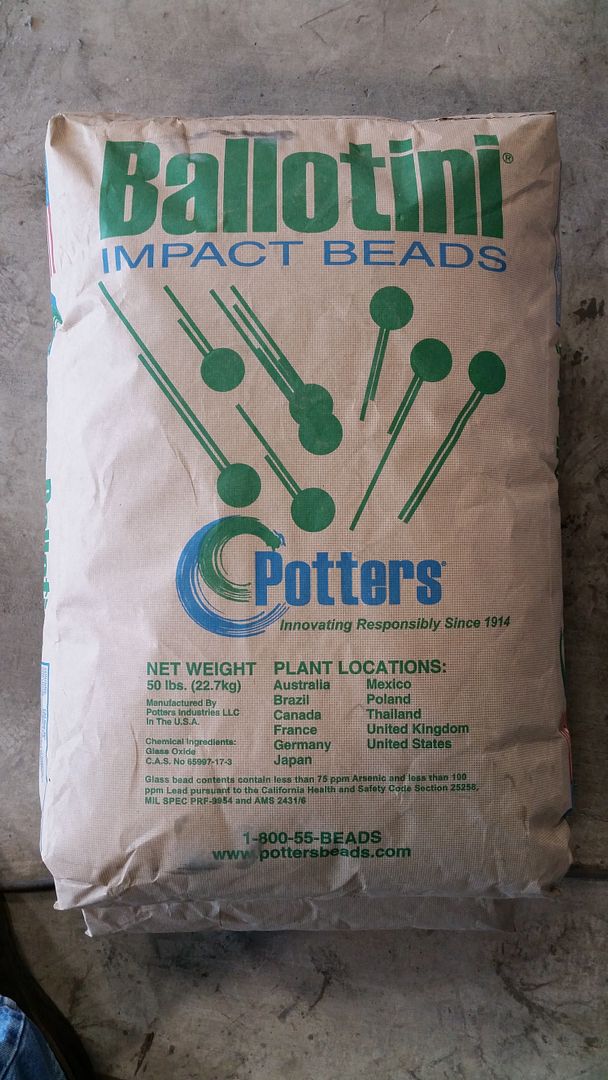

No turning back now.
That is beautiful, I'm going to have to take a couple of mine to the blasting cabinet to give them the same treatment.
Judging from this one and the BT6 thread the current CG INFI blades seem to have a much higher level of finish under the coating than past blades. Looks awesome!
What would happen if you skipped the Stripping part, and went straight to blasting ? With the coating still on.
The end result on the blade itself would be the same but I strip them first so I don't have to get aggressive around the handles. The less blasting I have to do there, the better.

That bead blasting looks so easy it has tempted me into looking to a cabinet but I can't justify the expense for making my CG knives look pretty.
The bead blasted finish looks great clampdaddy. Very very sexy!
I've been debating the same thing. There are some fairly inexpensive blasters I've looked at but I don't know enough about blasting. Not sure if I'd trust myself, or a low quality blaster with my Busse knives.
