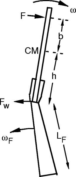

By the way, you might be interested in this diagram. It represents a forearm and wrist swinging a "beam" that's subjected to a striking force:
from Rod Cross (2004). "Center of percussion of hand-held implements" (PDF). American Journal of Physics. 72 (5): 622–630.

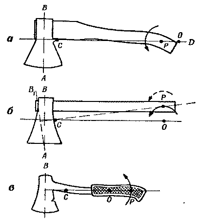

I haven't seen "center of percussion" come up in your theories. It's mentioned in this article from Russia (which also mentions that the center of gravity is usually located at the "barb" of Russian axe heads):
"...At the moment of impact to the ax is applied resultant force resistance tree somewhere in the middle of the blade, for example at point A (Fig. 1) in the direction of A (the so-called line of impact). Because of the center of gravity ax ax handles (u. t) is shifted away from the line AB. Usually it is situated in the barbs (point C in Fig. One). If the ax fell down before impact, all while maintaining a horizontal position (without rotation), then the moment of impact due to different n. ie the line of impact he would have spun down the ax handle clockwise and working, wanting to keep the horizontal position of the tool, felt the blow on his fingers. To avoid this, before hitting ax report such rotational motion counterclockwise so that it offset the ax ax handle to turn down. Then after hitting return in the hand will not. The result of adding motion ax down and required rotation counterclockwise rotation will turn around some point O located on the perpendicular to the punch line, which passes through q. that instrument. This point is called the center of percussion."
from http://survinat.com/2014/10/construction-and-rafting-number-1/

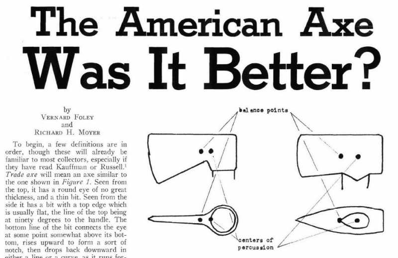

Here's an analysis of "center of percussion" which ties in with the topic of this thread (polls vs. no polls):
from Vemard Foley and Richard H. Moyer, "The American Axe: Was It Better?" Chronicle (Early American Industries Association) 30 (June 1977), pp. 28-32.
According to this article, one of the hypothesized advantages of the polled axe is related to the side-to-side vibrations that occur when an axe hits the wood. The authors tested some actual trade axes and found the center of percussion (for the side-to-side vibrations) was located at the front of the eye. When they did computer modelling for the trade axe design, they got the same result. When they tested more than 50 American axes, they found that the center of percussion was located at the center of the eye for almost all the samples. The authors thought that this could lead to more unpleasant vibrations (or stinging) for the poll-less axes, since their handles are situated with more distance away from the center of percussion (with the maximum vibration at the back of the handle).

Do you have a link to the complete article? I personally have some reservations about their assertions and would like to see how they're arriving at them. A shift up or down in the eye seems unlikely to cause a noticeable difference in experienced shock. Shock felt in the hand results from the waves traveling down the length of the tool and the nodes in those vibrational waves are where you won't be experiencing that shock while the peaks in the waves are where you'd feel the most. It's unclear to me how moving that center up or down will alter the wave form along the length. More mass in the head will soak up more vibration than a smaller mass will, though. I'd similarly be interested in their definition of the center of percussion, as there's often confusion over the term, as noted in the center of percussion article you linked to. The term "center of percussion" tends to get tossed around with "sweet spot" which is usually actually what the article calls the "node of the
fundamental vibration mode."
Ultimately, though, the CoP doesn't apply to the dynamics that I've been discussing so far, which is why I haven't mentioned it. I've been talking about rotational forces--not vibrational ones.
