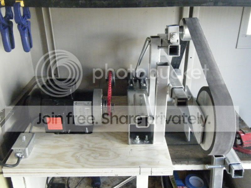

Hello, still fairly new to knife making but very serious about getting a shop set up, so with that being said I am looking for quality tools and trying to get everything I need at once. As much as it pains me I am on a budget and think a grinder may be a great way for me to save some money. I like the KMG grinders and in my shopping I ran across plans for the "NO WELD GRINDER $25" is this a good piece of equipment after it is all said and done? Any guys here who have built one? Is it a P.I.A. to construct? Looks much simpiler to follow plans and do a bit of mig welding on it to me. Has anyone welded one of these frames up? The final product after all the hardware is on looks a bit crude to me, and I think a guy could spend a bit of time measuring from the plans and do some mitres on the tubing opposed to drilling a 1000 holes and clamping and bolting the assembly togather and make a much cleaner and safe machine. Any guys taken this path? If so I would love some feedback or even a pic or two of your machine. Are the plans worth the $25 ?
First of all..the noweld grinder and its plans are a very good deal..the machine works wonderfully, the plans are very explanatory and if followed you will have a very good pc of equipment. Now..if you want to weld it up as you say..then build the grinder per plans, tweak it a bit over a several day period if you feel the necessity, then tack all joints or appropriate pcs together, try again for a few days..then weld the whole thing up. You still need all the pcs with the exception of some of the bolts and the 1/8" x 1" straps.

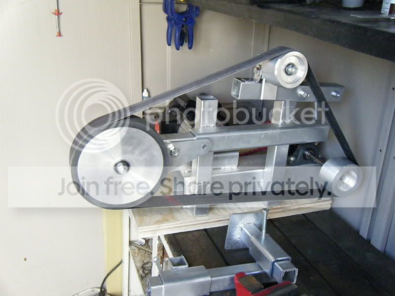

You asked about welding it up, and some have made suggestions on tweaking it as you find tune it and then tack weld it, tweak some more and then finish weld it up. What they didn't say, but implied, is that "yes", quite a few members here have welded this grinder up and are very pleased with the results. I just wanted to clarify that it has been welded up by quite a few individuals.
Thanks, I am ordering the plans primarly for the materials list and motor info. I am thinking of constucting one with dimensions from the plans but using some heavy plate steel to replace a good portion of the tubing and jointery. I studied pictures of the no weld and pictures of the KMG and instantly had a mental image of a much less complex frame that I want to try to execute. I more comfortable buying the plans hearing some of the people here are using machines based off these plans. Thanks Alot for the feedback!

Thank you for posting some pics, and finally someone that welded one without buying all the bolts and making it look like an erector set. Thanks for the pics bikermikearchery and swace!
