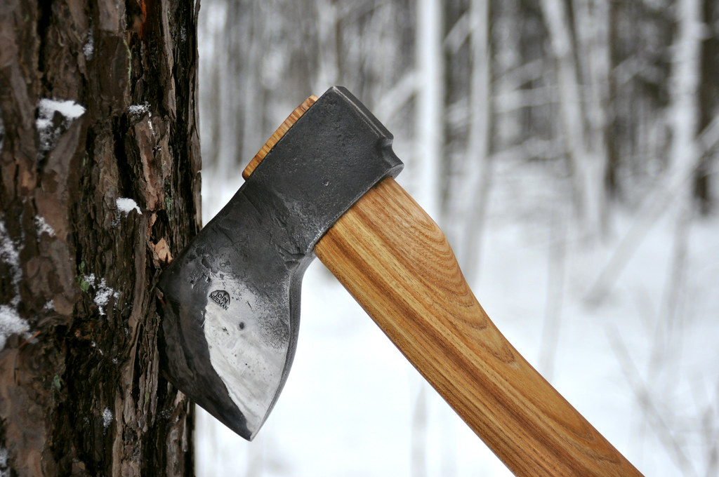

Traditional North European woodworking carpenters axe. Laminated carbon (0,8%) U8A steel.
Turpentine, beeswax and linseed oil mixture for the steel as the treatment for anti rust. 3 1/2" face.
Rockwell 60 (HRC). Linseed oiled and beeswaxed 18" elm wood handle.

That is a very handsome axe, nice work. Is the shape of the poll stylistic or is there some function to it?
Great axe! Nice! The smitty´s marks are good to see... Seems to be hammered forged, maybe hand forged. What do you think?
Kind regards
Hi. The axe is made by me (wood and leather) and by my friend blacksmith John Neeman. We will soon have a web page of all of our tools. Yes the axe is done by hand hammers, hand forged 100%, we do not use a pneumatic hammer.

Gorgeous! Grain alignment is off, but I doubt it would matter too much in a short piece like that and elm is notoriously difficult to bust.
