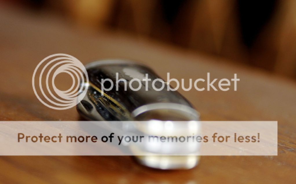

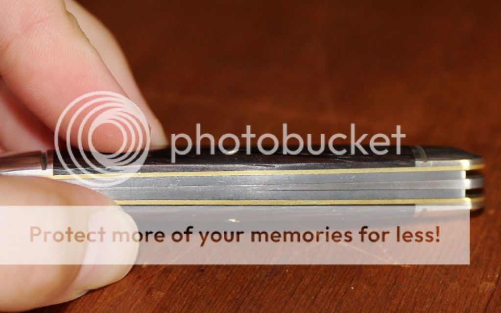

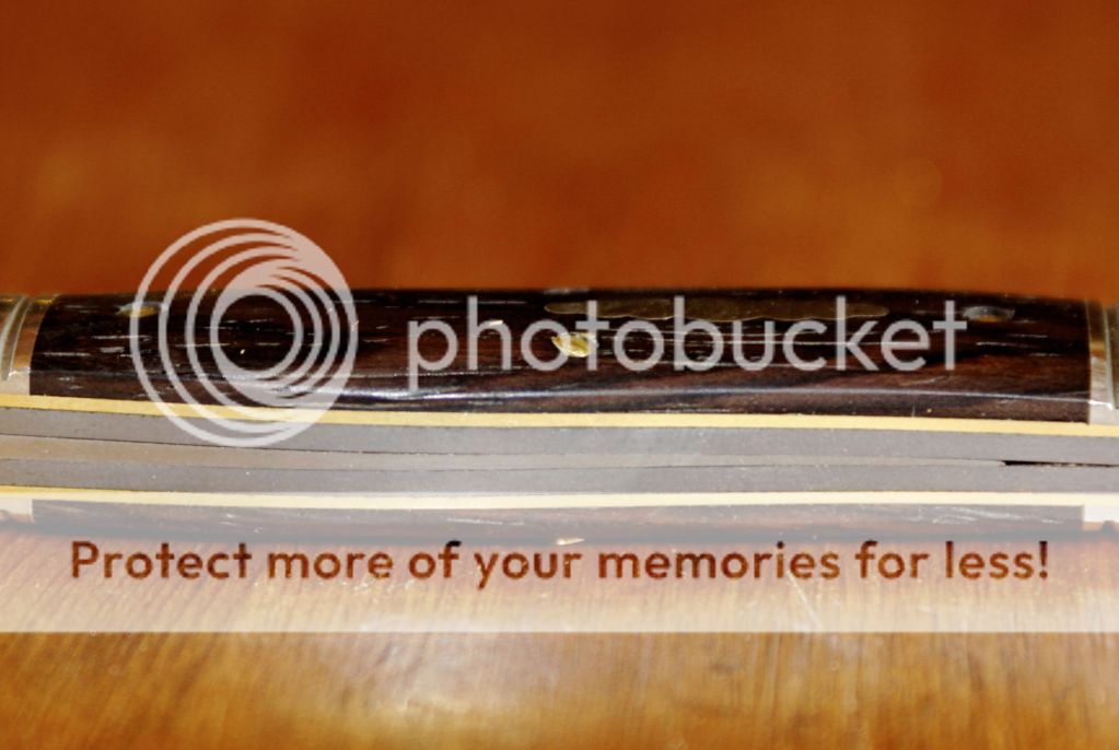

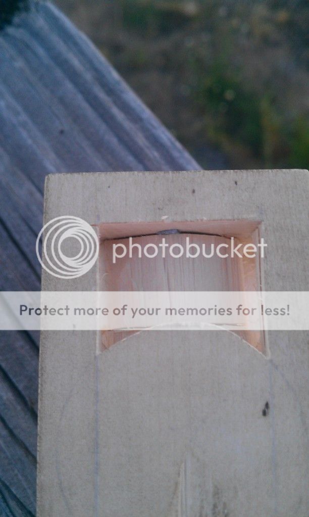

I'm generally not much of a complainer, but this is really getting to tick me off. The pin that goes through the springs on my Geppetto whittler is starting to deform and stick out at a strange angle. When I got it three weeks ago the pin was perfectly smooth on both sides, no snag anywhere. Other than cutting up one steak, it has been used for nothing but whittling. I started to notice it after ther first week but thought it wasn't a big deal. After the second week I did a slight sanding job to smooth out the edge on the pin so it would quit rubbing on my hand. It was sticking a hair under a sixteenth of an inch. I thought this would take care of it...it didn't. The pin is sticking out again and now I'm just mad at it. I usually like to handle things like this myself and I've never sent back a knife before so I don't know if I'm justified in doing so. Has anyone else had this problem and how did you handle it?
Ben
P.S. I've got fairly burly hands so don't tell me I need to toughen my mitts up.:) Those are my wife's fingers in the last picture.

From your last picture it looks like the pin may have rotated clockwise. The pins' high point on both sides is at 3-4 o'clock in your last pic. As the scales are rounded and narrow toward the backsprings, if the high points were at 12 o'clock (the thickest part of the scales) it would not be sticking up as much, if at all.
Even if this is true, how it happened, or more importantly, how to fix it is beyond me. I would send it back.
That pin looks like it's bending/flexing. The anchor pin for the backspring takes a lot of stress, from opening/closing blades (how hard is the snap?), and also possibly from twisting/squeezing the handle under use (like whittling). The brass liners can move too, and that also exerts stress on the anchor pin. It's also possible the liners & scales have 'squeezed' inward a bit, which might explain why the pin's heads are more exposed on both sides. With some knives, you can even see the liners flex a bit when opening the blade, which is a vivid indicator of how much stress the anchor pin is subjected to.
I'd just send it back to GEC, if you're unhappy with this. I'm almost certain it's doing this because of movement of the liners and all the associated stresses on it, so I don't think sanding the heads down or peening will keep that from happening again. Lots of traditional knives would be better off with steel (or even nickel) anchor pins for the springs, but many use brass instead. Most times, that's good enough, but sometimes they don't seem to provide enough support to keep everything together tightly.

New day, and new help, but still the same thought. I just took a pretty awful cell pic of the same pin on my stag 57. Something I never knew, but just learned from Mr. Ken Erickson, is that some pins are peened and some pins are spun. The pins on my stag 57 are spun and now that I understand it better its easy to see.
Take a look at this pic I just took:
You can see a thin burr of brass left around most of the pin. It can't be strong and by most rights I can't see how it does anything to hold the knife together.
Seeing as how you have weathered and tuff hands, maybe your skin has been working at it breaking it loose? It hasn't happened on my stag, but its also recessed.

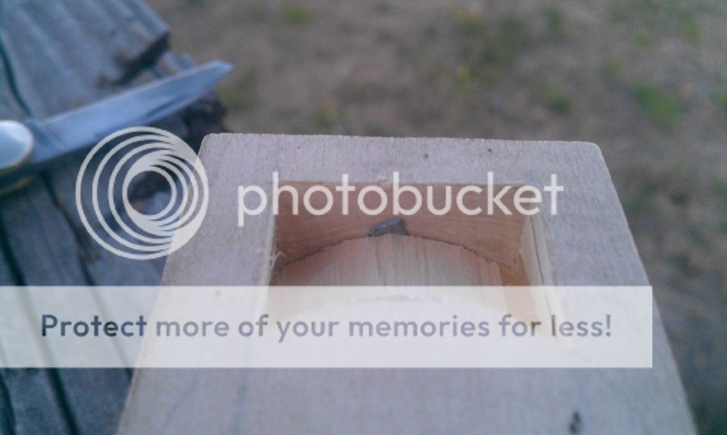

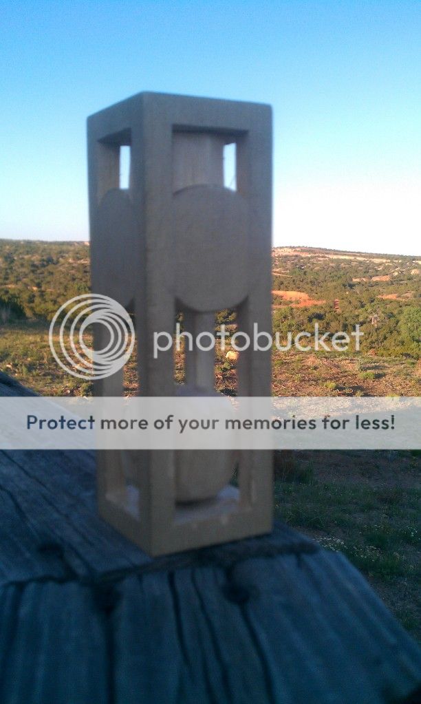

Now I'm really upset. I think I got a lemon. While I await a response from GEC, I figured I would continue work on my current project. Two balls in a box.

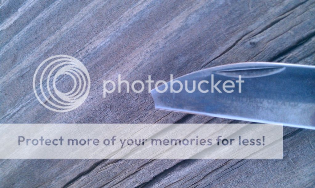

I have the first ball freed up and was working on getting the second free when, snap. The tip of the blade snapped off. I can't understand it. If I had been prying I could understand but snapping off while making a slicing cut? In 21 years of carrying and using knives, I have never broken a knife. I know there is nothing I can do, I'm just mad. I guess the pin problem is now a lost cause. I'm really dissappointed, I really liked this knife.
I'd definitely give GEC a call. The whole thing - pin and tip - should be covered under the warranty. You weren't abusing the knife, just using it as intended - whittling.

I guess I'll see how it goes calling them tomorrow. I would like to continue liking GEC and the 57. Like I said, I really like this knife. It seems to me like this blade might have just been too hard. If they respond with customer service that should come with a knife of this price, I will continue liking them both.
