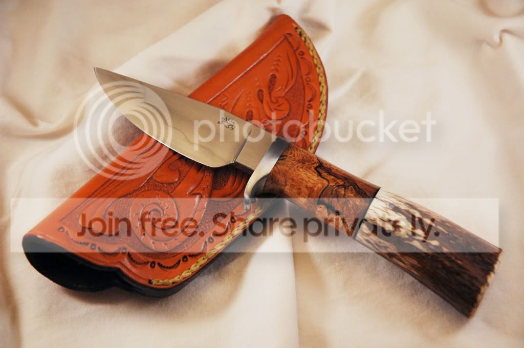

I use some burl oak that I cut some years back quite a bit for handles. Here's a pic if it works.

Andy is so right about quartersawn white oak. It's been used in many, many Arts and Crafts pieces of furniture and can be beautiful with ray fleck running across the grain.
I think flatsawn red oak has been given a bad rap because it's been done to death in mass produced furniture. Distressed like the one above is very cool for a certain look and I used to have some curly red oak that looked cool.
Not only is oak very open grained which can trap dirt and stuff, but it doesn't often have the detail we might like when used in such a small piece as a knife scale. Find one with tight grain and lots of figure and it might be a good candidate.
One last thing about oak that might be a turnoff is that water and steel and oak can create a black/blue stain that looks like someone spilled ink on your handle. Sealing the wood may make this a non-issue, but it's something to consider.
